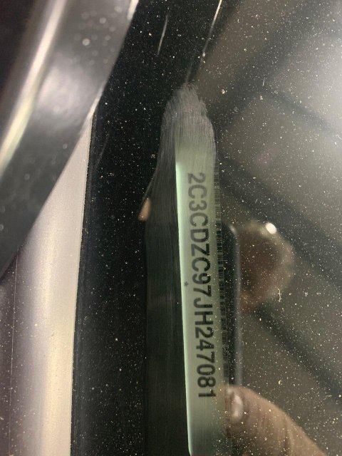

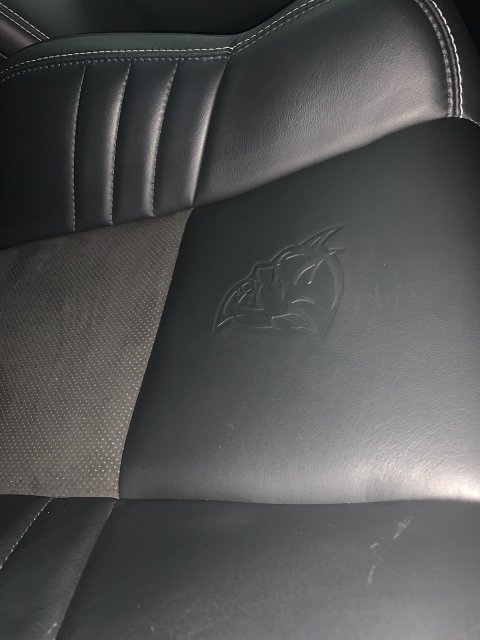

Sorry not 1366. Looking like someone went to extremes to convert a Hellcat to a Demon.
Demon head on the splash screen
white gauges vs red in the hellcats
demon head on seats/fender

The last 4 of the VIN will be 0001 - 3312

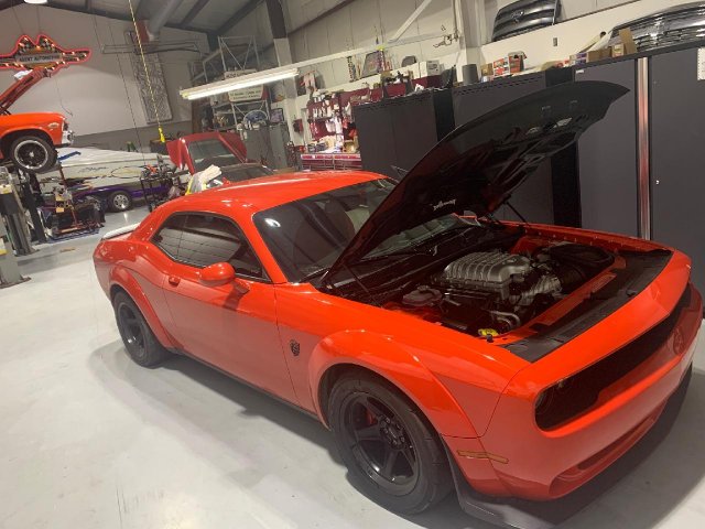

All visual queues lined up including dash showing Demon at key on. Those were the first things I had him check. Things went odd when he tried to get a part using the VIN.

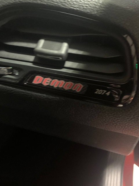

checking RS's master list on that other place: 2018-dodge-demon-production-information-updates for the two dash plaque #'s mentioned
1366 - F8 Green /// Laguna/Alcantara /// Black delivered to Tampa
2074 - Go Mango /// Laguna/Alcantara /// Black delivered to Marietta

Also using the list, 2782 is a VIN for B5 and Demonic Red interior. An illegal combination that was built. I believe there were 2 B5's done this way but thats the first one i pulled up when searching.

There should be a vin stamped in the left side shock tower frame roughly close to the power distribution box. Can't miss it unless they ground it off and repainted that area.
(*EDIT: corrected for clarity, left when looking at your motor, on the passenger side, but that's where the power distribution box is anyway)

As stated previously, every single visual queue is correct. Engine block, valve covers, demon SC cover, windshield burnout graphic, etc. The tag in the door seemed odd, and when he tried to order some parts the VIN didn't show up at the parts dept and the guy reached out to me to see what I could tell him.
