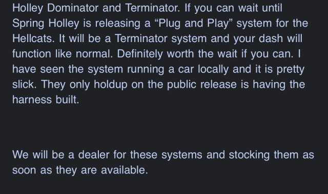

Yes the Terminator will work. Once you remove all the CM’s it’s just another engine. You need to go on the Holley site and read about the different systems. The difference is the number of input and outputs the ECU has. The Max for example compared to the base Terminator, can control a electronic throttle body where the base unit can’t. If you are going to run a cable TB then that doesn’t matter. If you run a Dominator, it won’t work a VVT cam. You’ll have to lock it. If you are going race car where you will be employing sensors and triggers for the dozens of things that drag cars use to get down the track, then the Dominator is worth the money. While the Dominator is a thousand times more capable, the Terminators will work. As I said before… our blue car is running the Terminator because when it was being switched from the Hellcrate ECU it was using, the Dominator was backordered with no availability date. That car is still using the Terminator and is making over 1400whp. Personally with what I see you are building… I would recommend the Dominator. Those things have forever value in the world of drag racing. You could run a Pro Mod with one. The lower models are just street stuff by comparison.
