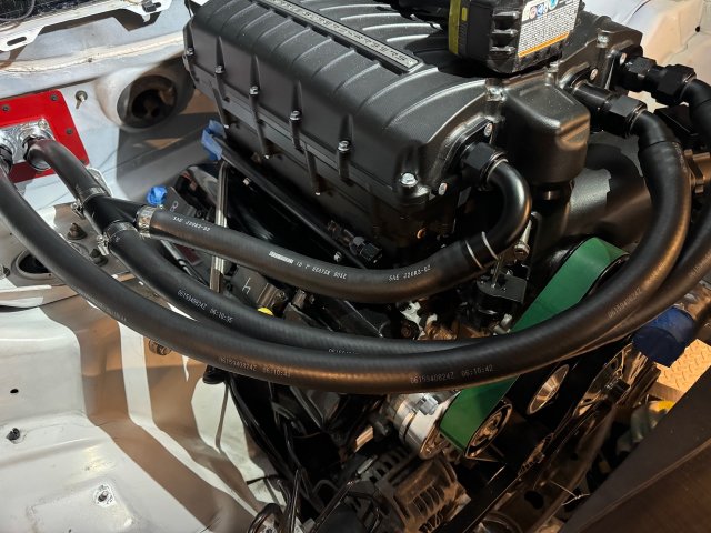

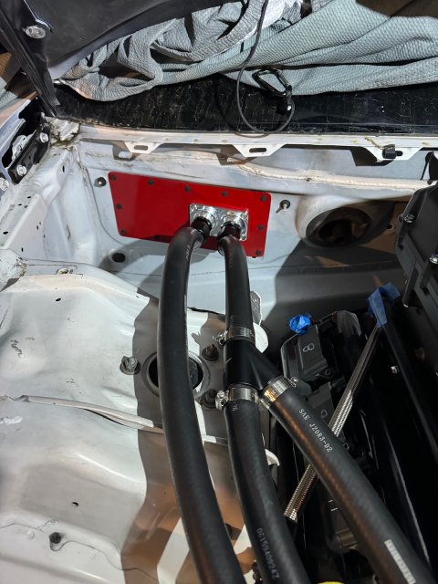

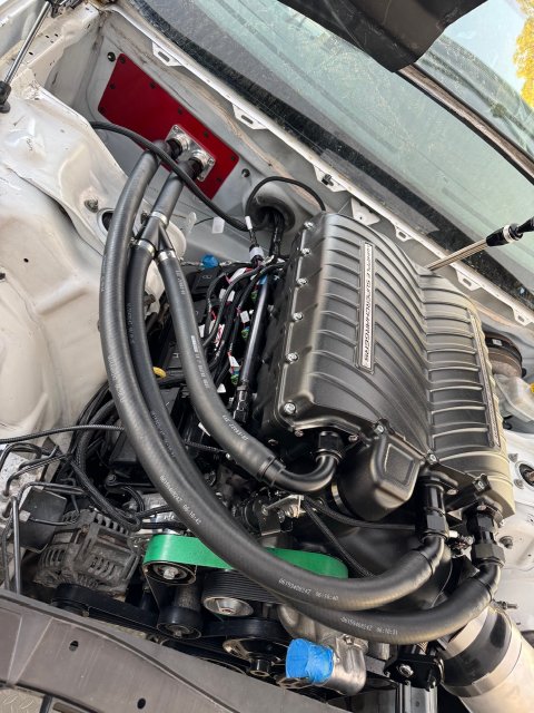

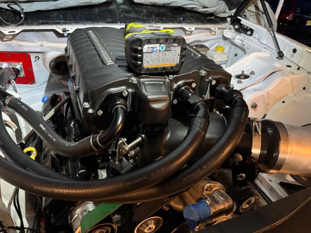

coolant lines run. Ill make a full video in daylight.

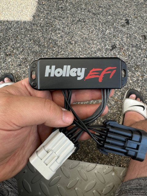

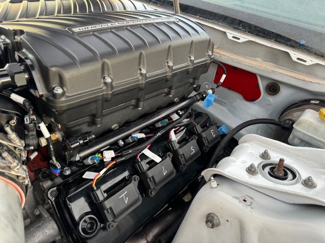

Holley stuff is in. Need to figure out a MAT sensor.
In this photo you can see the MAT sensor is right against the TPS, there is no way to get a sensor on there. I have an IAT sensor in the intake that could work but I'd rather not take the temp reading from there.
It's all downhill from here, switches, cage and then some tuning. Then a debut of sorts... I'm starting to get nervous as the momentum is building.
4,138
10,418
Thread Starter #426

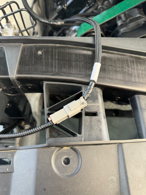

Sitting here trying to finger fuck dodge connectors and I had enough of the bullshit on the harness. Snip, snip, snip. Crimp, crimp, crimp.
MMX harness adapted to Holley EFI on the MAT PIGTAIL.
For now I am making use of the stock map sensors. 😎
