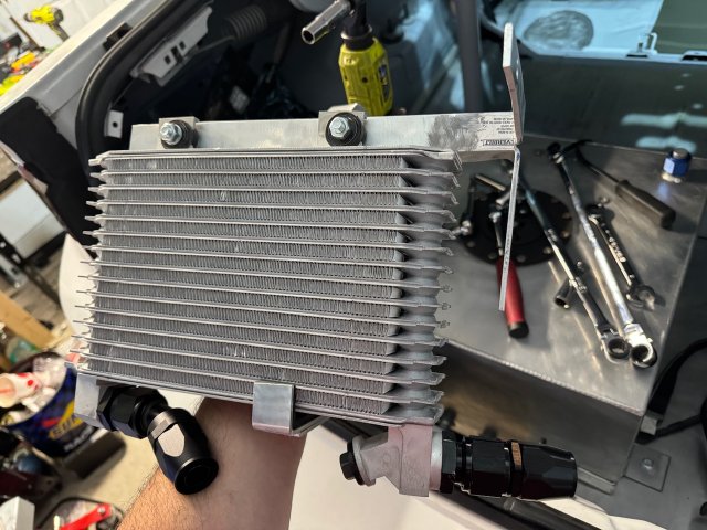

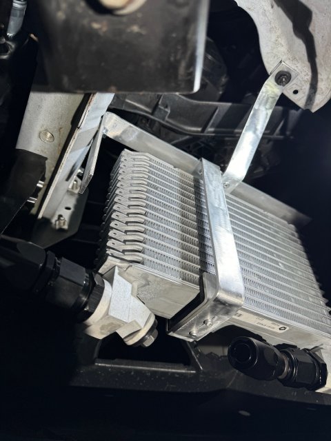

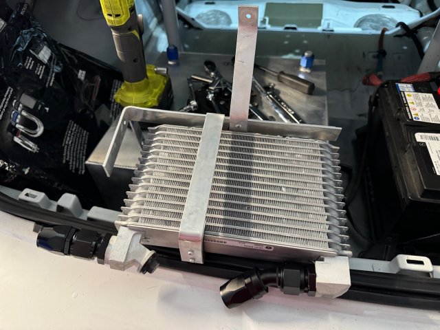

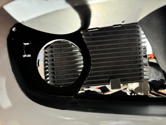

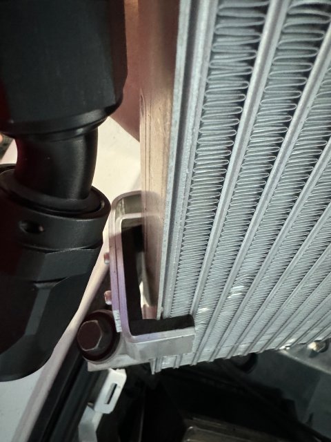

peekaboo oil cooler, i see you! Have to trim the bumper
IMG_3732.jpeg IMG_3730.jpeg IMG_3729.jpeg IMG_3728.jpeg IMG_3727.jpeg IMG_3726.jpeg IMG_3725.jpeg IMG_3724.jpeg
its pretty solid when bolted in. Does have some flex but thats how it be sometimes

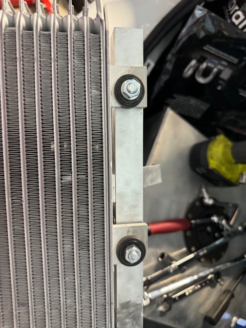

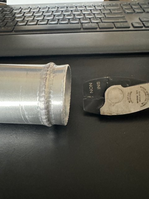

Lots of progress.

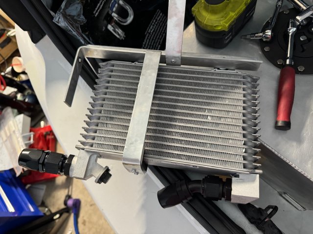

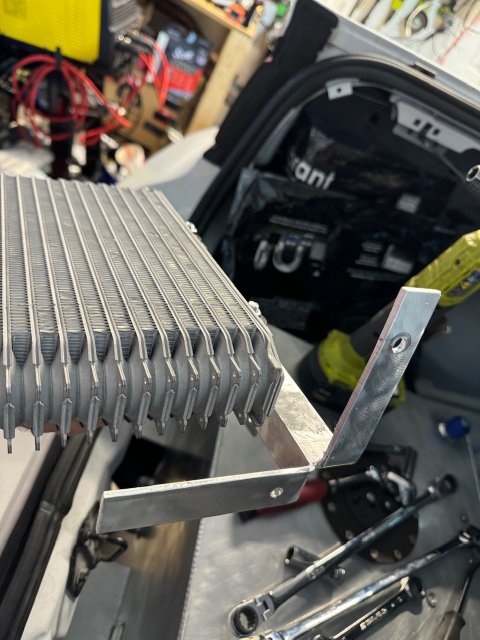

Had to seal trans cooler before starting engine, otherwise would spit fluid everywhere.
Transmission Cooler pt. 1
Transmission cooler pt. 2
8,762
7,687
Please make sure trans cooler lines are iron clad

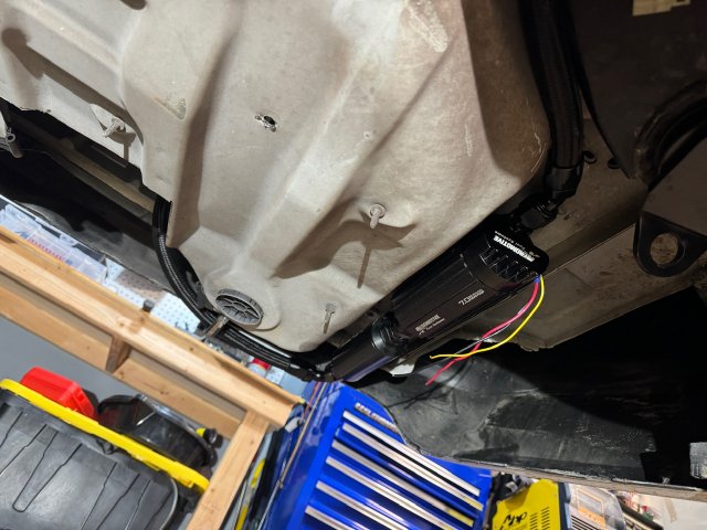

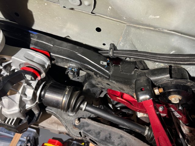

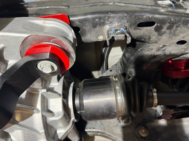

Thread Starter #549

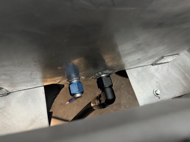

I could not find a better routing solution with a gravity fed pump. However, I will be building a shield around the pump as it is very close to the tire.
I have a video going up later today. @Marc W She is sitting pretty!
3,633
11,722
Good idea on the fuel pump shield. 👍🏼👍🏼
8,762
7,687

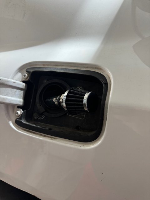

Is the vent going to be outside? Do you have a check valve in case the car flips?
4,138
10,416
Thread Starter #552
If the car flips i have bigger problems.
8,762
7,687
Read my mind lol and no bad ju-ju here was just wondering, thought check valve was mandatory for vent
8,762
7,687
Really looking forward to this man, wish I was up there we’d be best buds
4,138
10,416

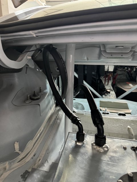

Thread Starter #555
No you’re right. Quick fix.

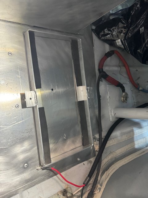

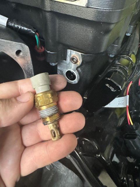

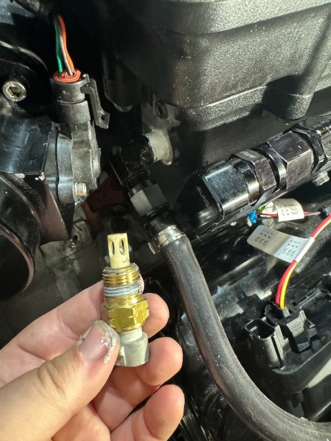

Removed this unusable sensor and added a vacuum line to the master cylinder IMG_3865.jpeg IMG_3867.jpeg
