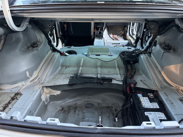

For what it is, it is extremely light.

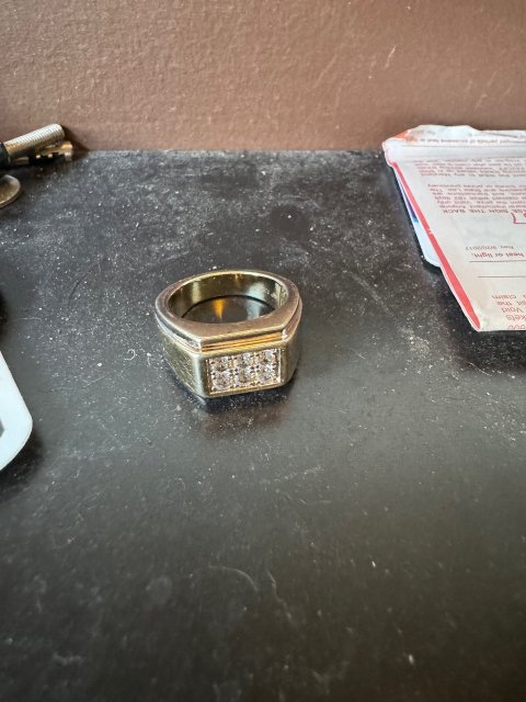

Found some very unsavory items, promptly poured gasoline into glass bowl, dropped item into bowl let it dissolve, tossed onto scrap wood and burnt it. Promptly ripped off gloves after washed hands and face and took a shower. Iykyk but maybe I should spray the car with narcan 😂

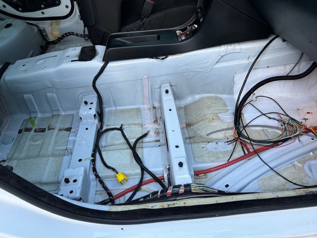

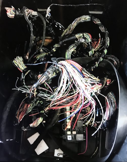

Some of the police wiring absolutely scares me. But this whole harness will be ripped out eventually. I’ll add lights to a relay board.

There’s manuals online for the upfitter wiring very thorough

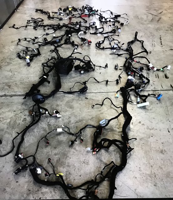

When those wiring harnesses look like this… you’re getting started 😬 3E00E49C-9B2B-4DF0-B0F4-3FA8B9618A10.jpeg FCFBBC4A-6FF0-4CC4-83D0-A5706C5733AE.jpeg

I’ve been through this before. It’s insane how many wire harnesses/“jumper” harnesses are in the car and how much they weigh
3,630
11,710
#68
My Challenger was 80 lbs.

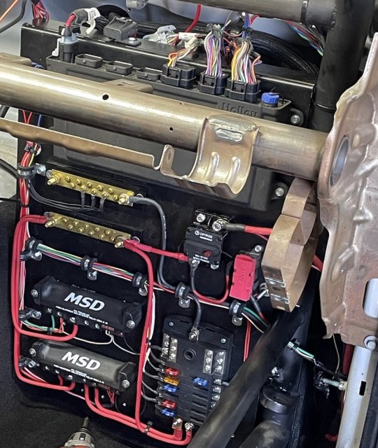

@Marc W None of the original wiring harness will be used. I'll keep some of it around for wires that I can re-use if they are the right length but I plan to use the terminator options or build a relay board. However I say this now but don't have the terminator x in front of me (max) so this is subject to change. What is pissing me off is that I plan to use 1700's but they are not in the drop down, ID provides data but Holley won't just add them to the list... FIC is in there.....

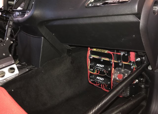

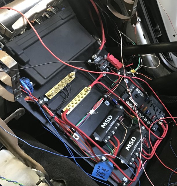

Your list of stuff all sounds good and I agree with everything you’ve got going on there. One thing to do with your harness when all that is being removed….. keep the connectors for what you’ll want to reuse for stuff like headlights and taillights. You don’t want to be trying to identify those when it’s all in a pile. Best to snip those wires leaving the connectors in place. The ECU and all of the relays and stuff are best placed together on a board where everything can be laid out and accessed. A couple pics of mine. All solid state and placed on the passenger side where the Holley harnesses can pass through the firewall in one place. We left enough length with the harnesses to disconnect the board and pull it back onto the floor to access the computer when necessary. 5C91893A-ED17-4D60-86D2-250E0F0BDEC9.jpeg E18B7FD1-75AA-403E-90AF-8A3894F1B274.jpeg 614C095F-9E2B-4DB8-9580-7698F16315DD.jpeg D138856B-3402-4F7D-A856-BBF1FA09543E.jpeg

@Marc W Goals! Lets see if I can get there.

Moisonite and gold plated, threw it in the fuck it bucket...
A Crackhead would of already hocked it if it was worth anything??

Man I need a new job lol. @Marc W your car is a work of art. So clean
Thank you. That’s the way we roll 😎. I could loose some weight ditching all that interior stuff but…. Fk it. We’ll just make more hp 😂
