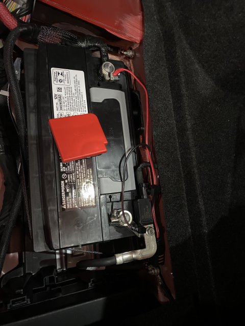

Yours would be bigger than mine 🤓, maybe Demon batteries are lighter then, still massively heavy.
You should post a picture of yours. I don't think the Demons were getting different batteries. Could the battery be different since it was shipped overseas?

Looks like the normal battery. Here is a video weighing the stock battery. Mine weighed 44 lbs also

weighed mine myself also,checked to see if our weights are the same which they are.I’ll weigh it again when my new lightweight arrives ,may video as well ?
