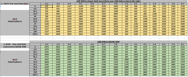

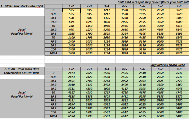

So some historical background, these were the shifts provided by a tuner that had me banging off the rev limiters hard in 1st, 2nd, etc...
These values as reported in a post that @Speedy! commented on showed that the TB was closing because I was hitting the rev limiter, hard. These are my current values:

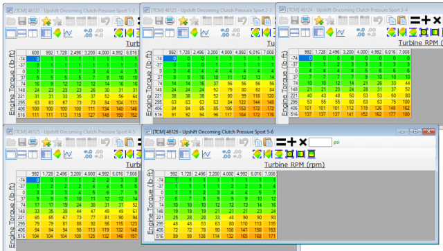

I don't have any test n' tunes coming up and I have the MHSH coming up soon. I did notice that the Tune that I flashed was sort of corrupted. It had values in them that I did not put in there. Don't know if it happened in the copy from my desktop to my car's laptop but from now on I've set the master to be the laptop and will only write tunes on that. While at the track I put the values above in the transTCM and went to get more data.
TCM RPM Limit: 7560
Max Torque Limit, Slip: 800ft-lbs
Oncomming clutch pressures:
If we are going to put this in context, please use run 6 for any exploration. That is the only run I can guarantee the values in the spreadsheet were actually in use.

Making an executive decision to revert my TCM tune to my stock Hellcat TCM. There are a lot of irregularities in the tune and I don't think for the health of my HP90 it would be prudent to keep running it. I will revert tomorrow and just drive around on the street to get a feel for stock. I plan to do a deep dive into shift pressures and upshift scheduling but for now I will just raise the shift points to something safe and see how must past this value they push through. If that push through is consisent based on the line pressure I will then make small incremental changes to get them to shift appropriately. Very disappointed that I paid for this and almost sent my trans to Direct Connection Heaven...

On mine I didn't mess with the clutch pressures. There's a different table for shift pressure.

Went with solid mounts as I had two sets of dodge urethane/hydraulic mounts leak. Hot shafted by dealership twice on it too! Working on the rev past 6500 part. Wasnt my doing, reverted TCM tune to stock and seeing where it shifts at playing with data to try and get it as close to possible to 6500 safe
Congrats on your PB's that's awesome. At one point you were shifting too high, did you lower it & where is your shifts at now ?
Shifting at 6850 again, car was hauling ass and did 9s. I reverted to stock tune. Right now my shifts are at 5663, 5878, 6001, 6050, 6100. Conservative but I’m testing so they will go higher as I figure out what it likes.

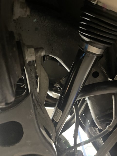

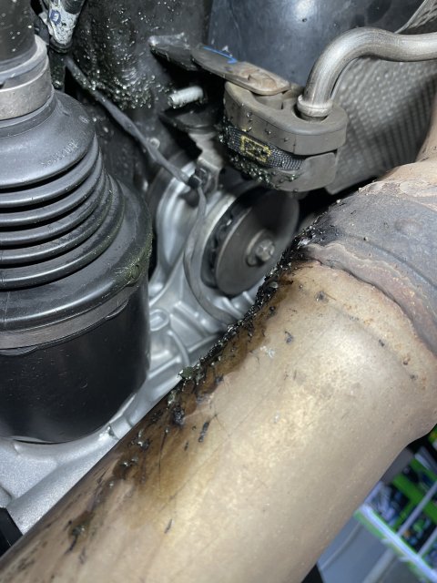

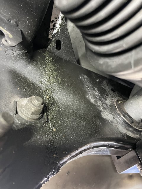

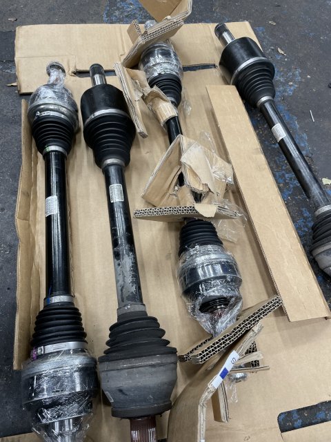

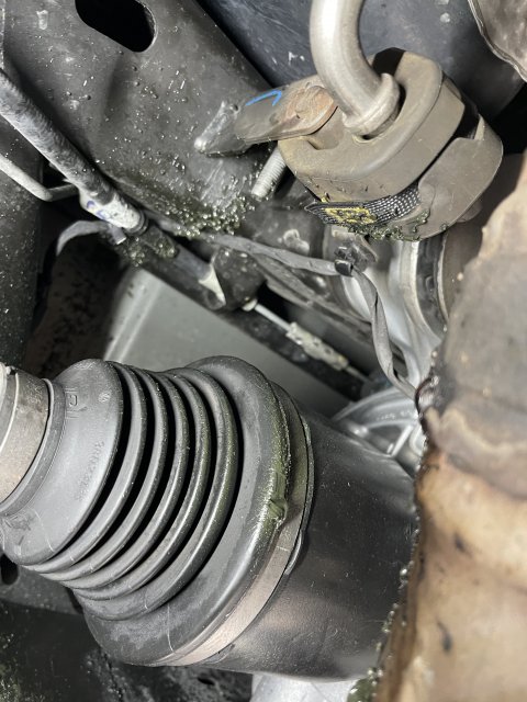

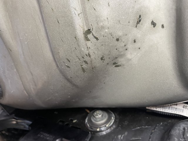

Axles finally went. Was getting major vibrations on the highway last night. During lunch got it up on the quickjacks and inspected. Good thing I have @16GoManGoHC2 redeye/demon axles. Trying to get lift time for tonight.

Ah on the axles . At least you an upgrade ready to go .

I know just trying to find lift time. Right before the mhsh, FML.

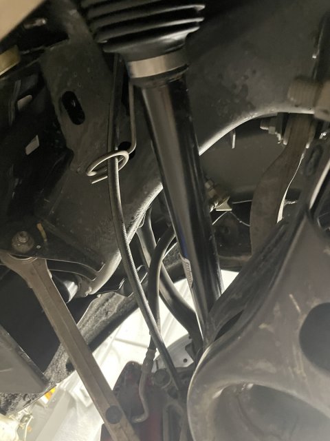

Surgery went well!
