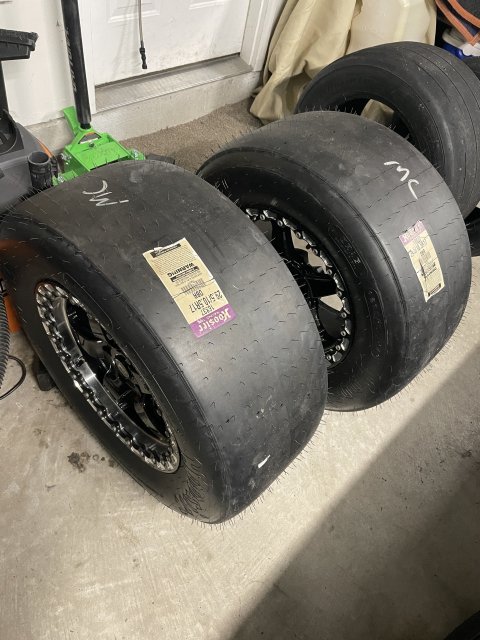

Big bishes on, she #thicc, happy to report longer studs and spacer doing their thing.
F4894513-9DE9-42E9-B91D-90FFDD4A35E3.jpeg 7A0E1C3F-D04E-401F-9683-FFCA636FDF8D.jpeg
Yepper,, all my flea on says had to have the longer studs.Youz know kinda like a snow stud not a run flat like in Tennessee. Soz, I brought em all down here with me. Kina like a condon mation.

The car is loving these injectors, I'm loving feeling competent enough to go in there and tweak. My review of the DBR's is still pending. Learned they behave more like a slick than a radial even though they have a radial compound. Also don't go below 18PSI otherwise they really behave like a slick. Was getting a little "jut" in the ass on the 1/8th cause they were spinning so fast they were folding over. Puckering moment for sure.

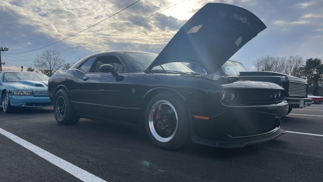

The taller tire for sure is doing that. One thing I may tweak is raising shift points. That MPH is going to get nuttier. Also she was a fat pig.

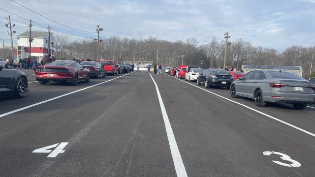

@fumanchu182 so was yesterday a planned day to race? I looked on their site schedule and it shows March 5th as 1st day
They decided on Monday to prep for the good weather. It was really a big turnout too, spoke with the owners and they said they wanted to do a soft launch to work out the new system.

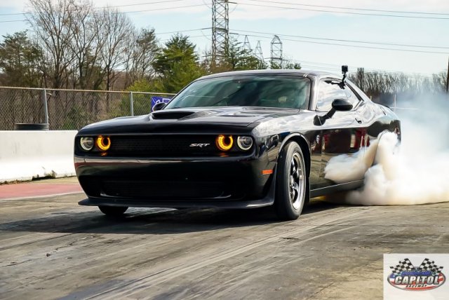

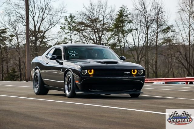

Track photographer went in!
