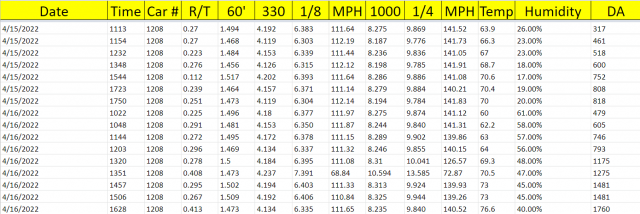

All righty, all the data from the event... The 60' is telling...

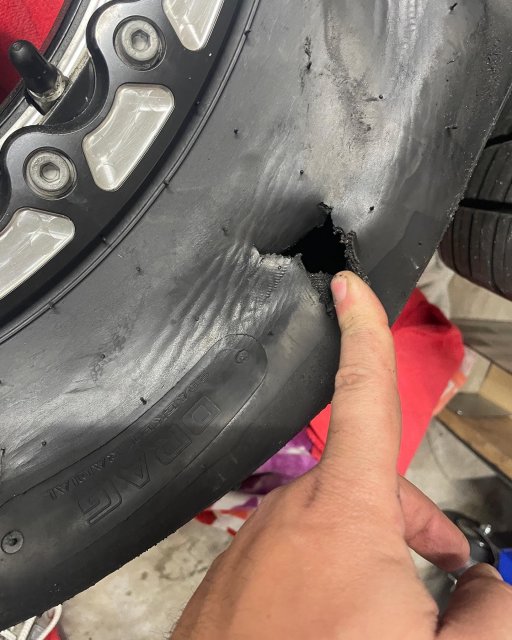

Today was just a very trying evening… should have stayed home…
At 3:45 locked myself out of my house.
4:30 got back in.
5:00 get on the road for the track.
Get to track. Make first pass. Timing equipment is off…
Make second pass, trans is at 260*
Adjust some things in the tune… HP tuners says temp is 186…
Make a couple of hits.
Final hit, car is just launching like a bat out of hell. However removing TCC lockup is causing issues. Will be adding it back into the tune. Too much heat.
Go to put air in rear left, valve stem is broke, nurse it home… and pray…
Ten miles from home, boom she goes…
A5A1ABB3-C95E-4D94-B0D5-699E754BD6F9.jpeg EB0FE6E3-08A6-4776-837F-309C5A61511C.jpeg
God wanted this tire dead, hit a large pothole and thats a wrap.
Get in friends car, get to house. Forget hellcat keys dont have house key, dont have garage opener… its in hellcat… drive back to hellcat, get opener, get to house pack streets in truck, a jack and some lug nuts…
forget the fucking impact at the house… use torque wrench as breaker bar… get street on rear left, get home, take dog to crackdonalds
get a coke with no ice, pour jameson in when i get home…
currently on couch sulking…
View attachment 68931 View attachment 68932

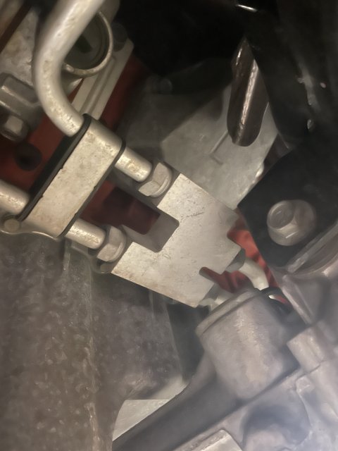

We believe it to be the tazer. Im sitting in stop and go gridlock after unplugging it and its cool.
AB2F67E4-B19F-42E7-9956-B81652B7F143.jpeg 672866CC-C93D-4A82-B7B8-E3B08FA2196A.jpeg BB03D6B5-8438-4E51-B8B1-E9C492001186.jpeg
