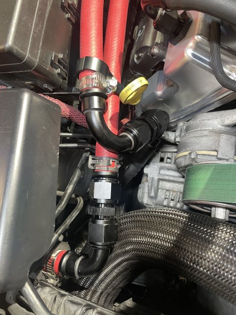

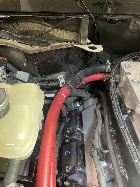

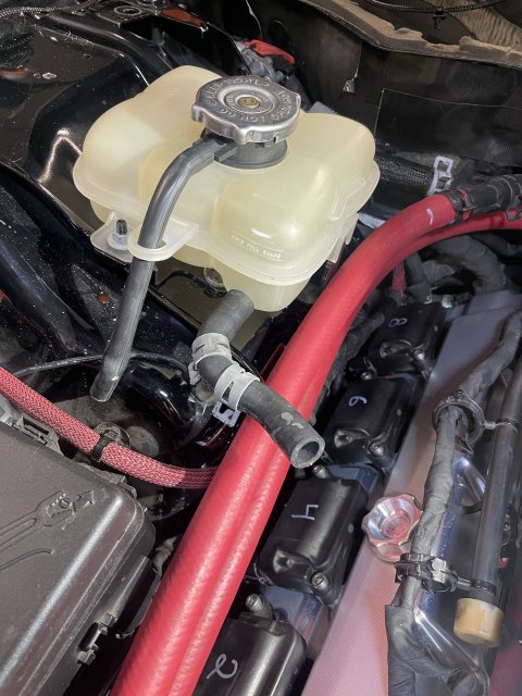

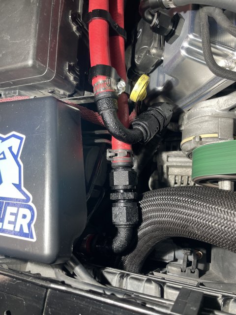

waiting on one brass fitting, might be able to start it tomorrow. Did a test. Can get to coils still no problem. If necess
5BA07D9B-80E5-4746-93D7-D49394F8BAE5.jpeg 0699A2CD-B8F8-4F61-93F1-B88F08E69134.jpeg 197E6F36-4DD0-4BF9-8766-DE9C1C6C6510.jpeg CBE067AA-FD70-4E00-8B3B-84F41D09EF8E.jpeg
working with Allpar and IC Chiller on something but thats 🤫

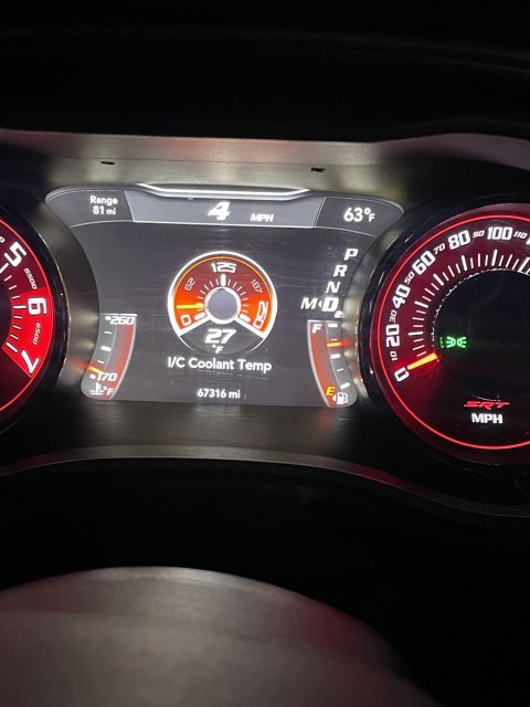

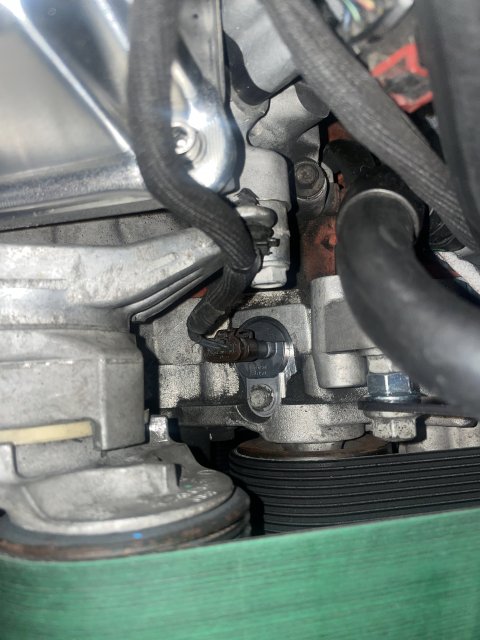

Cam position sensor might be leaking?

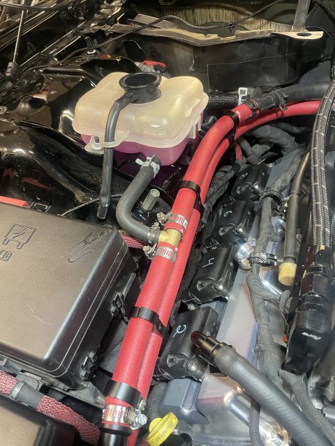

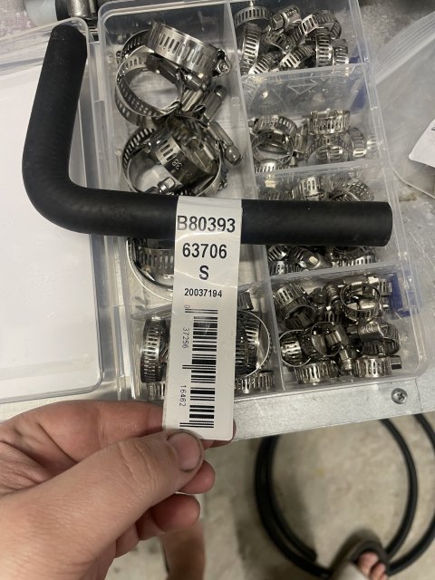

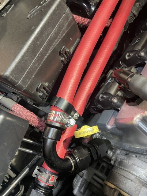

If you need to make an custom elbow this is the one I used 20C17495-AD59-4688-B67F-8073367B205B.jpeg
The IC chiller is doing its thing!

Ic chiller is doing its thing View attachment 98227
cleaned and replaced View attachment 98229
All the engine space! View attachment 98230
If you need to make an custom elbow this is the one I used View attachment 98231

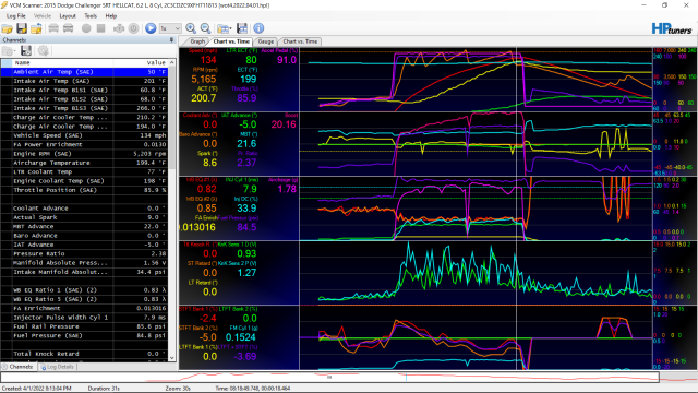

why doesn’t anyone show what the manifold air temps are that’s the only number that matters and pulls timing
8,733
7,666
Temp was really killing ke on my passes I was reaching 170 manifold air temp at the top end, was pulling 2 degrees of timing
4,128
10,384
Thread Starter #1,194
R

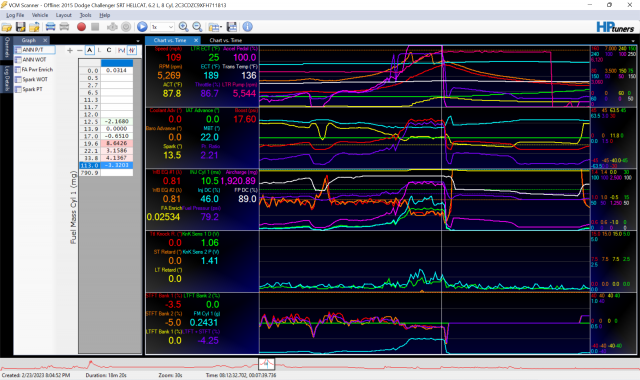

Not a problem broski. Start of pull: 62.6
End of pull: 87.8

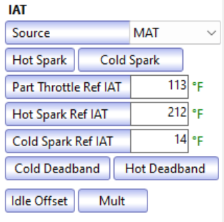

Keep in mind air charge temps start to pull timing based on the following values in the tune:
You could move Part Throttle Ref IAT to 999 and it would never pull timing...
8,733
7,666
8,733
7,666
Idk 170 is hot man that’s just asking for trouble, I need to get it down but wanted to see the true benefits of the cooler. Heck if they kept em below 140 on the top end would still be well worth it
