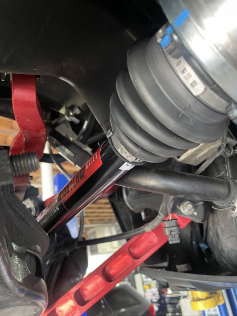

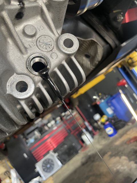

Was putting axles in, decided to service diff as well. Car feels way different in a good way. Drivers side axle was showing wear and tear.

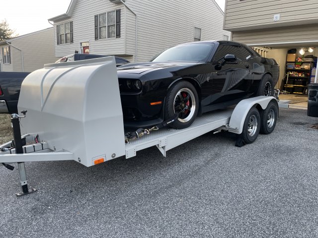

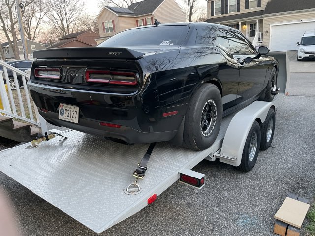

then to my delight learned the trailer would clear the driveway slope due to it being flat. I thinking I could get used to this bougie life!
66403363-796F-45B8-BA91-BF446A5A4585.jpeg EAA5FE60-F640-44EF-8FEC-3C4DE2E361AA.jpeg
View attachment 100894 View attachment 100895
View attachment 100896 View attachment 100897
Nice! Looking good on the trailer! Get used to your garage smelling like gear oil for a month lol
4,142
10,427
Thread Starter #1,345
LOL, I learned that lesson already, I went to my friends shop and borrowed his lift.
8,762
7,687
I just brought my drain pan back inside been sitting in the yard for few weeks airing out after brake clean and degreaser lol. Worst smelling stuff ever. Changed it a few months ago and then topped it off again a little while back

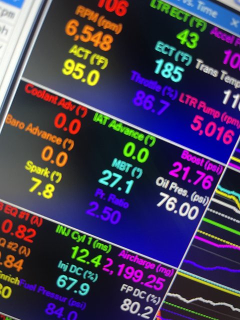

Not a problem broski. Start of pull: 62.6
End of pull: 87.8
Keep in mind air charge temps start to pull timing based on the following values in the tune:
You could move Part Throttle Ref IAT to 999 and it would never pull timing...
Didn’t you upgrade to triple pumps? Pump DC 89%, FP 79/80 psi, Or is that how it works on the control setup you’re using?
This is how it is, pump 1 is going hard but the computer don't know about 2/3
