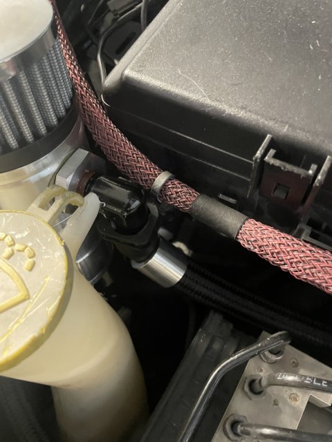

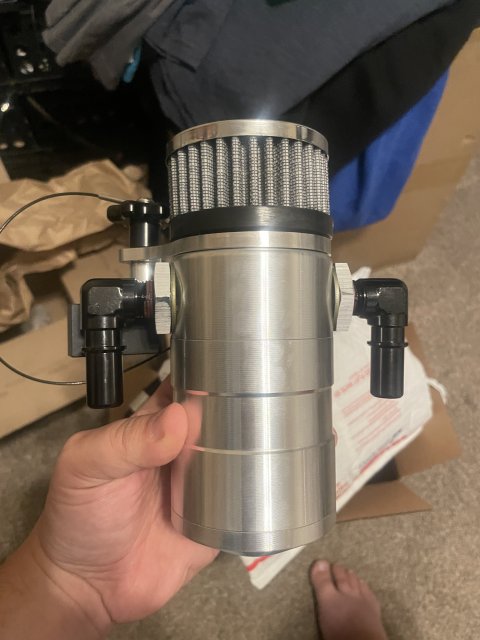

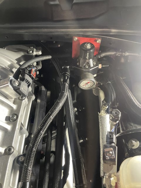

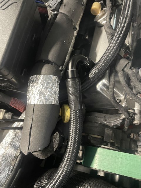

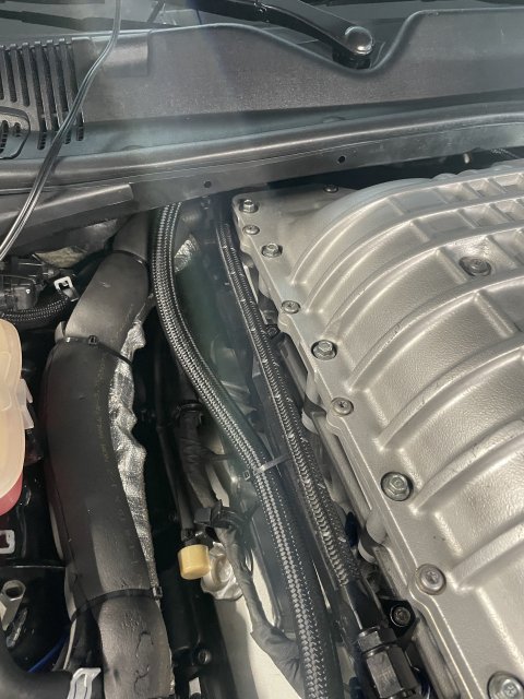

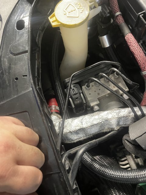

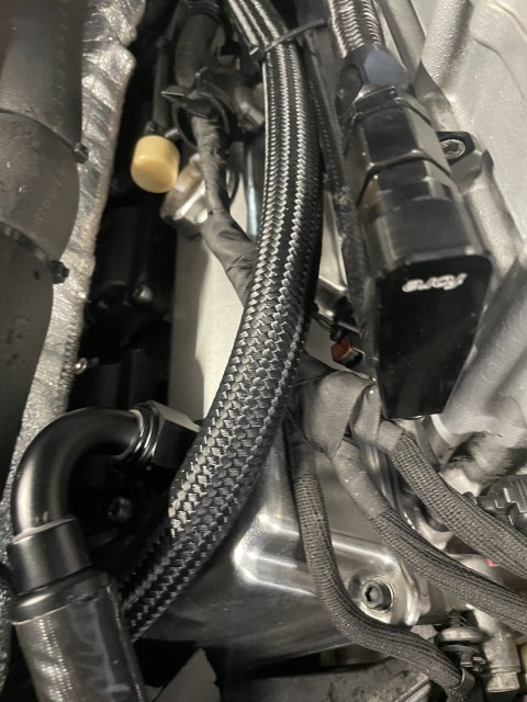

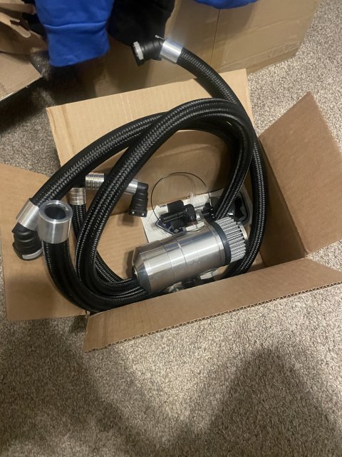

The kit is actually pretty nice. I sourced my own AN fittings for the 5/8” lines for the Hellcovers
IMG_8606.jpeg IMG_8607.jpeg IMG_8609.jpeg IMG_8610.jpeg IMG_8611.jpeg IMG_8612.jpeg IMG_8613.jpeg IMG_8614.jpeg IMG_8615.jpeg IMG_8616.jpeg

I should have went with that, but didn’t know what I needed to turn off
Neither do I, no codes have popped, yet, I'm sure I have pending.

Oh you fancy with the polished one!!! been running it for a few weeks, no codes.
🤣 on the whipple setup where does that PCV harness plug into?
RGPIII
#983
1,117
2,094
Bridgeville
same as factory, right in the intake tube.
