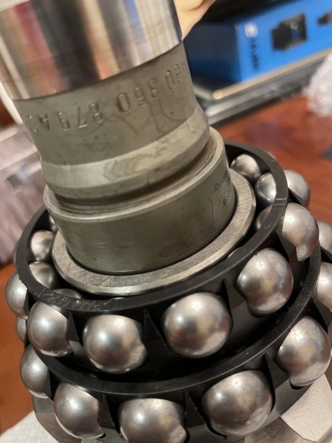

Okay so there is a 100% all stop to this. By removing the pinion I lost all references needed for re-assembly. In addition to this ZF does not publish the pre-load needed so that the crush sleeve can be correctly set. Also a crush sleeve like a axle/pinion seal is one time use only. Re-using it again and you run the risk of crushing the bearing in the race. No thanks.
ZF nor dodge sell crush sleeves as from what I can see on store.mopar.com. I have two options. Use another differential that is brand new, drain, pull the entire center section out, remove ring, go to town.

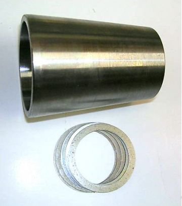

The pinion crush sleeve was the weak point of the 8 3/4 back in the day. I remember someone made a kit with a solid bushing and shims. maybe something like this can be made.I can check bearing preload as I have a 3.09 and a 2.62 spare. It will be late tomorrow though.

I think I used the one from mancini racing back then Looks like this

So I am once again in believe that dodge/zf engineered these to be non replaceable. the shaft has a taper and then at the bottom of the taper an 1/8th of an inch is machined out so you cannot place shims at the bottom and is required for a kit like that.
if you were to make a crush sleve eliminator then it would have to be machined in such a way that the bottom would fit at the taper and then the top hole machined to the rest of the shaft

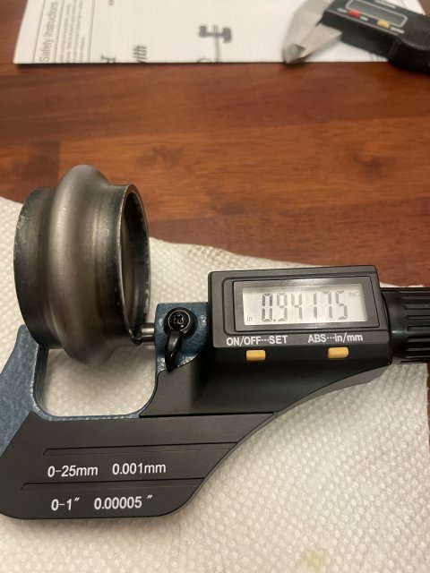

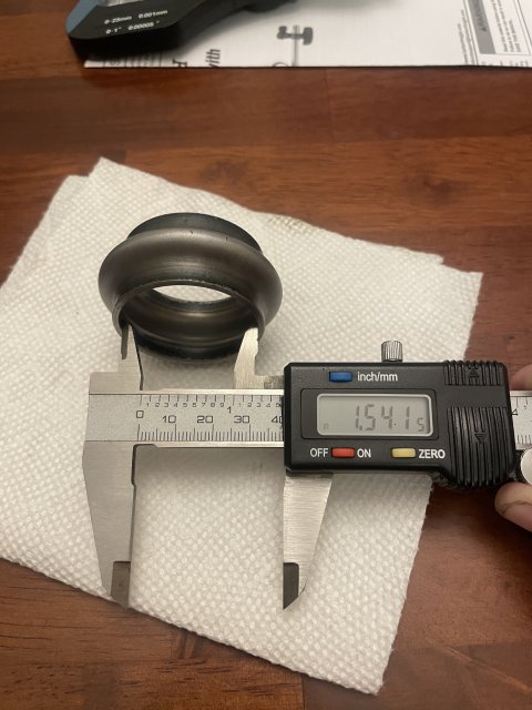

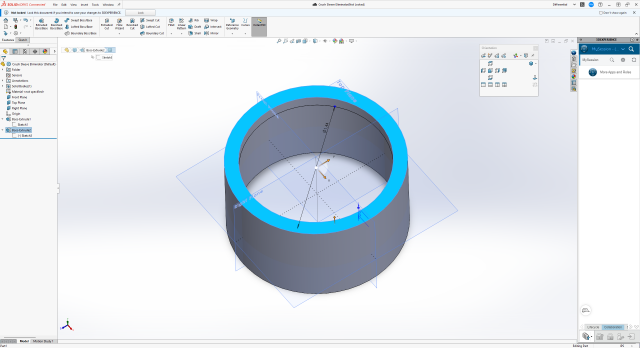

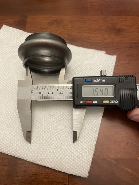

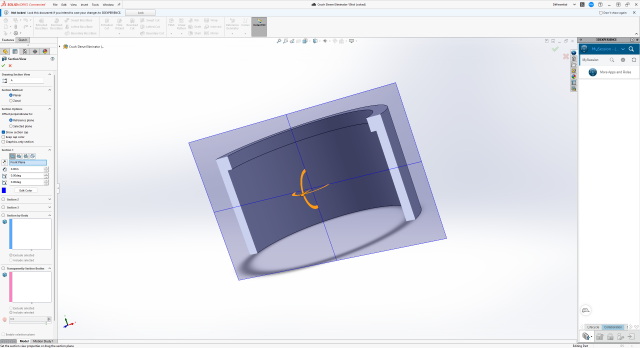

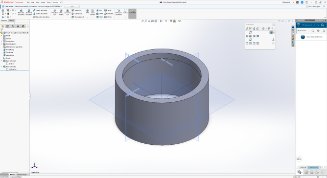

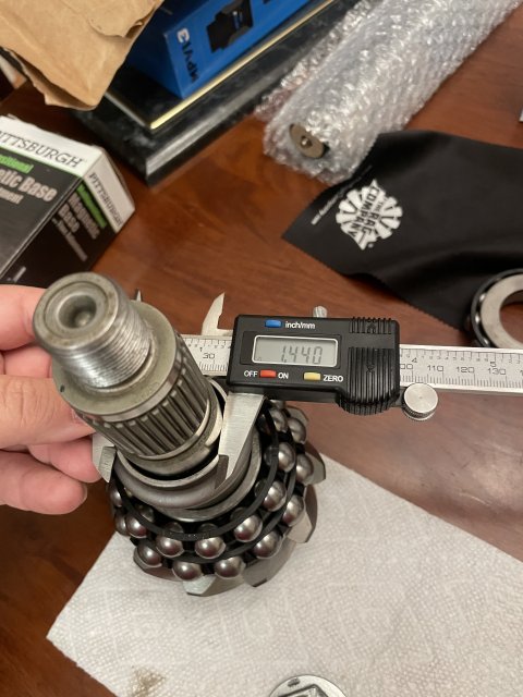

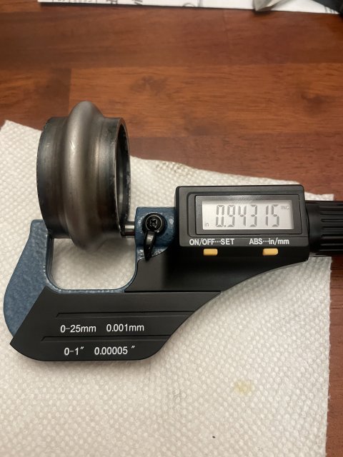

@Unholy707 and I have been talking about CAD work and I'm like I'm such a goonie right now. Fired up solidworks:

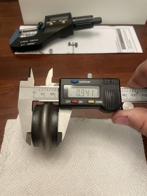

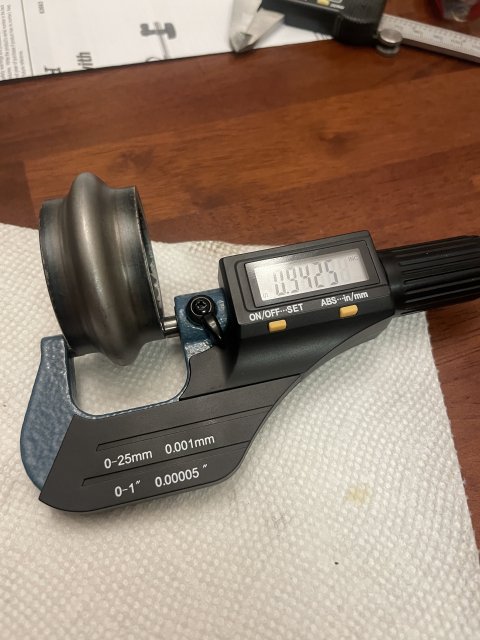

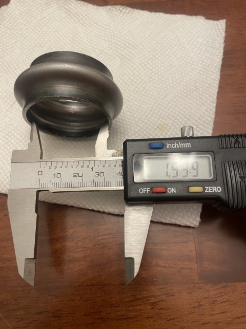

Top of shim has 1.440 ID
Bottom of shim has 1.54ID. Whole body has 1.71OD.
Shelf for shims to rest against is 1/8" thick. Tolerances were left a little loos by .001 for fluid
I went with a overall height of .942" as that seems to be the middle of the road. Shims would be custom sourced to match the shelf ID/OD (37mm id, 44mm). Just in case shims would be in a five pack: 5 * .001 = 0.005 of play. I thought about ten thou: .0001 for play but that is ridiculous. This is not really that precise in nature and a guesstimate at best. Thoughts? Going to contact the local makerspace tomorrow to see if someone can rough it out if I got pick up some stock at the metal supply place.
4,138
10,418

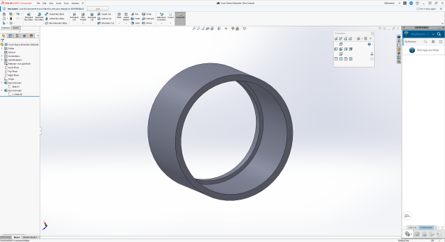

Thread Starter #1,833
Visualizing the shelf. Good fight, good night. Also asked on the MSHS group on FB if anyone else has done this before I re-invent the wheel...
