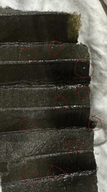

I'm surprised there was no wear material from a brand new engine. I thought that was a pretty standard and normal thing.
The oil analysis from my Mopar crate long block Demon/Redeye motor had wear metals in copper and iron. I had probably done 2 or 3 oil changes by 10,000 miles on the motor and had the analysis done. I think it was like 170ppm of copper and 37ppm of iron. The next analysis 4,000 miles later both values had dropped considerably.
It self clearances.
I agree, I was very shocked when I got it apart. I am going to pour the oil through a strainer today and see if there is anything that I didn't see in it. also going to take a few more white clean rags and go over the filter material and see if I get anything. all in all I'm very pleased with the Engine, heads, cam. ready to start dialing in some power with Sumit.
8,586
7,553
reflections from the light- nothing in the filter media. I went all through it.
