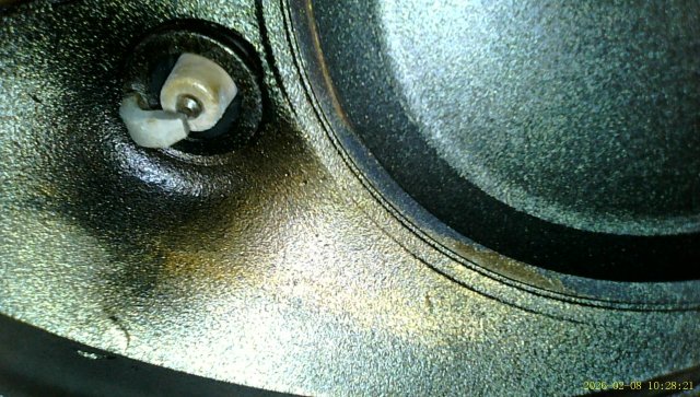

#7, easy peasy, 5 minutes to get them 2 out.

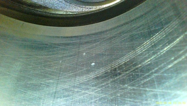

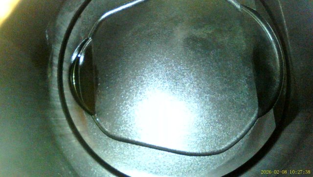

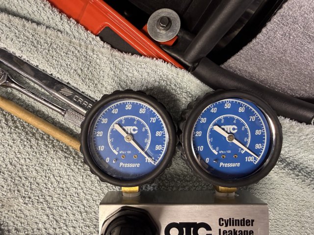

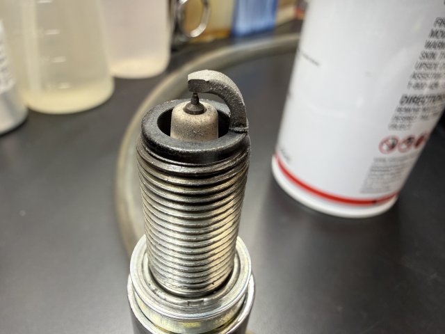

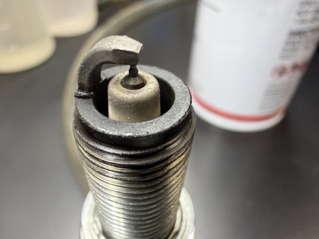

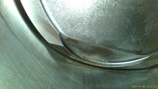

And #7 has been one of the ones with the highest failure rates. I just checked mine, was only going to look at number seven, which turned into looking at them and then doing a leak down test and then it turned into well, I might as well do 5, and then 3, and then 1, and they were all perfect and I was going to be happy with that but unfortunately, I had to do the other side as well because I had to know lol. Number eight was a real bastard, getting the coil power plugs off is the biggest PITA in my opinion at least.
7000 miles on these plugs on corn, the dust on them is from my last Whipple (warranty replacement #6 Whipple) that dusted my engine with aluminum, that was my last Whipple!!

Leak down results? Good?
Yes, 2-3% max each cylinder. That’s pretty good cold siting for 2 months with big .028” ring gaps. I get very little blow by hot. A stick pretty new HC or RE engine is like 1% because rings gaps are tight, like .014”-.018”, which is good stock but also bad as if you start upping the HP, more boost etc, on them means more heat means more thermal expansion which with tight ring gaps means more chance of ring butting which can be disastrous quick. There’s an old saying that nobody knows when your ring gaps are on the large side, but everyone ends up knowing when they’re too small lol BOOM!! If I ever do another build or engine refresh I’m probably going to use a gapless gas ported top ring. When I did my engine, total seal did not recommend it but a year after my build they do, go figure lol
