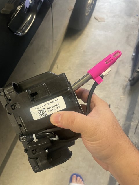

shifter was put in, code didnt go away, car goes into limp
i have a hp90 tcm but getting on mikes schedule has been hard, everyone is getting ready for MIR and the mhsh so they have been taking up his time, sadly my car is not a priority
