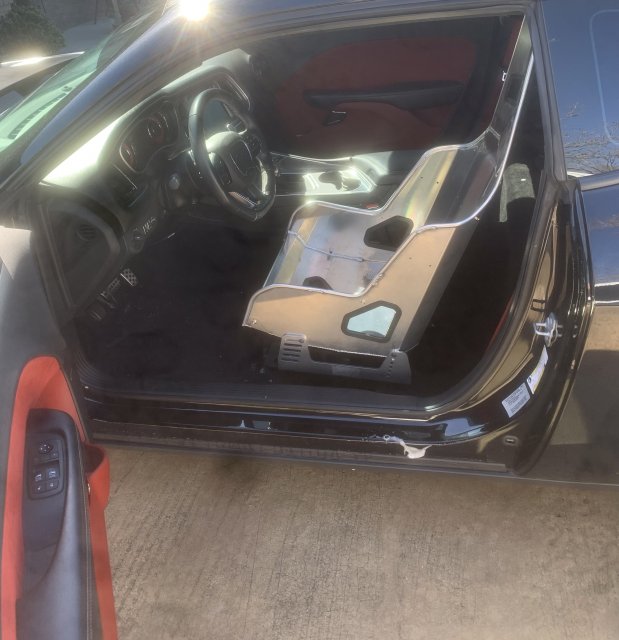

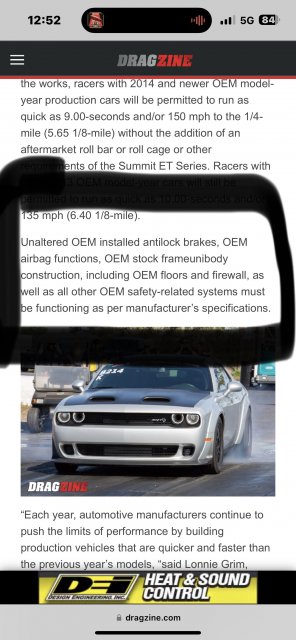

People also need to read the cage rule jon brought this up.
8.99 and/or 150mph a cage is needed
add taking out seats you are removing air bags need cage
light weight brakes are not factory need cage
15 inch rears need cage
There never was anything on brakes unless something changed. So you are not removing a safety devise being it still has brakes. I always that it was strange you can have drum brakes and go 150mph:unsure:

Also cars were sold without passenger seats
It still will have antilock brakes so they would be unaltered in their function
Smaller lighter brakes are not factory.
cars without pass seat still has working Air bags in drivers seat. When you remove drivers seat or pass seat with cars that have two seats you changed safety system

Some cars were sold with no passenger seat so that is a grey area. If you are not disconnect the airbag it is still there
59,723
207,979
Another grey area on brakes cause I read it as the antilock function needs to work
The air bags do not work when you move the passenger seat. You have to buy a plug to make them work.
59,723
207,979
If no one is in the passenger seat do that side even go off in an accident? I was thinking on the plug, Ron sells those
20,159
So removal wo the plug disables the entire system? Thats good to know.
