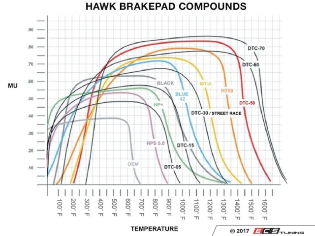

Brake Pads
Hawk DTC-70
  • Type: Motorsport-grade race pad
  • Material: High-performance race compound
  • Friction Coefficient (μ): 0.80 ~ 0.90
  • Operating Temperature Range: 400°F to 1,600°F (204°C to 871°C)
  • Optimal Temperature Range: 800°F to 1,200°F (427°C to 649°C)
  • Torque: Extremely high
  • Initial Bite: Aggressive and controllable
  • Modulation & Release: Superior

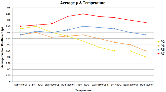

Paragon PBP690T6-15 R7
  • Type: Advanced high-speed track/competition pad
  • Material: Metallic
  • Friction Coefficient (μ): 0.48 ~ 0.53
  • Operating Temperature Range: 212°F to 1,562°F (100°C to 850°C)
  • Recommended Use: Advanced high-speed track events, competitions, and heavier cars requiring maximum braking performance

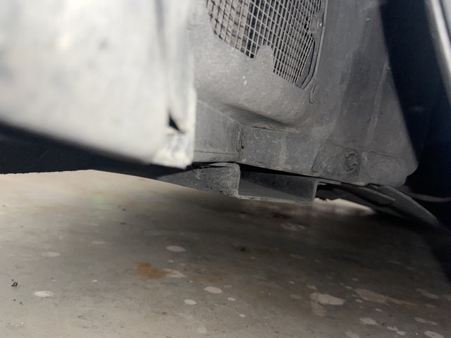

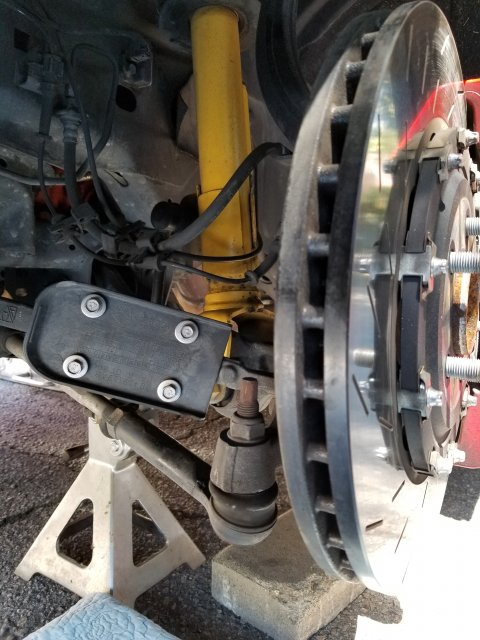

Paragon could perform similarly to GiroDisc/Demon Performance. Maybe benefit/tradeoff is Paragons are 2lbs heavier, indicating more material/heat capacity. Would need to test.

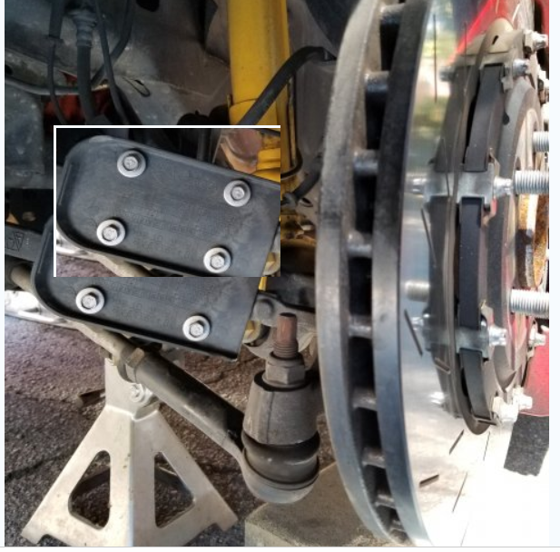

Thoughts on directing cool air to the rotors aside from the updated belly pan with brake ducts and additional air deflectors?
Could double the size of the current brake deflector by overlapping with another kit.
Or attach brake duct to the current brake deflector from the underbelly duct:
Perhaps adding something fabricated like a dust shield with brake duct tube (visual reference below) and attaching it to the caliper bolts (red). The areas in blue used to be the dust shield mounting points for the older SRTs with smaller rotors.
Mine is a 2016 but I added the underbody ducts and the control arm deflectors as you show. I made the deflectors at least twice as large with some sheet metal that I shaped to bring more air in. They are attached with the deflector screws.
I have struggled how to get more air in there. I have leaned towards some 12V duct fans and have them on the shelf if I get driven to experiment, but even routing and attaching a reasonable hose and tube to direct air at the center of the rotor has stumped me. I'm no fabricator.

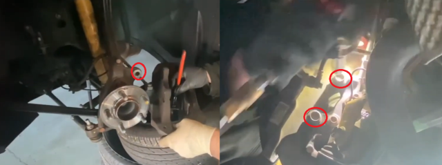

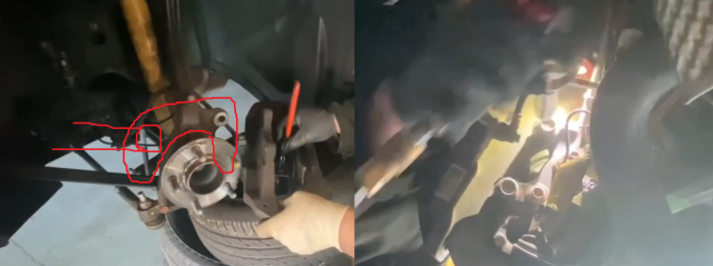

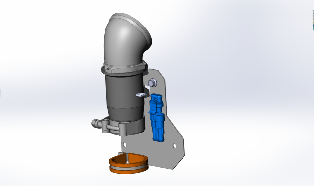

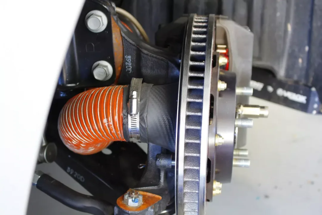

My main road block is how to mount a duct and direct it to the center of the rotor.
Onur Can made something for his Charger but it went to the rotor surface. Not a show stopper but not as efficient.
This approach has a rigid SS center duct piece nested inside the rotor that has a 2in flexible duct, routed directly to the I.D. of the rotor vanes. All airflow is directed through the rotor, not just at it.
This would mount under the 2 (of 3) hub bearing bolts. (We discussed the downsides of this once before )
Their heads could/would be cross drilled for safety wire.
The subassy above mounts to the inner surface of the well, somewhat behind the strut, so its intake is facing up to the top of the wheel well, 2in flexible duct between the fan and rigid portion.
