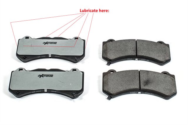

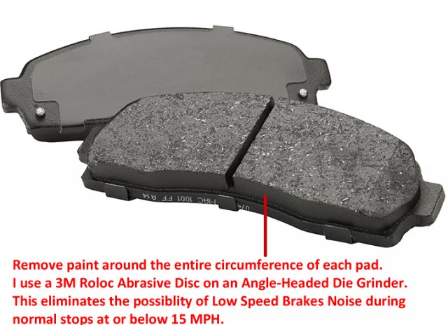

All you need to do to stop the brake squeal is remove the pads, whiz off the paint per the pic, lube with a high-temp silicone brake lube and reinstall. You do not need any other "Anti-Squeal" stuff.

You don't need this stuff. All you need to do is removed the paint from the sides of all friction pucks. See my other post.

Here is the Technical Explanation why the paint should be removed from the sides of Friction Pucks:
Brake heat softens the paint and it balls up, rolls onto the brake pad. The sticky, soft paint causes the brake pad to "chatter" on the rotor instead of sliding. We hear that "chatter" as a high frequency brake noise. Most of the time, this noise usually occurs at or near the end of a normal stop at or below 15 MPH. Increasing brake pedal pressure may help attenuate the brake noise which can be a diagnosis confirmation of this issue. To prevent any and all of this brake noise, just whiz the paint off the friction puck and lube with a good, high quality silicone brake lube. You can remove the paint prior to initial pad install or you can perform this procedure to existing pads and then reinstall. If existing pads, also whiz the surface of the pad off as well to removed any imbedded paint (you can't see).

Aggressive stops do not work long term. The only long term fix is whizzing off the paint.
Manufacturers paint to prevent the steel plate from rusting & most refuse to use an anodized plate due to costs so they paint. And then there are the very stubborn Product Manager that just won't listen to proven data because of product costs. So, our only option is to whiz the paint off and it is 100% effective.
