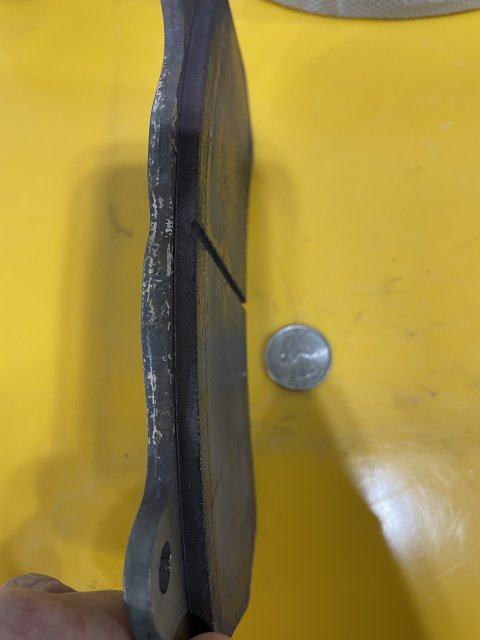

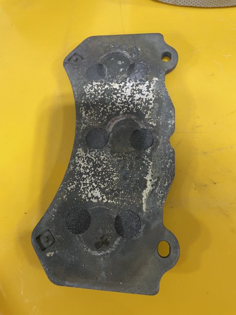

One of my front DTC-70’s
One day BIR
Flip - little day at local track
Then; One day RA
I never find any paint on my pad backing plates, only flakes and some larger areas that just peel away.
These wore real well, they have some life remaining. Like TD these will go into a box of used. I did put a set of one day at BIR fronts for this past Sunday at RA also. That was such a short and wet day, they will survive for one more day somewhere.
