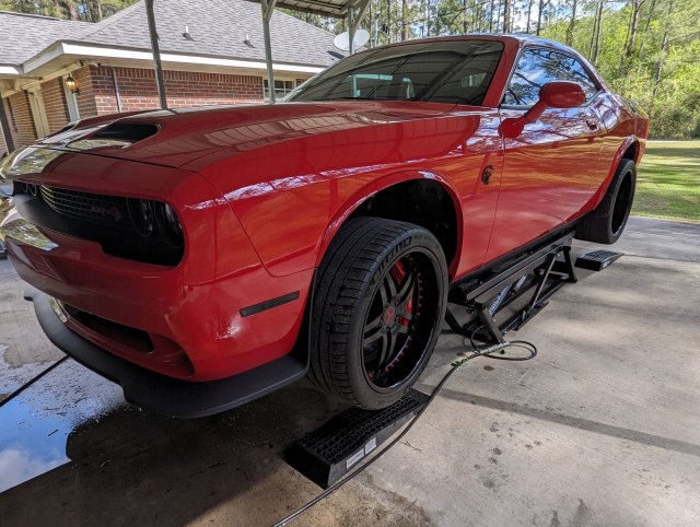

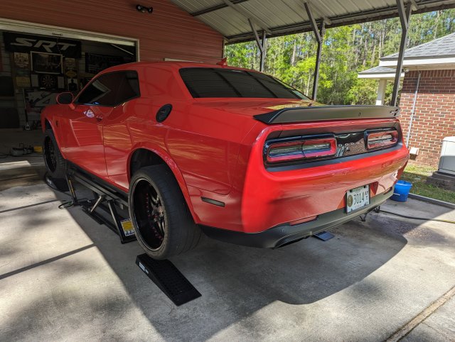

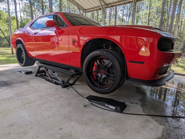

Worth it!
Although the older I get, the heavier they are.
My car has Mopar lowering springs, so I had to get ramps that the lowered car could drive up on, to be able to slide the quick jacks under.
PXL_20240330_161501715.jpg PXL_20240330_154942135.jpg PXL_20240330_154953081.jpg

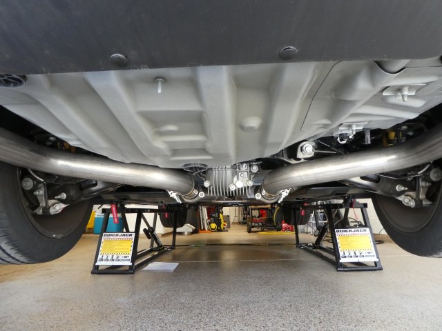

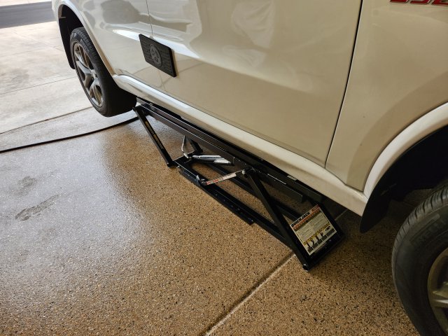

I have owned two - started off with the 5k model - it lifts the cars just fine. When I got the Durango, I was hoping to be able lift it too with the 5k, but was a no-go, so I sold it to a family member and then bought the 7k model, which will lift the Durango, but I have not tried to lift the cars with it yet (I'm hoping I won't have clearance issues, because it is slightly "thicker"/taller at rest). All in all, I would say they are pretty good for what they are and their usefulness when a full-size lift is not in the cards.
And yes, just as Hunter said, they seems to get a little heavier with each use LOL, but technically, are portable, which may be important to some. They are pretty quick and easy to setup, just a little back-and-forth checking at all 4 corners when lifting to make sure the frames are straight and parallel, and the touch points are good, etc.
Durango on the 7k:
Chally on the 5k:
