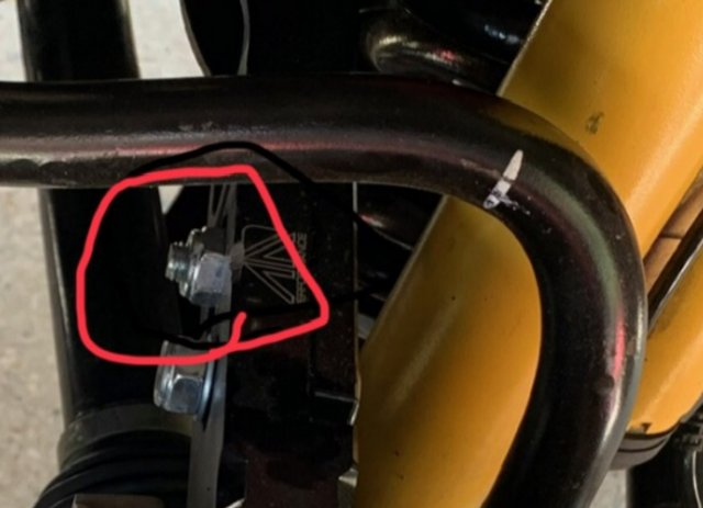

So... @DGatzby discovered that the Razor's edge/StolenLogix billet rear links pull the bar down so far it hits the AAD upper arm on full compression.

EDIT: @NJ_Redeye has posted pictures verifying interference with the AAD arms when using the HHP shortened stock end links. See below.

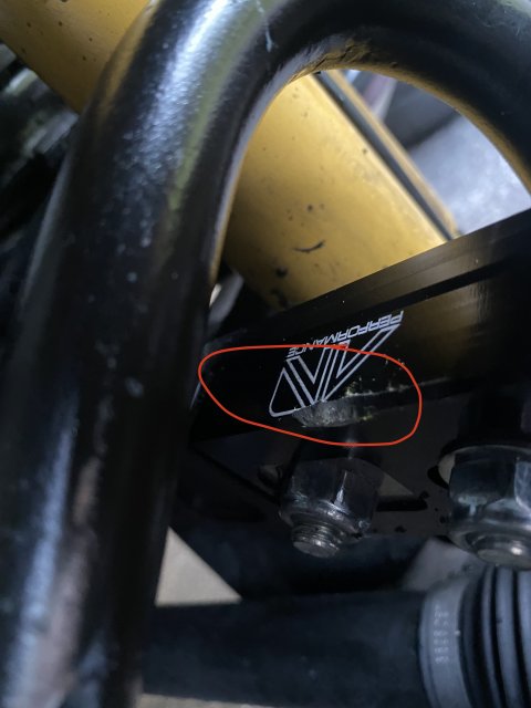

+++++EDIT--I have been at the track, and also a few road trips with the family, IS interference see pics Thanks @DGatzby . I havent done any road racing (yet, but NJMP is close to me, and I am going to try)

Ouch. That's rough and the one looks worse than @DGatzby even though the HHP links should be longer than the StolenLogix pieces he had.
It really isnt looking good for options at this point.
Some of the thinner steel arms may not have this interference.
Also interesting to note is that AAD hasn't seen a widespread issue when running shorter links.
I would also contact them to report your findings so they are aware.

Agree, looks like one is moving across the other. You guys are drag racing or just driving down the street and made that happen?
Mine is both, Drag racing- Line lock, burnout, run it out the back door,. Street driving->usually myself and wife, no street racing, but faster than usual to get where we are going, no weving in and out shit just at speed usually. Sending over to AAD today. Thanks

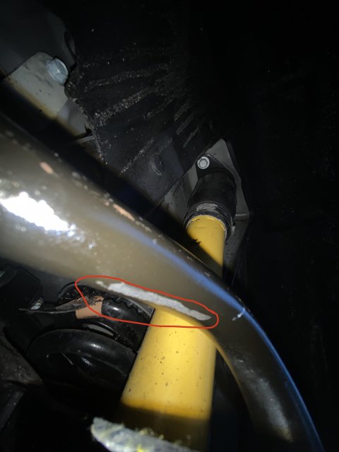

Beginning to wonder if perhaps excessive lateral movement in the sway bar could be contributing to the extent of the contact?
I will probably try to center mine and clamp some locks on if i can get to the bushings.

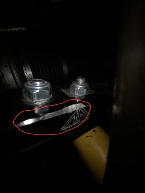

Interesting mine has not done line lock or burnout. But you can say mine did the rest of it plus very excessive corner energy. Mine got a bit worse than that picture but it made the divot a little deeper. I’ll shoot a pic this mid-week. I am going to put it up and try to put on the AAD toe arms myself, the BMR toe arms make a couple different kinds of racket on the street back there. I have had enough of it.
