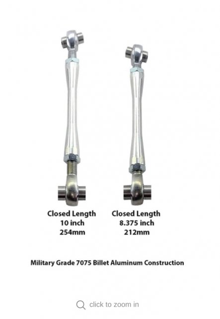

I haven't taken really any pictures of the process but both front and rear links are on and the 315/50 are installed after fitment mods.
The driver's side needed A TON more work than the passenger side for some reason. More hammer and much more plastic work...and it STILL contacts the liner under full droop. At load there is plenty of room. Passenger side took the rib and pinch down as usual and when test fit without the liner it didnt even hit the plastic chassis shield but I still heat rolled it back and shaped the liner to it. No contact at full droop but it is VERY close. Loaded clears by a football field. I was able to retain the full plastic inner fender liner on both sides. No trimming.
The differences make me wonder if the fenderwells really are that different or if the cradle is shifted a little? I know that the splash shields from JLT cover differently on each side. Oh well. They're on.
The Bwoody parts pull the sway down just enough to get the job done.

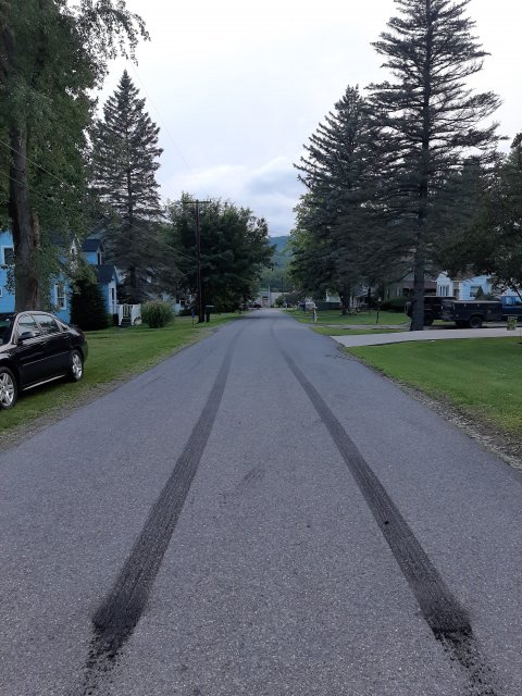

Ok. Excuse lack of pictures...but I've been busy a lot of the day just getting things back together after the CCI driveshaft issue. They are 100% taking care of it...but I'm on the stocker in the meantime.
Good news is my line lock works. Haha. Isnt this how you take tire stickers off?
These things turn right into goo. Sticky as all hell. 40 roll and all you hear is the stock carrier bearing begging for mercy and you're flat gone. Zero vibrations to 140 mph. Kudos to Paul at PK Auto for the bundle deal plus mount/balance.
I did discover VERY MINOR contact with the fender liner as evidenced by the marks on the tire. Super light ring right at top edge of lettering on both sides. This could've been from test fit and driveshaft rotation but all I need to do is heat gun it a little more. Otherwise clears 100% and no major interference or rub. The Bwoody links did their job.
Downside? A little controlled wheel hop on the street under a 2nd gear hammer drop slight uphill terrain. It's done it the same spot on street tires too when it's a bit moist so it's time to lock stuff out and order the front diff brace , cradle lockout and AAD drag pack. It never ends.
