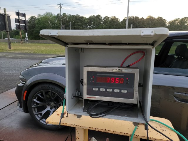

What in the world is wrong with that scale? its A solid 500 lbs off. is the back of the car on the scale? that car has the stock front wheels on it and both seats in!

I can tell you the scale is off, by a lot.
Yeah could be, I just made sure it was zero and drove on. That's what it said.

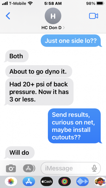

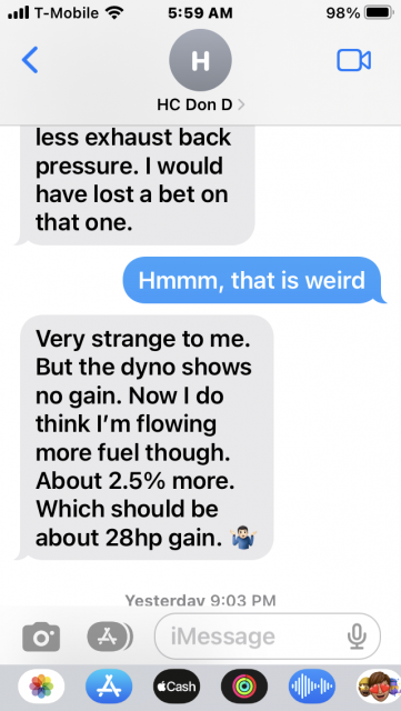

A friend just dyno’d his 1000+ hp cat with the exhaust removed as he fitted a gauge to an unused O2 sensor port and had 20 psi of back pressure at WOT. He surprisingly gained nothing on the dyno with the exhaust removed. He runs 5.6 in the 1/8 (local to him track is only 1/8 mile)

Does he have headers or factory manifold? When he removed the exhaust what was left after the headers/manifolds? Jon is pulling the cat-back exhaust off for the weight which is 55lbs. After the stock manifolds or headers there needs to be a length of pipe or torque and hp will be lost. So one way with aftermarket headers would be to leave the intermediate pipes on that would connect to the cat-back. Or if you feel they need to be straight you could put some 2 foot dumps off of the headers. The exhaust would rather have a longer pipe then shorter for making power.
Being the factory exhaust has straight through mufflers I'm really not surprised by the dyno results. There should be a point where a 3" exhaust would make more power then the 2 3/4" factory exhaust but he may not be at that point

Long tube headers, took the exhaust off from the collectors back, pretty much the same as it would be with cut out dumps mounted right off of the collectors.

That would be the way to do it. So the car will be 55 lbs lighter at the track. As far as hp as long as the cat back isn't restrictive then the hp shouldn't change. I don't trust dyno numbers anyway. I have seen 40hp gains on a dyno but none at the track
