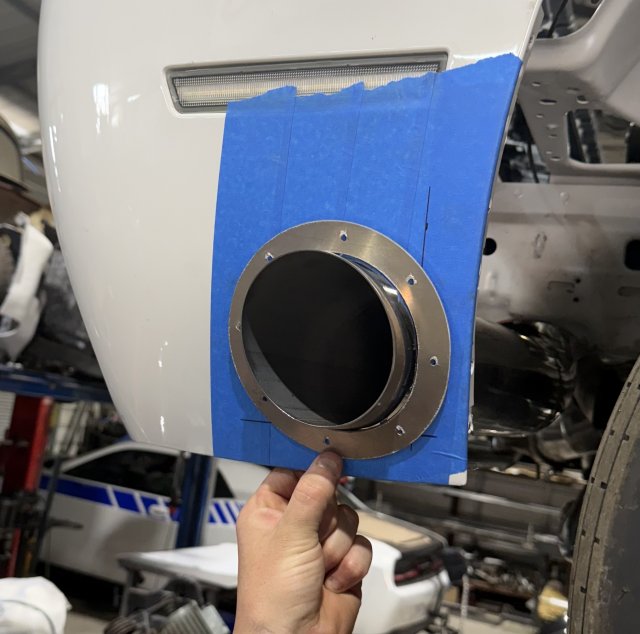

Yep. My own design. I had the Mopar mud flaps before and still got rubber all over the rear. The way the side rolls under behind the tire still exposed the rear quarter. My tires are inside now compared to before but these should work better the way that bottom edge will catch the rubber down low. I think I see a possible offering from Carlin Fab in the works.

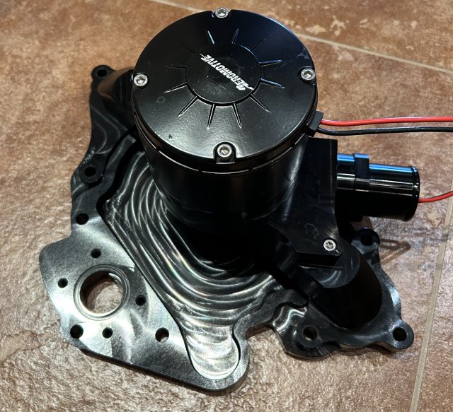

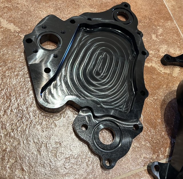

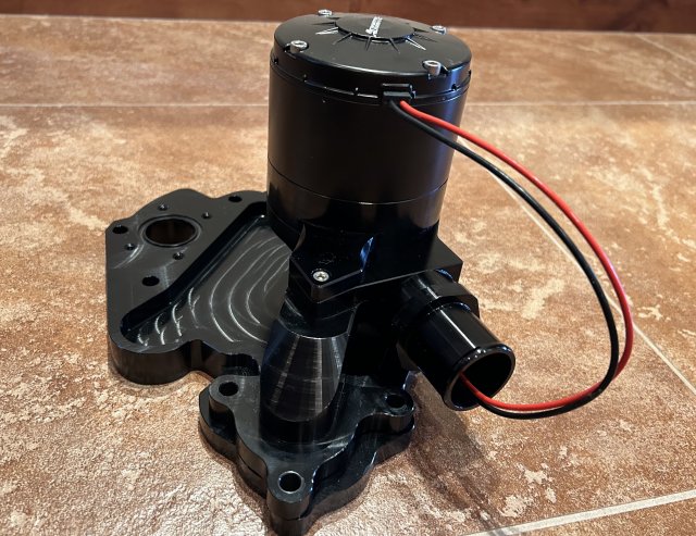

Let’s talk water pumps. This just came out from Aeromotive. A direct mount 50gpm electric pump and plate that is a direct bolt up for the 6.2. Just what serious turbocats needed! 🤩. The aftermarket is catching up big time for us 👊 IMG_7720.jpeg IMG_7719.jpeg IMG_7718.jpeg
1,539
3,854
Wow, good on Aeromotive! Would have thought Meziere would have struck first - maybe they have - have not looked recently.
Thread Starter #1,685
This the one HHP has that fits all Gen 3 hemis?
The 6.2 is different. Nothing fits all the Hemi's.
Thread Starter #1,686
I don’t see the plate with it, but says it fits all
It’s the plate that is different. The pump is the same but you have to use the 6.2 specific plate.

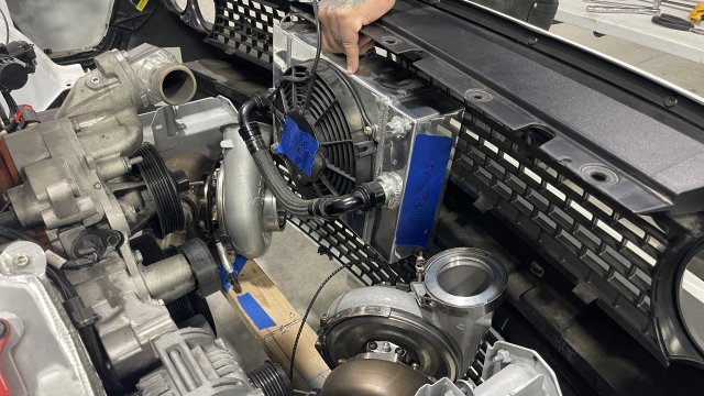

Thread Starter #1,688

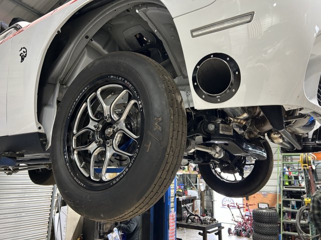

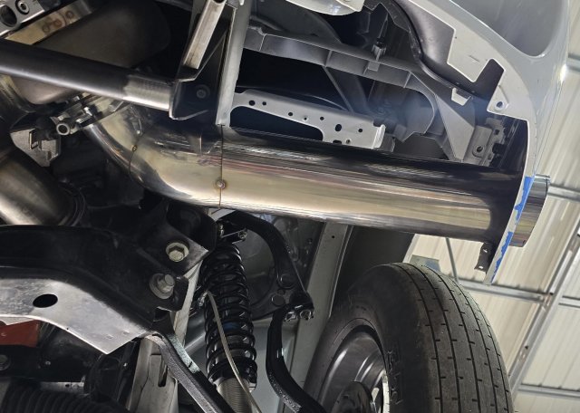

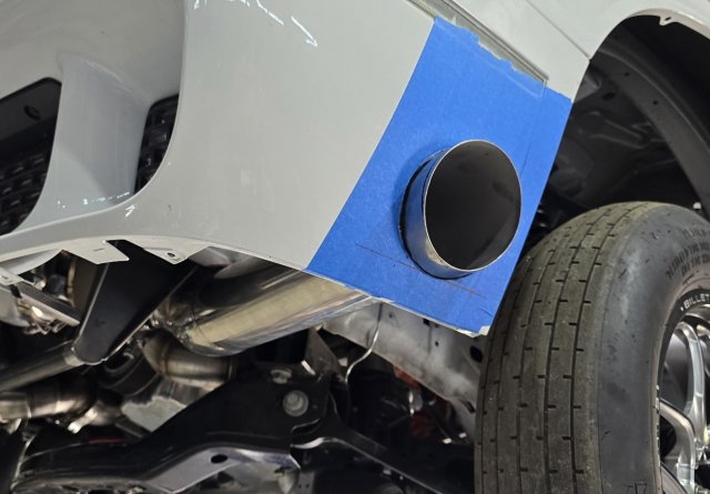

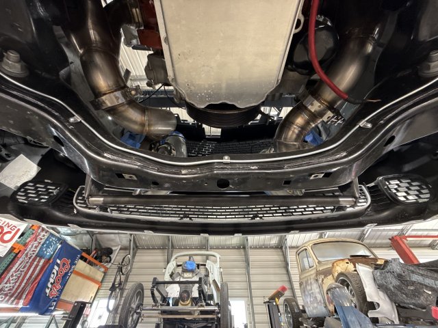

Update on where the noise will be coming from.. 😎 1194425957508635586.jpeg 989115308879963880.jpeg 5200868130246329480.jpeg IMG_8498.jpeg
1,522
2,133

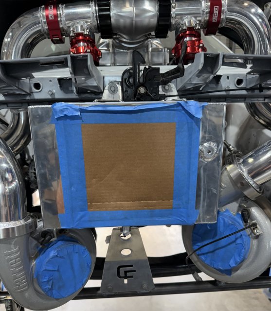

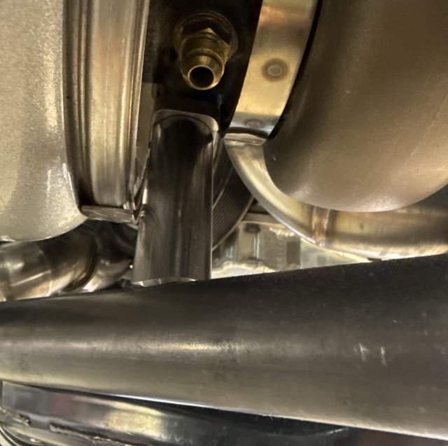

Thread Starter #1,690

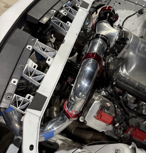

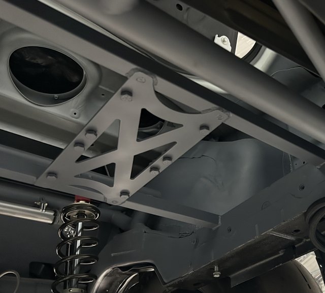

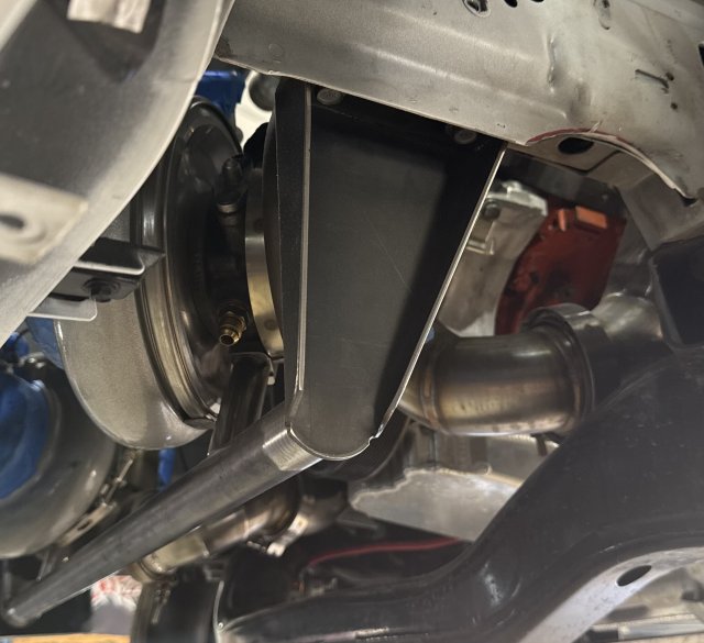

Came up with a nifty bolt-on support for the Maven mounts directly under the turbos. That solidly supports the turbos so there’s no stress on the hot side piping. Just the cold side left and it’s done. 76704789227__931A4F98-E8E3-4E5F-8E66-34C4DA0F8163.jpeg 76704790850__0F6388A5-A613-4EB1-8A15-ED3ECC37F26D.jpeg 76704853500__FB16B17D-F92D-471A-A697-E3BDBD0FCE7E.jpeg
That’s super slick! That for the radiator support?
Thread Starter #1,692
The factory radiator support was replaced with that bar to support the turbos. It will also support the small radiator we will be using. IMG_3460.jpeg

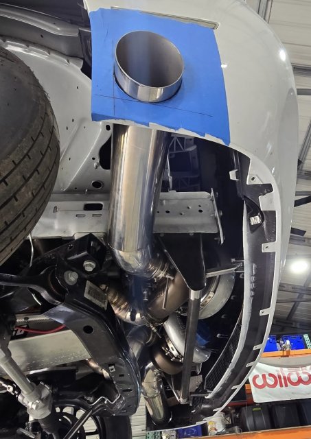

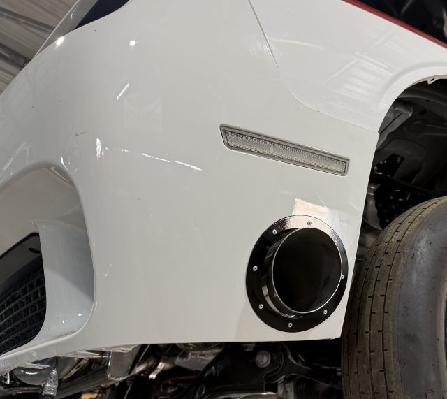

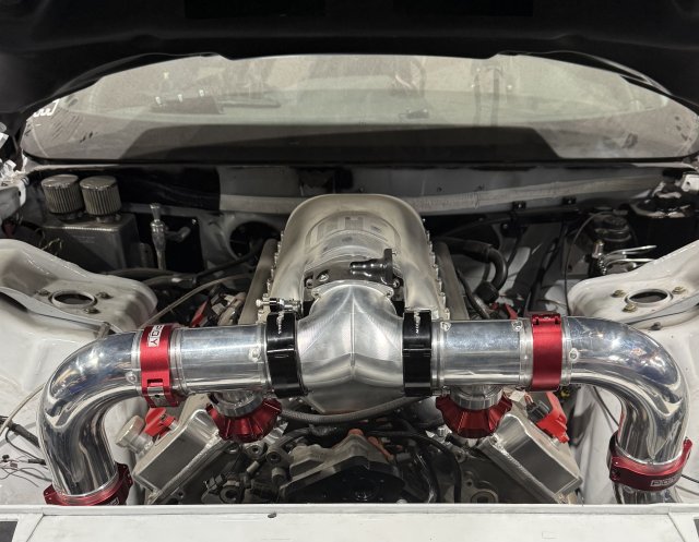

Hot pipes are DONE. I’ll be there Monday morning to start on the cold side. Everything should be finished by the end of the week. I like this. Understated 😎 IMG_8516.jpeg

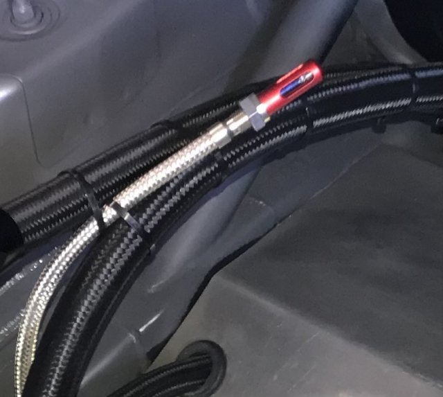

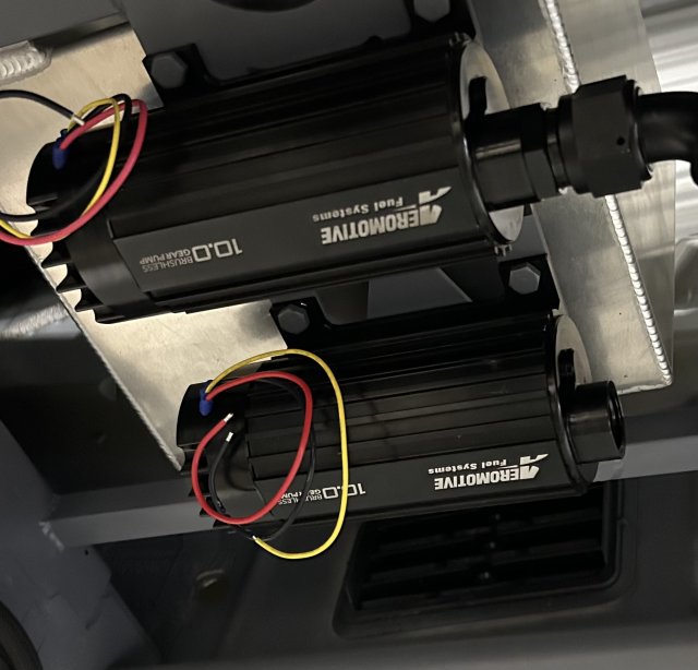

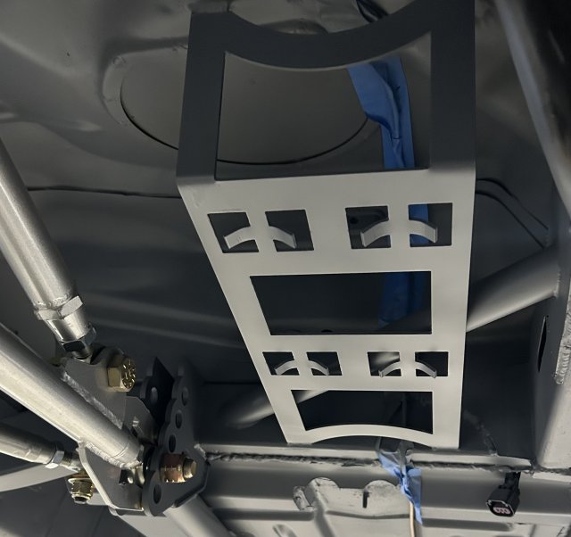

Sometimes you need to make a bracket to put something where you need it. Brackets can be cool if done right. In this case.. fuel pumps and really big fuel filters. Real Racecars need cool brackets. 😎 IMG_7726.jpeg IMG_7798.jpeg IMG_7797.jpeg
Yea for when you have enough fuel to go to the moon. 🤣

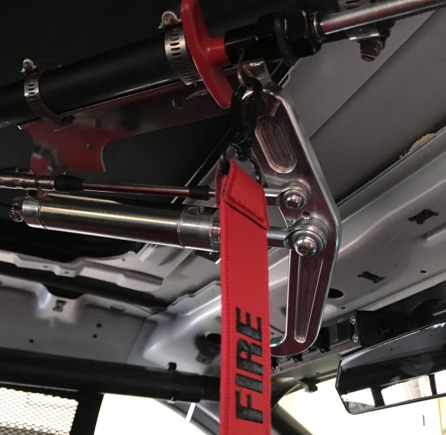

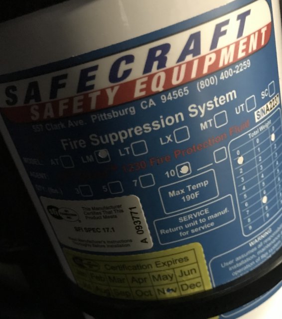

What I want pics of is the fire suppression system
I have a 10 lb Safecraft system with four nozzles. Two of the nozzles (trunk and rear seat area) are heat activated. Two are manual activation in the engine compartment. IMG_3571.jpeg IMG_3011.jpeg IMG_3825.jpeg IMG_4966.jpeg
