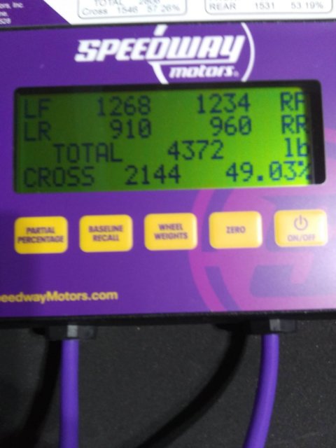

I got the new Super Stock on my race car scales today. Totally stock with a full tank of fuel and no driver.
Wow. Btw I think the super stock has a smaller tank lucky
O ya you prolly aren’t in it. I thought that was light. Still not terrible. There is weight to be dropped
Mine was 4400 even at our local coop when I first got it.
AFAIK it has the same tank as all the others. It's listed as 18.5 gal capacity.

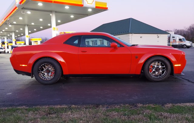

I got my new ride around wheels and tires on today. I really like the look. 1000001473.jpg

Thx Mike. I got a few miles on the street setup yesterday. As we all would expect the ETStreetR's hook the car pretty good on the street. I can hit it hard from 60 and it goes rather than spins.
The cradle lockouts and AAD arms transfer a good bit of rear end noise into the car but that's to be expected since all the vibration reducing bushings are either replaced or tightened up a lot.
My local e85 tests to be 75% ethanol. I suppose I'll need another revision from Jon with less timing since that's what I intend to use for the street. The less expensive fuel is a plus but the crappy fuel mileage is a corresponding minus.
I'm hoping to have a true 9 second pump e85 car when the dust settles. I'd think that won't be an issue.
