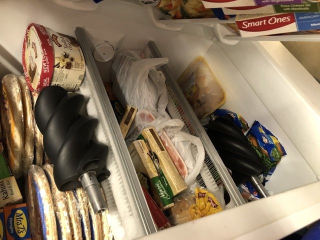

Two things. I'm no expert at blowers and you def have more knowledge on this, but I can't see how some quality moly lube (ARP) on the shaft of the rotors would hurt. I know they said to use no lube, but a slight coating of micro ball bearings would prob help immensely. Also, where'd you get a refrigerator good to -22. That commercial?

Nope, just one made back when they made them right lol

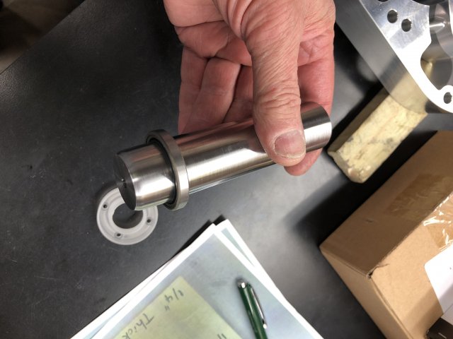

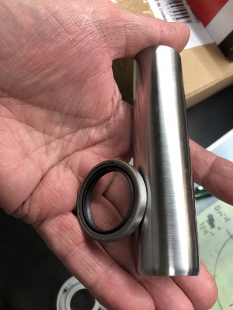

Taper tool polished to mirror like finish to not scratch the Teflon material. There’s no getting a seal onto the shaft with out it, and if made too big stretches the seal too much, sacrificed a $50 seal learning lol.

See the fine line in the shaft near my index finger in bottom picture? That’s the place to stop stretching the seal at, that shaft has a very slight taper too it. Hopefully they retain their shape at 275 for a few hours, will find out this Saturday morning lol

Seals have to go in housing before the bearings, so heat bare housing to 275F over night so it expands. Have seals and bearings in freezer for a day or so. Seals will drop right into their bores in hot housing, so will bearings, clunk right in, no pressing or stress induced, they seat with no induced stresses. Then heat the whole thing again at 275 for a few hours again so bearing bores are expanded, frozen rotors should then drop right into the bearings (first through the can’t even see them any more pressure seal and the gear case oil seal, their 2 different size seals separated by a pressure release port system and also a oil leak drain system) they set in seconds to another stress free mating of the 2 angular contact literal super precision ABEC 9 bearing pairs per shaft. Then seat the heated to 275F also Larger gear onto the driven shaft as well. Set timing, install end plate, test spin, put gear cover on, fill with oil, done. Hopefully goes as easy as it said 🤞

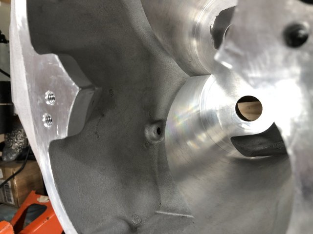

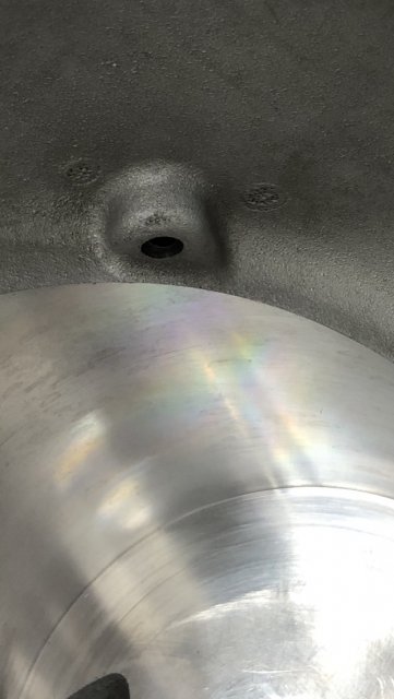

See the port in the blower inlet area? It’s connected to an area between the case pressure seals and the gear case oil seals, that area is under a vacuum and if pressure leaks it’s recirculated back into the rotors.

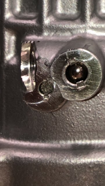

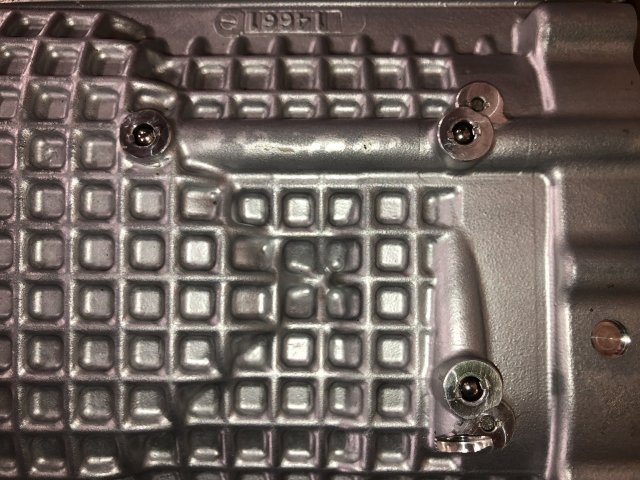

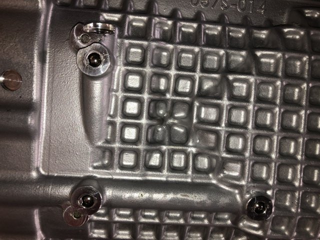

Now look on the belly of the blower, there’s 2 tiny vent ports under there, next to the seal balls. There connected to an area between the pressure seal and the gear case oil seals, any oil that gets by the seals will vent out through these 2 vents. The sealed gear case vents to this area as well through a small hole in the hollow driven rotors shaft, the bolt that holds the drive gear on has a tiny hole drilled through it and that’s how the gear case vents to atmosphere. That why you always want to store these blowers level not on end, or on their sides, upside down would be ok. 8CCC92FF-9D45-4F7C-9588-C4288AA63B94.jpeg 55D5B432-2030-4331-A346-C59E577ADAF8.jpg

Word to note here on AIR VENTS on bottom of Supercharger and the addition of THERMAL BLANKETS
Be sure to cut holes for these 2 vent ports so they can do their job and let gear case breath or your risk blowing out the oil seals!!

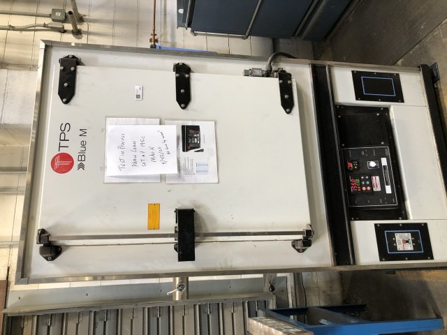

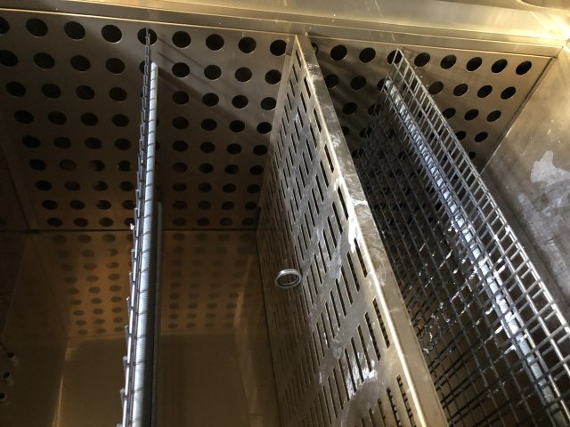

Seal passed the oven test, with stood 350F for 4 hours no change in lip tension or fit, so far looks like it’s going in the oven on the weekend lol

Dude....That is Fuc&*^% GREAT! You have to change your avatar to MAD SCIENTIST . LOL. Next sign on the oven put "Test in progress... half life of nuclear material... Please do not touch." :LOL::ROFLMAO:
