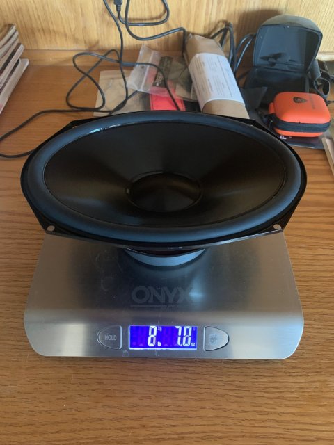

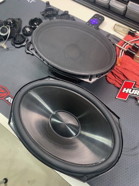

Door speakers DONE. These Infinity Reference REF 9630cx were installed in the (modified) factory speaker bracket using the Infinity provided screws (don't try to reuse the stock ones, the integrated washer is too big and won't fit) with a Metra wiring harness (free with the Crutchfield order) and without the (1) component tweeters and (2) crossover wired/mounted/used.
Is that a waste of money? "Mayhaps" as my younger daughter says but as @Diboblo previously noted (and I very much appreciate his expertise and input in this and other threads!) there's only low(-er) frequencies being sent to the door speakers from the factory headunit, so using the crossover is unnecessary. As far as not using the tweeters go, the Infinity Reference REF-3032cfx are going into the dash location where the tweeters were going to be installed and the 3032s have a wider frequency response than tweeters alone will provide, particularly as far as the mid-range is concerned.

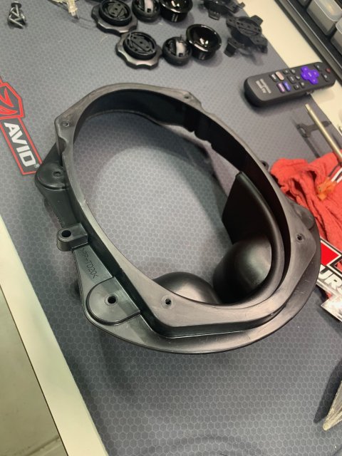

I found the mounting bracket of the factory door speaker to be interesting; it's as if it was purposely designed to NOT fit an aftermarket speaker and required a simple modification to allow it to fit the much larger magnet of the Infinity speaker.

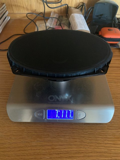

AGAIN the scales don't lie; there's a 12-ounce difference between the two and it's likely almost all magnet. Strike 2 with the HK system; this speaker is as big a piece of shite as the rear deck speakers...
Stock door speaker weight approximately 28-ounces:
Infinity speaker weight approximately 40-ounces:

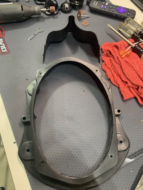

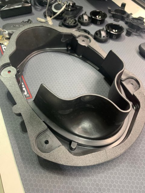

Factory door speaker mounting bracket, top and bottom view:
door speaker mounting bracket.jpg stock door speaker moutning bracket bottom.jpg
Factory bracket modified to accommodate the larger magnet of the Infinity speaker:
stock door speaker mounting bracket modified.jpg Installation note; in addition to making sure to use the mounting screws that Infinity provided and NOT reuse the ones the mount the factory speaker to the mounting bracket I did have to "encourage" the bracket holes to line up with those of the speaker and installed the screws in an opposing manner while pulling on the bracket to get them to line up. It was easy enough, just wanted to note it did not drop straight in and line up...

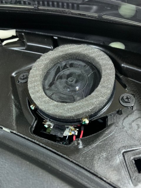

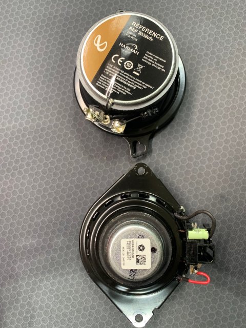

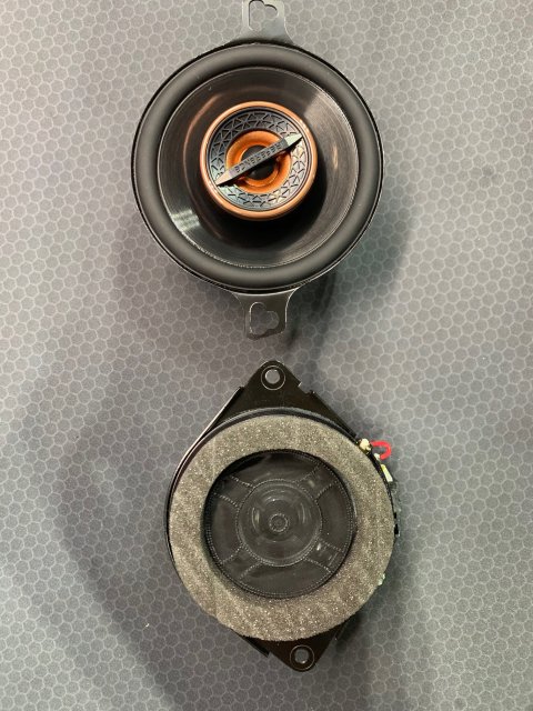

Step 3/dash corner speakers DONE. The findings/results here were similar in keeping with the previous rear deck and door speaker installs...
The HK stock speakers are similarly constructed as the others I've removed; made in Mexico (or China)/hot garbage. Weight of the Infinity replacements was nearly double that of the stockers; they're flimsy and pathetic and comparing the two side by side is how I'm sure PaVaSteeler feels in the locker room :ROFLMAO: there's NO comparison.
Stock dash corner speaker:
Top-side comparison with Infinity 3032s:
Bottom comparison:

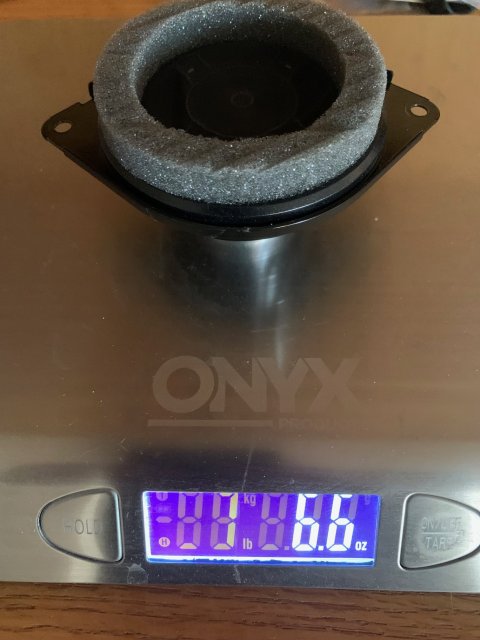

Weight of stock speaker (6.6 ounces):

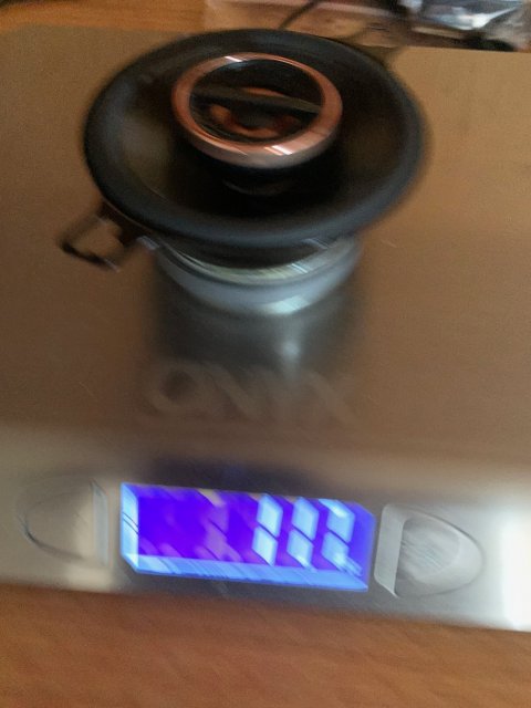

Weight of Infinity (sorry for the blurry image, I didn't realize it until afterwards. 11.7 ounces):
Install was pretty straight forward and they're readily accessible in a few minutes. Crutchfield recommended a right-angle Phillips-head screwdriver to remove them, a 1/4-inch socket is a better/easier choice...
I did a side by side listening comparison of the speakers after installing one side as I've done with the previous installs, and it's readily apparent that the factory system is "optimized" to try and make the 2-ohm stock speakers sound good. At lower levels there's more volume/loudness but as soon as it's increased, past 18 and on up to 24 and higher, it's a day and night difference between the two.
The midrange/vocals with these speakers are crystal clear. Even with the factory biased boosting/equalizing they balance even the heaviest low-end frequencies. I did find myself having to play DJ with the EQ but that's likely attributable to the extremely varied style of music I was using to test it with...
That only leaves the center channel replacement as my last speaker related upgrade. While it will also additionally fill in the front/vocal soundstage I would tend to doubt it will be dramatically noticeable. Noticeable, but nothing compared to the replacing the dash corners.
I'm still really on the bubble about upgrading beyond the speakers; my beef with the stock system at this point is more sound processing/EQ-related as opposed to actual power/amplification. There's only so much you can do with the factory/3-band EQ and if it sticks in my craw enough I'll go down that road but for now the quality of the sound has been dramatically improved and met my expectations...
