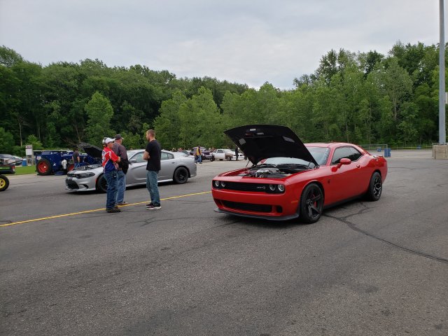

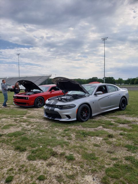

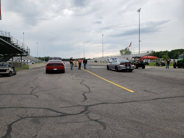

So this is how our night ended, next to run for our 4th pass. We even had done our burnout and they stopped us, light rain. Drug the track one to many times then pulled us into the box and shut us down again. It also would have been our 4th race against each other. 2 passes with the legmaker and one with the stock box. We were switching lanes every pass also. Looked like the right lane mph was higher
I have to review logs in the morning before posting more. I really wish we would have got that last pass in and one more with the lmi.

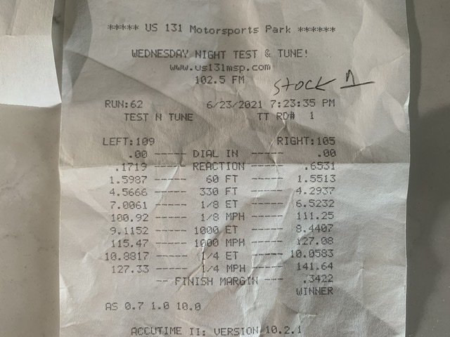

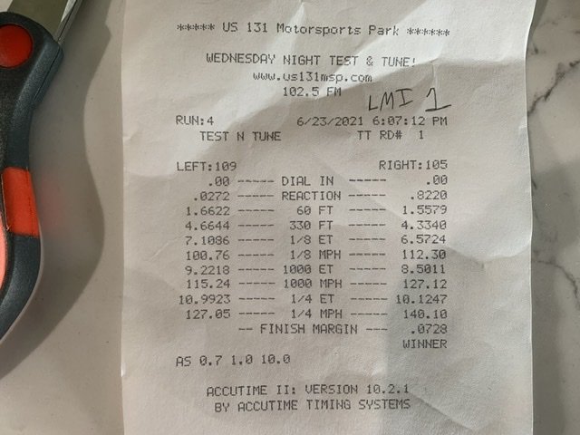

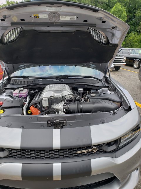

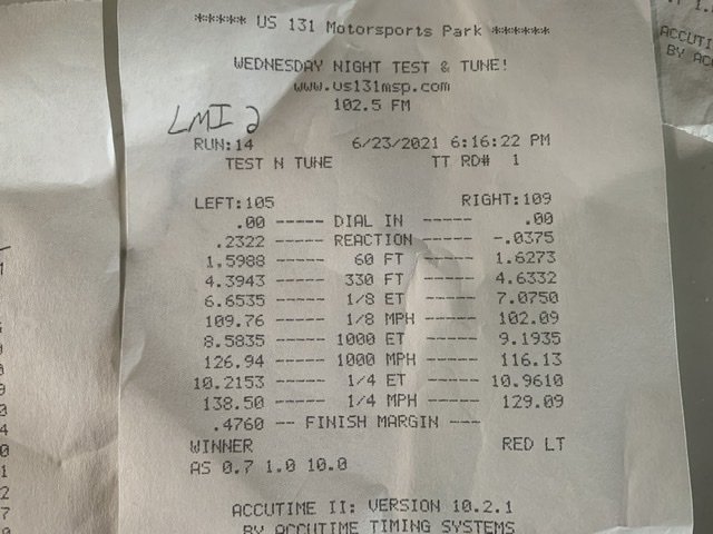

I knew there was going to be a chance of rain but once we got past 5 I thought we would be good, nope. Da was1958 temp 74 and 49% humidity. We made our 1st pass left lane at 6:07 I had a 1.66 60ft, 7.10@100.76 1/8th and 10.99@127.05 I was about 50# heavier then last time out.. 6:16 we had our second pass and switched lanes. 1.62 60ft 7.07@102.09 and10.96@129.09
We switched to the stock air box and got back in line. Almost ran us but went to the next line so we had to wait. 7:23 we finally made our next pass and my car was more heat soaked then it being cooled of. Back in the left lane I had a 1.59 60ft 7.00@100.92 and 10.88@127.33 DA 1800 temp 72 and 50% humidity. These reading are with my Kestral and it moves a lot so it could be still a little off but all in all very close. Looking online it shows DA 1922 for 6:00 and 1916 for 7:00 and 1700 for 8:00 so it could have been between the 2 at 1800
Really wished we would have had the last run but nope. Jon will post his finding but I can tell you his last pass was his fastest also
20210623_174204.jpg 20210623_174213.jpg 20210623_174221.jpg 20210623_184041.jpg 20210623_184035.jpg 20210623_184029.jpg

You can see da information above. My mods are 2.85 - dual pumps - fic 1200's
Before timeslip notes. I wish I could have gotted one more lmi pass in to see if I could possibly run cooler and see what happened. But the rain stopped us.
My exact fear happened and that was getting to hot before taking off. The stock box had a gain but looks to be becasue it was cooler. I'm guessing the pass I didn't have a log for I was cooler.
Regardless if cooler or not I am showing no gains. To bad I couldn't get an LMI pass around 8:30 when it was cooler. If only it didn't rain we could have made about 5 more passes with ease.
Lmi- before burnout 126 iat - afterburn out 140 iat- iat 147 take off - End of pass - 90 degrees
stock before burnout 97 iat - After burnout iat 100 - take off iat 104 - end of pass - 81
lmi max aircharge - 1674
lmi max pratio - 2.13
stock maxaircharge - 1674
stock max aircharge 2.15
Here are the time slips. My datalog for the lmi was from timeslip lmi 2. I think I double tapped the record button on accident causing it to stop on the first.
My passes have the intake about the pass. The other lane is vortecd
4F2266E2-3258-4AD0-BEBC-FE03C68B40CE.jpeg 29A271EC-ED7F-489A-9AE2-EFBCA664488C.jpeg
You can also see my 60ft and 1/8th mph were noticeable worst my guess is the second lmi pass it was hotter and didn’t start making power until it cooler down. I tried keeping 60ft as consistent as possible.
Lmi 1 and stock box were very close to the point were I don’t think it makes much difference I’m just guessing the lmi was a little hotter. I only have a few mile drive to the track but I still let it cool down for 40 minutes before the first run.

Looks like as previously perceived the stock airbox for the win even on a mildly modified Hellcat. Which air filters were you guys running in the stock airbox?
#37
I have a green filter.
