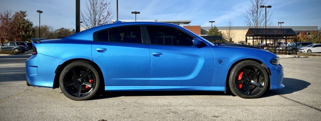

Haven’t launched my OEM ones yet. Have to wait for spring. I’m in winter mode now.

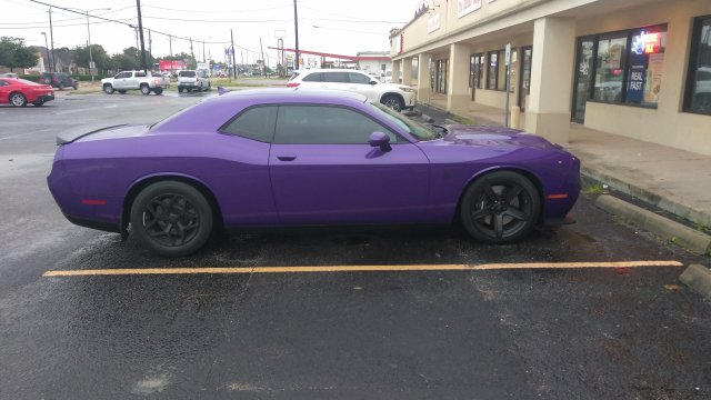

With the HHP version installed. Right after with maybe 5 days and 200 miles since the installation.
Those are with 305s in the back right? Looks like it sits about the same as stock.

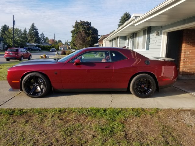

@TEXAS REDEYE
HHP Drag springs
19' Redeye OEM springs.

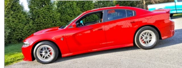

Here is my car with demon springs and about 5000 miles on them to settle .
Rear tires are 305/45/17
Fronts tires are 27.5/4.5/17
