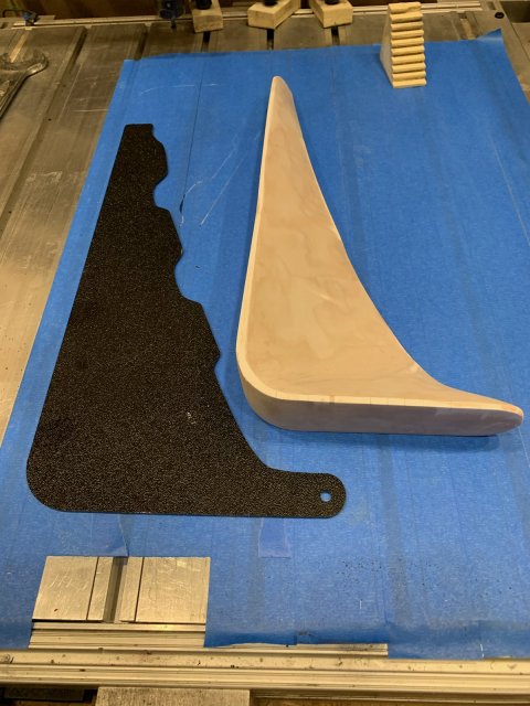

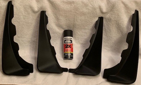

Made new mud flaps for the car. The paint show in the photo is a very close match to the spoiler and matte black trim pieces.
ABS?
What basis did you use for the mold?

Used 3mm ABS sheet for the base, cut on a cnc. Upper portion is ABS 1.75mm 3d printer filament. No mold was used, but glad to send my computer files (g-code files etc.)
Yes please!
What is the part that looks like a mold immediately to the right of the flat sheet, wood in color?
Did you somehow print ontop of that???
If so, that's a new technique for me, very confusing. Maybe I'm missing something.

The part you are looking at is the printed part itself. The surface finish of a printed part is usually banded and so to get a good finish, I cover the part with a skim coat of bondo (giving it the light brown color) and sand it smooth. That's what you are seeing in the picture. Then the printed part is glued with epoxy to the abs base and the whole thing is again coated with bondo to hide the seams and is sanded smooth for paint. I've included the base flaps as pdf files, however the printed portions are .stl files and this site won't let me upload them. It takes a lot of work to make these, but I am glad to help anyway I can. Do you have an email address that will allow me to attach the needed files? If so drop me a line in my inbox and I'll see what I can do.

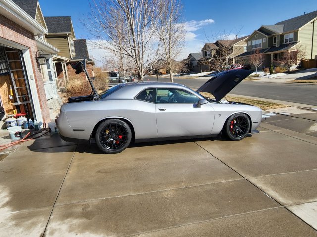

Washed
