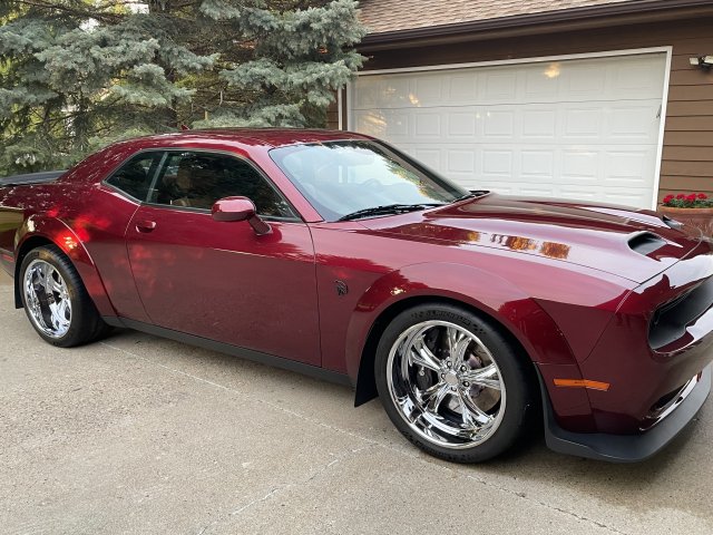

Since the road course stuff is not needed for another month, it got a quick pad change, wash and returned to being a simple hot rod last night.
Welcome back Freebird! It has not looked like this since October last year!

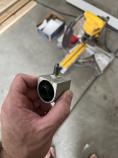

Replaced the shifter mount bushing. I’m sure you M6 guys already know but these things seem to wear out prematurely. 24k miles on my 2016, who knows how many shifts but I could feel the shifter moving up/down when I would shift up into 3rd or 5th.
$38 from Steve White and about 45 minutes of work. Worth every penny to get rid of that little bit of slop.
https://www.stevewhiteparts.com/oem-parts/mopar-bushing-68292259aa

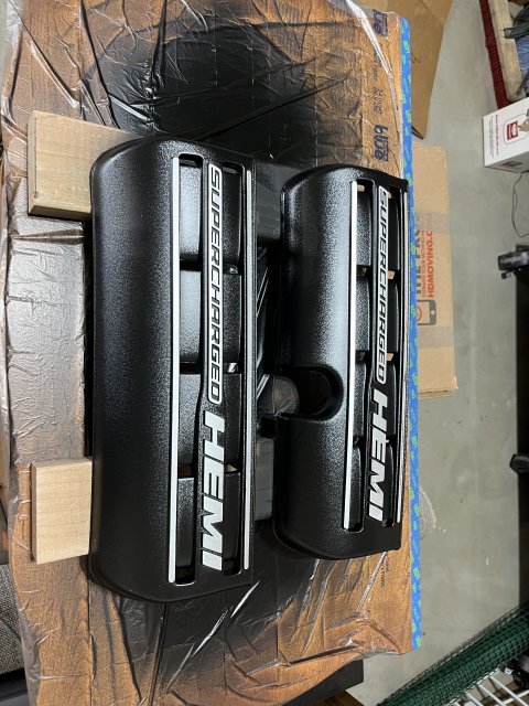

Was cleaning the engine bay a bit today and noticed the coil pack covers (or whatever these plastic pieces are called) looked pretty bad. Maybe the previous owner used some chemical on them that ate away at the finish?
Used a fine grit sanding sponge and knocked the gloss off them, then used this VHT paint. Not perfect but looks pretty damn good for $10 and an hours worth of work.
One note though, the silver-ish paint on the letters and stuff will come off if your painters tape adheres too well, so get some lower adhesion tape.

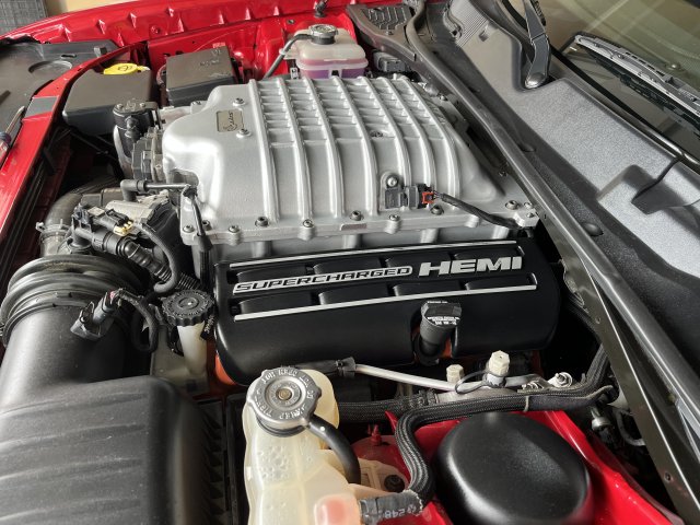

My son wanted to work on the car today but I didn’t have anything to do to it, so we took it apart and cleaned it haha. We literally spent about 5 hours just hanging out in the garage, listening to music, and casually cleaning the car. It was awesome.
Still a lot of work to do under the hood, maybe take it somewhere for a steam clean? Pretty happy with the $10 VHT rattle can re-spray of the coil pack covers.

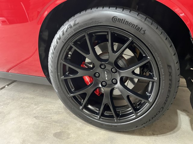

Pulled the wheels and cleaned the barrels, finally cleaned the residue off from the old weights

Anybody that pulls the wheels off (like I do) to clean them is just damn fine in my book!
Don’t give me too much credit, it’s like a once a year thing haha.
