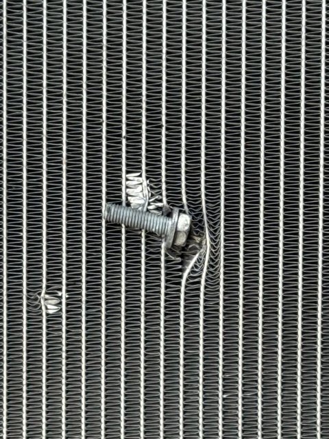

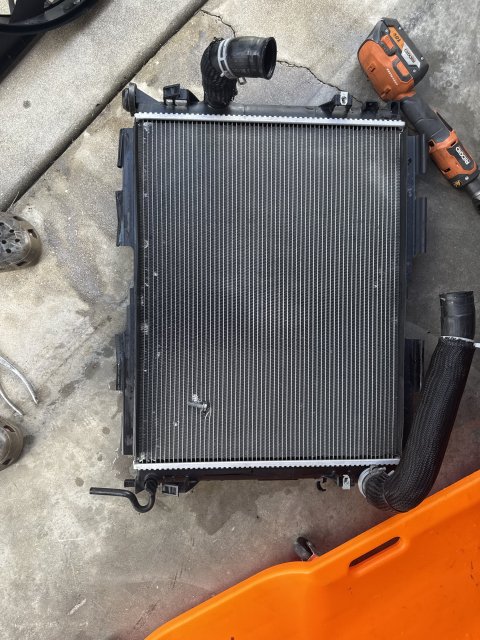

This is what happens when you let the dealership do your stage work! Do you think the tech will fess up to it? 77965753901__4A7F3F74-75D8-4730-B4E7-18E7435C8D7F.jpeg 77965752805__E69CD795-273E-4FB9-AF81-62E37F8659FF.jpeg
That would be a replacement thermostat bolt .

It’s not my car but a friend who wanted to keep his warranty, hard pass on stealerships.

This is what happens when you let the dealership do your stage work! Do you think the tech will fess up to it? View attachment 172665 View attachment 172666
Exactly why I do absolutely everything I can possibly do, myself. Saving $ is secondary.
Same logic: I usually buy new and keep forever, and do my own maintenance, that way you know everything about what has been done. Last 3 were over 150k when I sold and I got premium price for them!

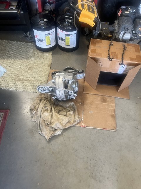

Went for a ride then got pissed off because of the howling rear end so! IMG_9745.jpeg IMG_9746.jpeg
How many miles???

That gear has 1800 miles , didn’t last long ZF make junk rear differential in my opinion.
