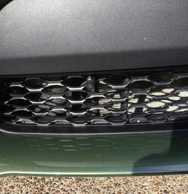

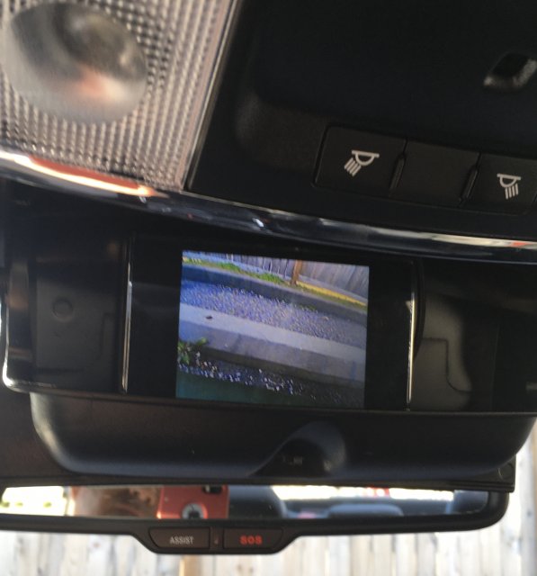

Front camera install. Bullet camera in lower grille. Monitor in the overhead console flip-down sunglass case. Wireless with the camera transmitter under the hood to the monitor receiver tucked up behind the overhead console. Plus: Better than the non-existent factory camera option. Minus: Camera is not a true “fisheye” lens, only 170 degree field of view, so camera has to be pointed off to the side to catch both the centerline of the splitter and the part in front of the passenger side tire (for angled parking), which makes the view a bit awkward until you are used to it.

You didn't want to hook that up to the radio???

I did/would, but, at least what I was able to read up on, solutions to enable a signal to show up on it (as the back up camera does) were pretty cumbersome, with many descriptions of people just giving up, since the Uconnect is locked down pretty well. But, if someone were willing to post a simple, proven, tutorial I could follow......:)

Awesome!
(but I'm sorry, it looks a tad crooked...)
Yea, just a bit but, most people don’t notice it. 😉

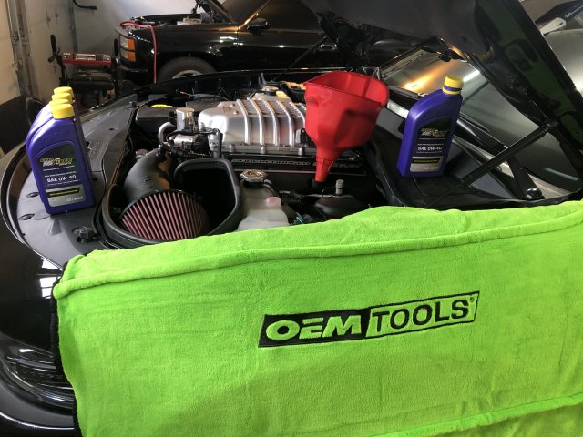

Made the switch to the purple stuff. HPS Royal Purple. Have heard it does well in e85 applications.

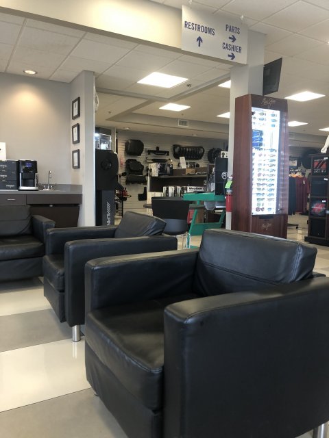

Getting my oil changed, I am the only customer in the entire service department. Incredible B2E9A222-B274-4615-9C4F-47BB752BD9E0.jpeg

Roll out the sanitized red carpet, with 3 guys going to town on that ride, just like the old customer service days when we pulled into a gas station and said “fill it high test” for the younger ones here that typically meant something like 100 or 104 octane.
You should get top notch service!

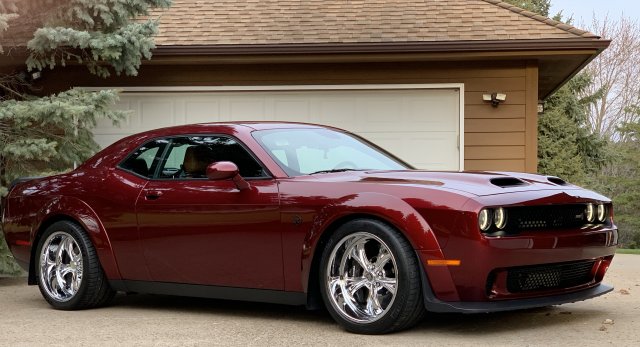

Took the Cat out of hibernation. Glorious day here in mid Michigan. :)
