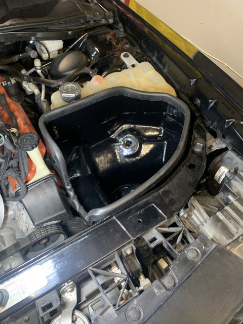

Performed a magic trick and made my stock intake disappear and a JLT appear in its place.
This thing is loud as hell now, no complaints. Can hear it screaming, made a few heads turn on the strip. Obligatory post of Max, cause he’s a good puppers.

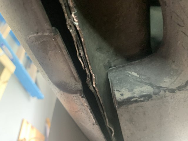

Repaired the pinch weld do to the damage done jacking like a rabbit at the track to put front skinnies on. Then added some lift pads as I don't want to have to deal with the sound of metal breaking/bending ever again while on a jack and having a mini heart attack because of the pops.
Straightened out the pinch weld, it was all fuckered...
Trimmed some plastic so it fit.
Loctite cause fuck you backing out set screws, that's why...
Admire your handy work...
Test.
Should have done this right away when I got the car but now it's good to go. No problems at the track anymore and won't have problems at the house either. best part, can be used with jackstands now as the load is distributed.
