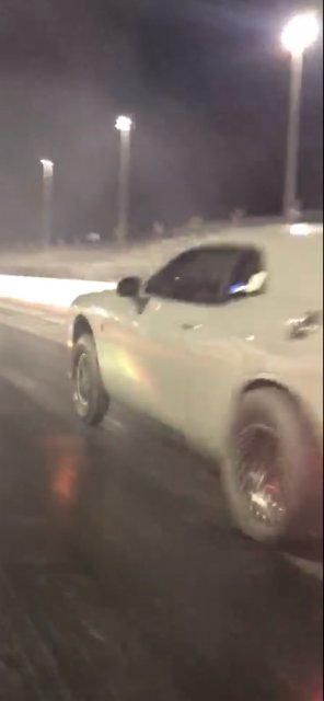

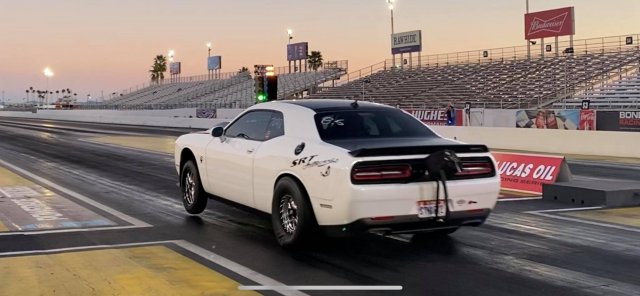

You’re right. They don’t squat much. Maybe one inch max. After observing this.... I reduced my positive camber to a .3 degree setting. It just doesn’t change as much as I previously thought. I would suggest anybody that also drives on the street or doesn’t leave that hard just go with a zero toe/zero camber and be done with it. This is what a 1.3 sixty looks like and the fender doesn’t even come close to being on the tire. 40DDFA35-83A2-4C38-9E61-07A2FF155DFF.jpeg
