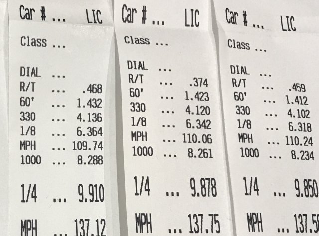

What's next....I need a better 60'

I’m curious to see if your tune tweak will help. My car is also tuned by OSTMike and in good weather and track prep will go 1.39s to 60 consistently with a best of 1.37. I street drive my car a lot also and it is all factory suspension/brakes, 2.62 gear with a 18x10 wheel with 305/45 18 et street r.
I'd be thrilled with those 60' times. What mods on yours like pulleys etc and what are your 1/4 ET and MPH? Sounds like we're pretty close on everything you listed so now my ears are perked up LOL
