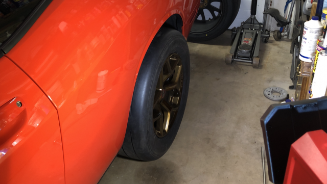

I swapped over. Helped a little bit. Still can’t get my 60’ to drop under 1.45
I keep blowing the tires on the hit. I got to try taking power out of it on launch.
I can actually see the negative camber you've got in the rear in that picture. Go positive and you'll do better.
Nice picture btw.... Looking forward to GB!
Yep. We will be getting an alignment done for the this wheel and tire combo next week.
Appreciate the heads up.

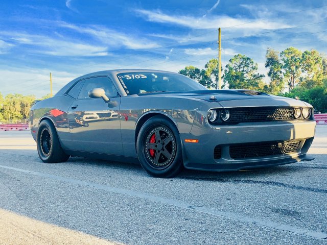

Bad ass looking car. What wheels are those?
