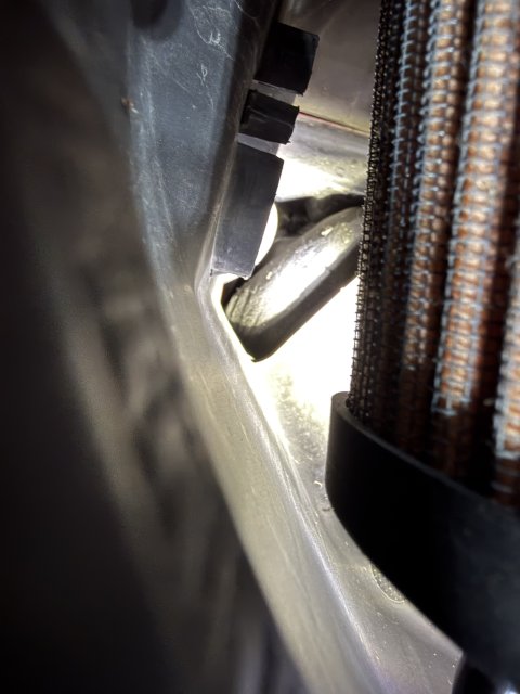

Where is the flow from the most substantial air input to the system? The open area in the air box supported by the lower opening?
Comes in here…
Flows into and up the area under the filter…
Comes in here…
I have also seen a description that if you attempt to open the right side of the hood the airflow will become turbulent and not work well within the SMALL air scoop hood system.

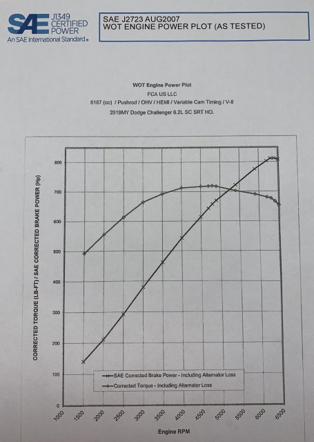

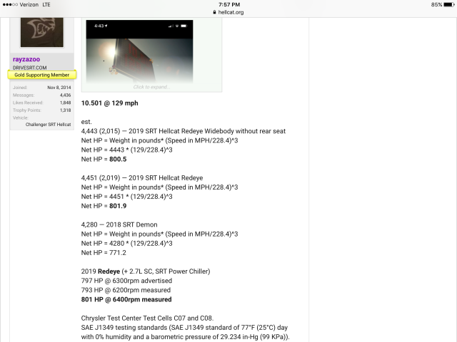

The engine was rated on a dyno in accordance with SAE Standards. You can look around to determine how or what is used for intake air.
What you may lose is nothing. Even if you negate the small amount of air in the hood, it has plenty from below. I agree with Eric, other items may be more beneficial. Realize you may be a at a point the drag racers and others reach, fairly easy to get to this point, further improvements are expensive and small. Here is your enginedyno. Your welcome.
Want more? Eric is all over it, the power btw the models are in the RPM’s. My tune allows 6500😉 and 6000-6500 is where it gets serious (if I want it).
Courtesy of Ray. Thanks buddy!
View attachment 172867 View attachment 172868
