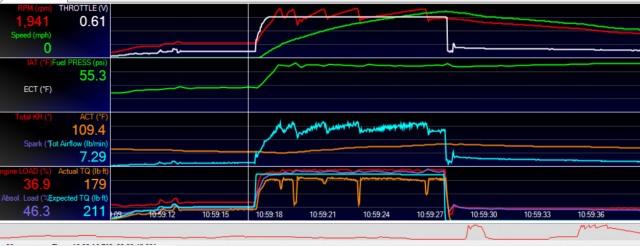

Believe it or not, I do not have one data log from a Demon. I have only messed with the Super Stock and the Redeye. The RPM does not jump up and stabilize or fall on the converter flash like an older car with a high stall converter. It just rises. Here is a Data Log from the Super Stock. The launch RPM is kind of high @1941. If you look back to the left you can clearly see what I talked about above. I had the RPM even higher at one point but I freaked out and dialed it back. You just have to go for it and keep it up there! I bet when I got that 1.32 with the Demon I was at 2200 and staged very shallow.

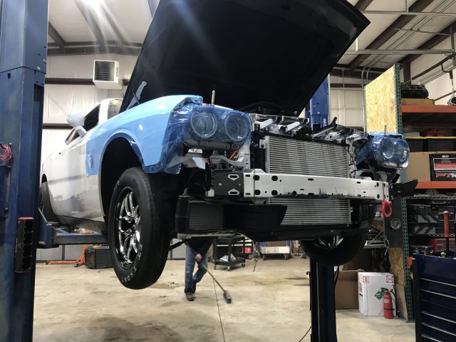

After making that 6.10 pass at Irwindale I got all charged up and decided to take a little more weight out of the car. Got a solid 60 pounds out.
60,291
210,274
Going to look strange going down the track with no nose on the car:unsure:
3,630
11,710
Lol. Lots of stuff hiding behind there that can be removed. 😊 5C193C87-424A-432A-BC02-8070F4DA172D.jpeg

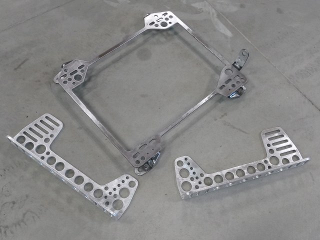

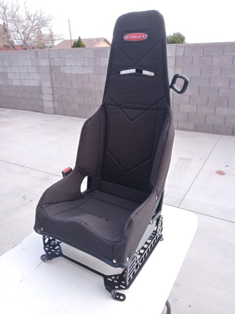

I really like that Kirkey seat mount! What is that?

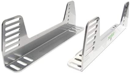

That setup ready to bolt in including the seat belt buckle and seat belt guide is a total of 21.8 pounds. The base and side brackets are made by Planted. But that stuff is HEAVY. If you think about it the 68 HEMI Darts only had simple side brackets made out of thin aluminum that boilted directly to the floor. This setup is WAY stronger (and heavier).
Steel base and aluminum side brackets.
. After my work.......
Also I used all TI bolts and I drilled the 1/2-20 Seat Belt Buckle bolt (could not fint a TI one cheap enough).

I thought that looked like the planted base. The side brackets are bitchin! Yea that’s heavy. I had a set of custom brackets made by Carlin Fabrication there in SoCal (they did the cage and suspension) and the whole seat with cover and bracket combination is only 23 lbs all together. Thanks.

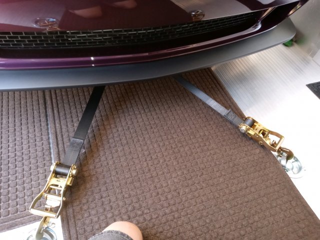

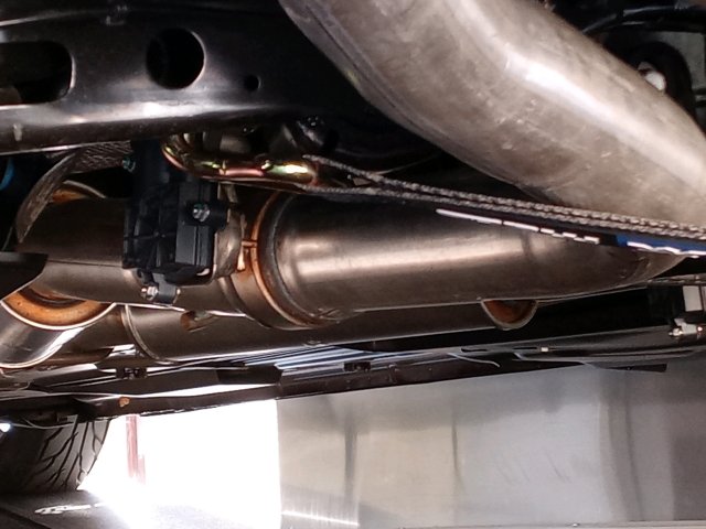

Thread Starter #320
Makes me think of those drilled out hex head tie down bolts.
But with your diff brace installed those should no longer be there.

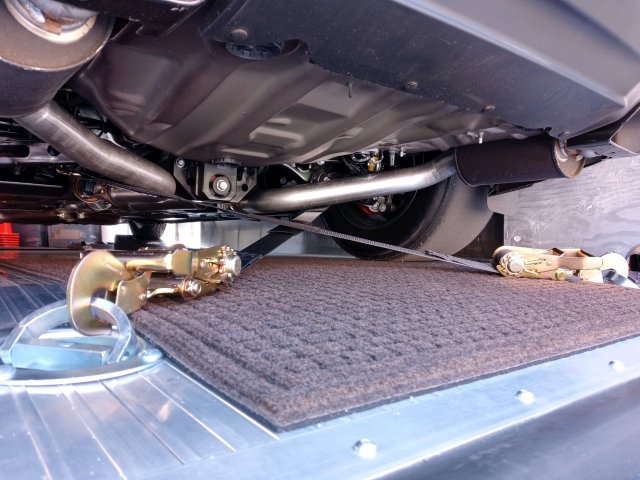

Correct. I have been using many methods over the years. I have settled on a tie down with a snap hook where it attatches to the floor and a Double wire hook facing up where it attaches to the car. It does an excellent job of cross tying. I attach to the K Member in front just outside the rear corner of the rear splash pan. In back I go into the hole on the bottom of the LCA near the inner bushing. That wraps slightly around the exhaust pipe. It also crosses real well. I get everything good and tight. I used to baby those straps but now I tighten the crap out of them.
On the front I got rid of the snap hook and forged mini-J hook and now use a much simpler double wire hook working end facing up.
