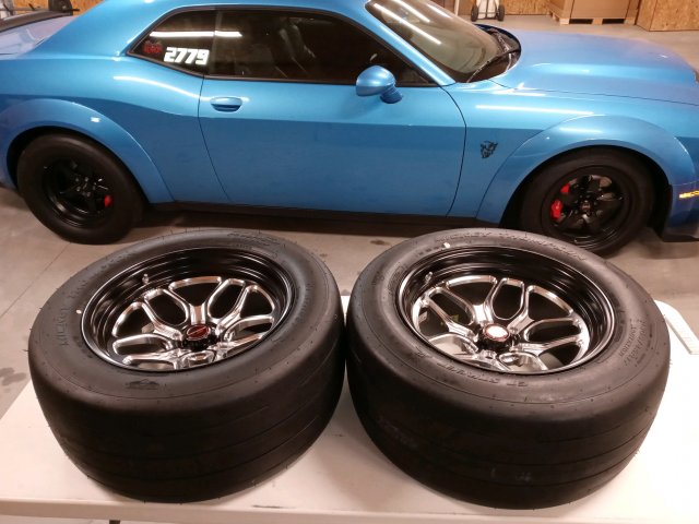

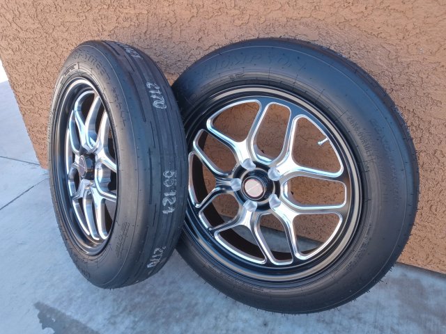

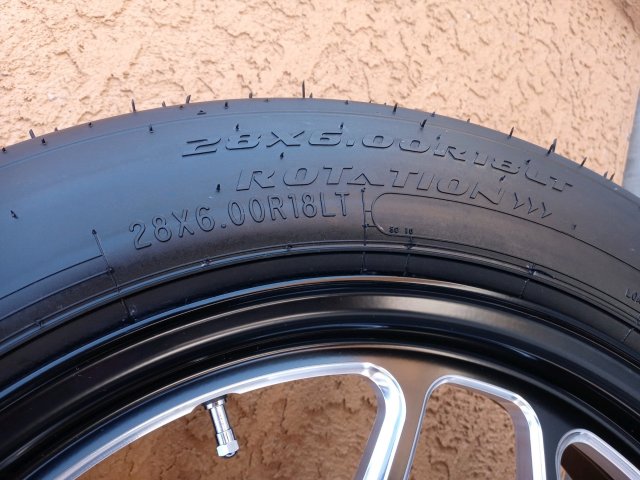

Finally got the front NHRA legal setup together...... 32.4 pounds ready to mount.

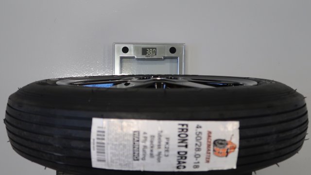

That's pretty light. Mine's 38lbs on a 28x4.5 RM and Dark Star wheel.

Good looking tire. Being Load range C as well as LT I would guess they're plenty good to drive back and forth to the track with?

They look to be slightly over loaded, but I will keep them at the full 50 PSI or a little more, and drive on them. They have the same limitations as the ET STREET R's that are going on the back. I have driven a couple hundred miles, raced and then driven home on them. I just would not do it if they were really worn, and paper thin, because they might not survive pot holes or road debris that well.
This is actually my street setup. All my OEM stuff is gone and I only wanted two really good setups for the car. Not a bunch of stuff sitting around that I never use........

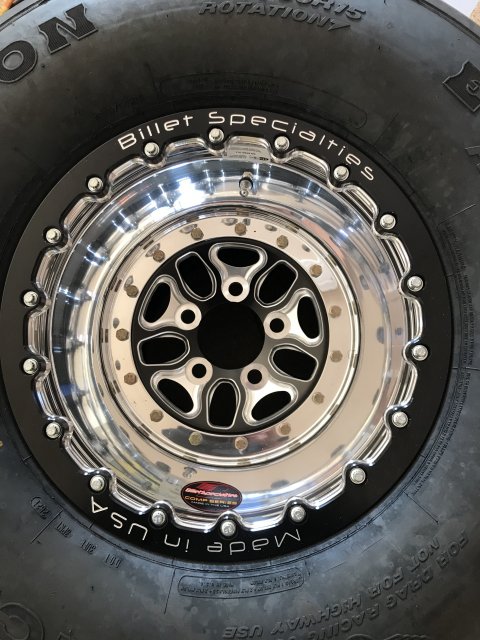

I like that wheel tire combination. That tire is a nice compromise for a occasionally street driven car and the DOT requirements for the street classes. My Billet Specialties Comp 7’s and M/T ET Fronts are 25 lbs. No more street driving for me 😕 5CE9C13A-9A5C-4910-B033-0B9162496320.jpeg

You had me running to their web site. I looked that wheel up. Then I remembered you changed to the 4.5" Bolt Pattern. Damn nice looking wheel Marc.........The 17" setups we run on the Demon are 25 Pounds and the 18X5" setup I run is 27 pounds. It's Re-Sale, I tell you......Plus I like the shorter sidewall on the 18X5 setup. Theoretically it should handle better.

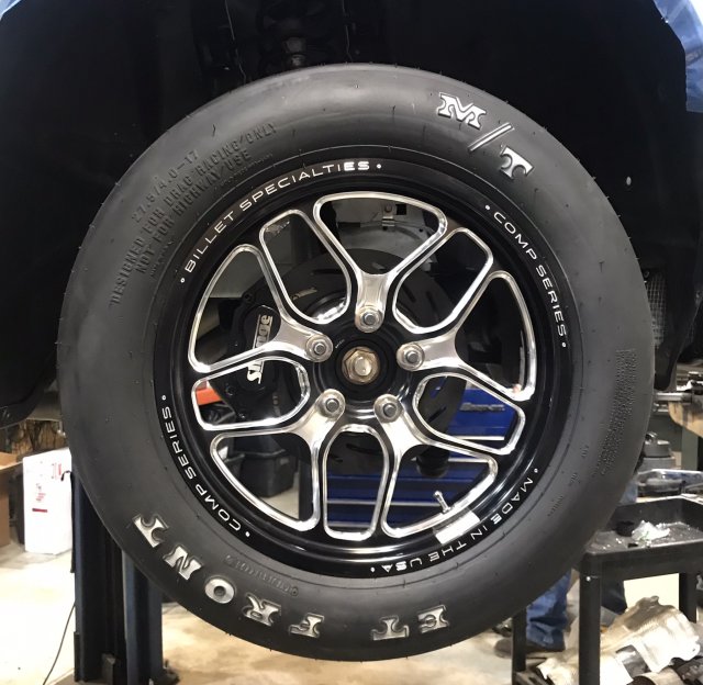

The Comp 7's are sweet. They're so light its rediculous. That's what I went to for the rear when I went to the 4-link so it's a match. I think they will custom make those in the 115mm pattern but not in the 18. It's strictly a 17' wheel. That size with the ET-Fronts are what the new Dragpaks are running now. They ditched the 15". I think their timeframe now if you have to order is about three months. I just finally came to the conclusion that the damn thing is a race car now so stop thinking about wether it will work on the street. 9B838684-8D32-466C-A224-05EE055BC78F.jpeg

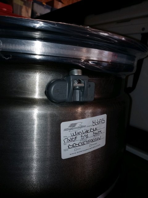

The rears are done. 49.4 pounds ready to bolt on. Mickey Thompson 305/45R17 ET STREET R on a Dodge Wide Body 17X10 Billet Specialties Win Lite. All balanced up using my balance method (see paint marks). Note : Win Lites are knurled now.

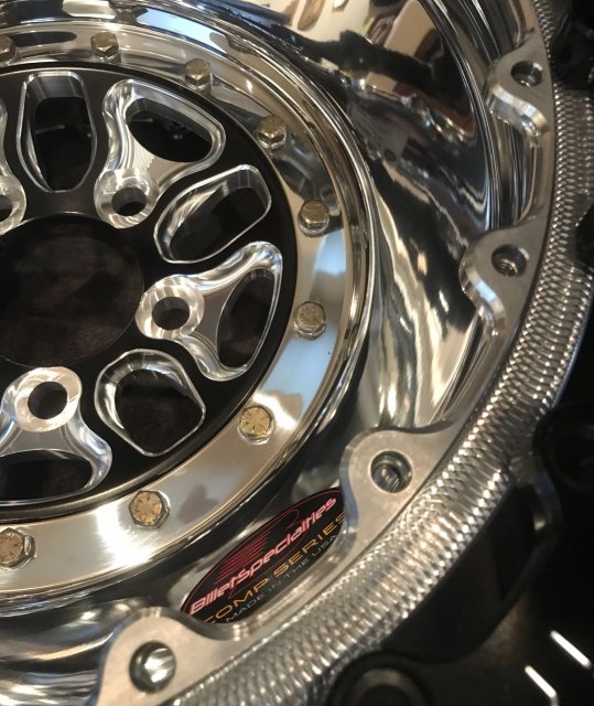

Will that tiny bit of knurl really do anything?

It likely depends on the tires. When they pop into position they actually are tight on the ID. If they are tight they should hold. But they are not all the same in this respect. Plus it still makes a difference what pressure you run etc. I doubt they would do this if it did not make some difference. But I have heard of tires slipping with knurled bead seats. I have heard that sand blasting this area can make the tires hold. So anything to rough up this area might help.

my 15 inch forgestar wheels are slipping on the beads worse than my 18 inch. took them apart thinking they needed knurled only to find they already are.
forgestar recommended trying high tack spray. if this doesn`t work, time for beadlocks.

I use the Hi tack
Slips a couple times then one side holds
Other tire slips about 1 “ per weekend at the Drag strip

I see a lot of company`s offer a high tack adhesive, which one did you use??

Permatex brush on.
