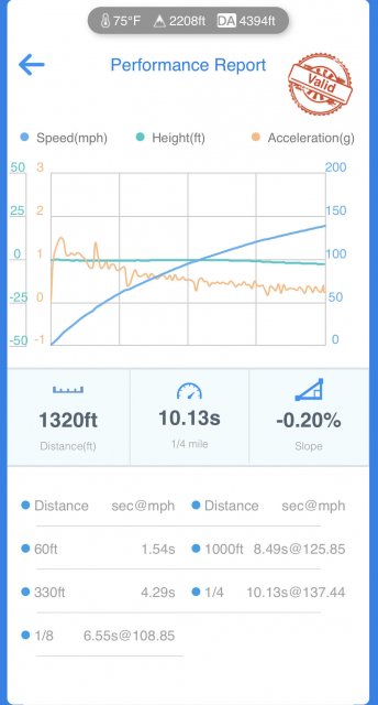

Here is my dragy capture for the run. It seems my acceleration drops off quicker than yours...
High iats. Computer pulling timing to save itself.
Sent from my SM-G981V using Tapatalk

Let it cool off for 90 minutes or so after you get to the track. Pull it in the staging lanes and turn it on and off as you move up. I will bet you get your best time.
