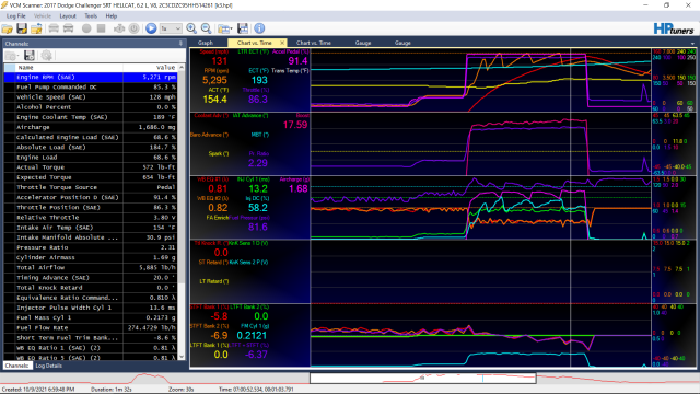

Here is the log from the 3rd pass of the night. According to Dragy the DA was 4394ft on this pass.

I threw your log into my dashboard and everything looks good. There are a few channels I can't see like STKR or Timing but your IAT's are definitely getting up there.
Knowing what I know about how the IATs work you are definitely having some sort of timing pulled. Otherwise you are seeing 17lbs of boost and this thing should be booking. I did 9.6 on a mix of 93/104, you are on e85 and it should be equivalent to 104 and so you may have a lot more timing than me. However your 60' is telling. Get that into the 1.4x range and you'll get your 9s pass.

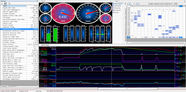

Thread Starter #60
Here is what I can see in a similar spot to where your screenshot comes from. I am not sure what "Total Spark Correction" is and if that means it is pulling 12°?
Aircharge temp is up there for sure.
