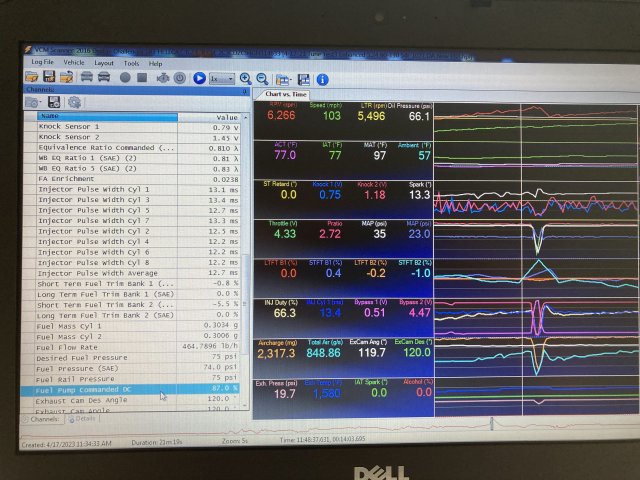

Thanks Jon. So why would anyone want to cut fuel or command leaner for torque management? I would think timing retard would be the safer method? It's probably over my head... all I know is, it looks bad to me that it's doing this at WOT and under full boost.
bigger question is what are you hitting where it’s going into tqm. My suggestion find a new tuner. Not sure who tuned your car but you said he’s well known. Not saying Mike from ost here. Because honestly I don’t have his customers come looking for a new tune which says a good thing about him. But some of these other guys I am doing retunes for like crazy because the car simply doesn’t run right. The trans side it seems is a huge struggle for people.

Factory uses fuel as a tqm source. My thought. Why lose an engine and trans at the same time? Cutting fuel will cut power but there are safer ways to do it as well.

For what it's worth, the tuner never said that the tune is done... this problem did not come about until revision 4. Perhaps, when he reviews the logs after this 4th revision he'll fix this issue on the next one. That's giving him the benefit of the doubt though...
This particular tuner prefers that we schedule a remote tuning session block of time and not send logs back and forth week after week. But the problem is when I had that session back in the fall the track got oiled down and we weren't able to finish. And that was the last day of the season... Now it opened back up in March and here I am sending logs trying to get it finished.

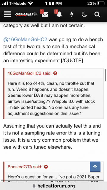

@16GoManGoHC2 was going to do a bench test of the two rails to see if a mechanical difference could be determined but it's been an interesting experiment.
Assuming that you can actually feel this and it is not a sampling rate error this is a tuning issue. It is a very common problem that we see with cars tuned elsewhere.
3. If your tuner is reputable with this platform he will be busy. It is not unusual for me to be 2-3 weeks behind in responding with revisions. I start email tuning revisions first thing in the morning and limit my time to 3 hours. I then go to the shop and tune cars on the dyno the remainder of the day. I leave the evenings and weekends for work around the house and family. I always list my expected response times in my email signature for my customers but that is all I can offer.[/QUOTE]
RE verse HC fuel rail pressure verse output voltage test comparison still on my to do list. Ported RE rails do do better with more equal trims bank 1 to Bank 2 then ported HC rails do. Both do better with porting then stock but RE rails really see good results especially on the Drivers side rail. Had a recent customer chasing a fuel issue send me his rails and he gained 15% inj duty cycle back from porting his rails.

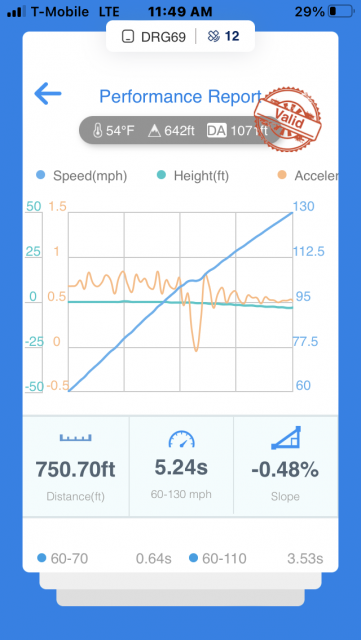

On the Yes, can actually feel it, see it on HP T log, and see it on Draggy runs even between the 3-4 shift and at the top of 4th cuts right around the 130 mark.
901AB55C-3807-49A5-BAB5-922423F7457A.jpeg 2C6A2165-F3A7-463F-8897-CC5B9B70F633.jpeg B0EE19BA-8489-48F7-8024-3640DF31F9C1.png
Here it is fixed by @jonx96 , gained me a 1/2 second on my 60-130 times. Took care of it within an hour of contacting him. I don’t know how people can wait 2-3 weeks for a reply or revision, summer would be over by the time one is tuned.
New Personal Best 60-130!!
THANKS @jonx96 your #1

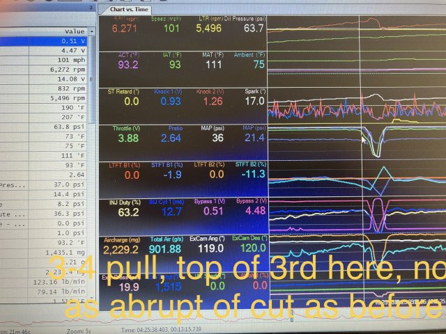

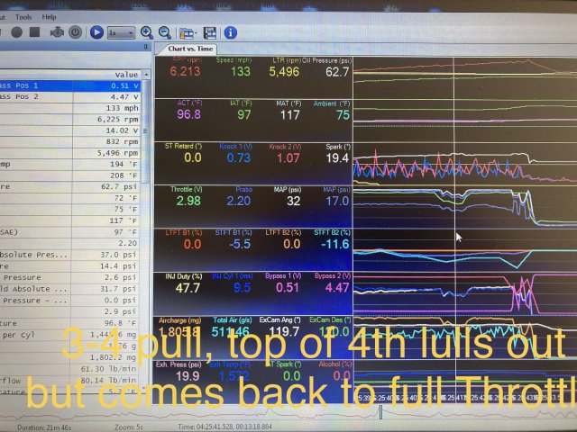

2FF528D7-9AED-490C-8AC2-60A056F4262B.png 3549290F-FAE1-4E53-BE64-0666FF9B723A.png
Clean at the shift now!! Making some steam even at low timing, she’s got more in her for sure!! THANKS JON!

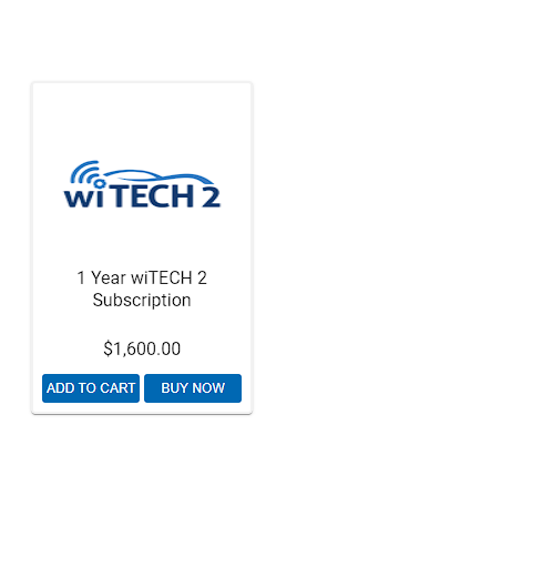

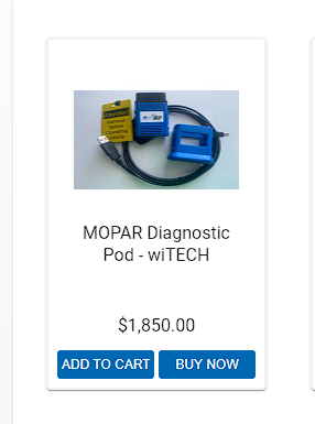

2. I am debating about buying a witech. I really do not do a ton of installs I mostly do remote but it would be nice to have. The dealer seems to have very limited capabilities with theirs.
Assuming this is what I am looking for is these two items?

Mike I have 2 questions for you
1. The part number on the valve body and tcm seems to be the same. On my personal redeye I put a different trans in. I didn't swap Valve bodies. Well the trans was out of a 21 hellcat. I was having a few weird issues so I brought it to my dealer to flash it. So they did. They said it pulled down my vin but when I got home I still saw the soul of a hellcat and not a redeye config in the tcm. Do you know how the witech detects which config to load in?
View attachment 106669 View attachment 106670
They can flash it to the most recent OS based on vin, that’s it. I had a buddy at the dealer came to my house to flash my TCM, since it’s out of a 16 charger. He couldn’t even change the vin on it, just flash it to the most recent OS based on the vin it was showing
