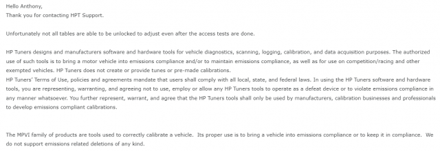

I sent a support request to HP Tuners and letting them known that the table is read only. Hopefully they can fix that.

You have got to be fucking kidding me:
But yet I can turn off DTCs... is this a fucking joke?
1,599
3,985
welcome to woke :mad:
7,613
19,948
Tell em' it's a race car. Now you see why I never upgraded.
4,137
10,416
unfortunately if your tuner writes a tune in a newer version some older versions may not allow the file to open
