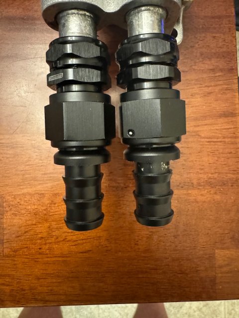

They barely fit. If the AN nut is at the right angle they hit 😂
8,733
7,666
That’s close, but hey - fitting is fitting

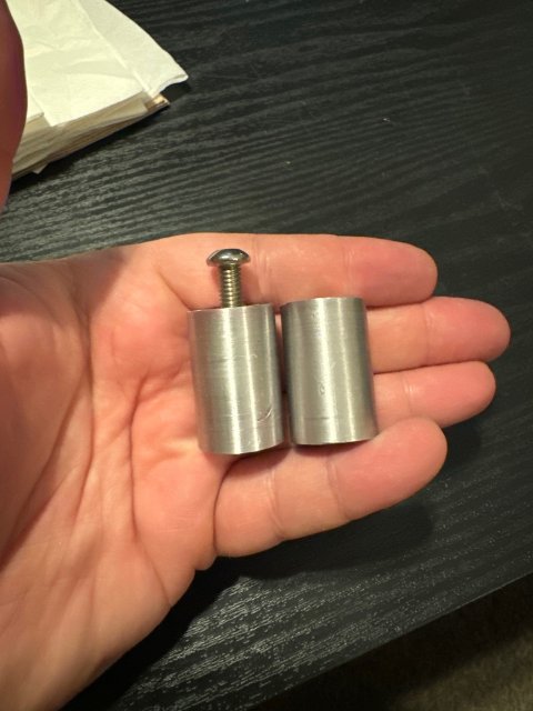

If this short gets 10k views Ill buy a lathe and mass produce these. Plugs for your water pump on the 6.2. Installation video soon.
On a dedicated race car the heater core lines are not needed, also a source of heat underneath the supercharger.

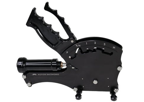

With the 400 you’ll be launching off a transbrake. With the 2-step you can set that to whatever the track condition calls for. Make sure you check out the Motion Raceworks shifter. We’ve had four different shifters (B&M, M&M, Precision, and MR). The MR is the best. The Precision is crap by comparison. I have the M&M in mine and it is nice but if I was starting from scratch it would be the MR.
4,127
10,379
Thread Starter #210
100% agree this is what I ordered.
Right now im overwhelmed, trying to get a flexplate to work with th400 convertors and not need some machines or weird spacer for the convertor pilot for the crank. Then get a convertor for the stall speed I want. Then I need to finish the rear cradle, get brakes, driveshaft… 🤪
this is what i signed up for so no complaining. 😂
3,633
11,720
That’s the one you want (as long as you’ve got the clean neutral valve body). Motion Raceworks is a good place to do business with. And they give you a lollipop with every purchase 🤗

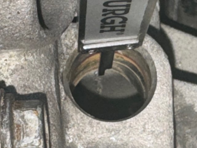

The pilot bearing/bushing isn’t a big deal. I shaved down a harbor freight slide hammer attachment to get my m6 one out
8,733
7,666
But definitely need a different one
4,127
10,379
Thread Starter #219
Huh? I’m talking about the pilot on the back of the converter that sits in hole in the crank. No bearing needed.
