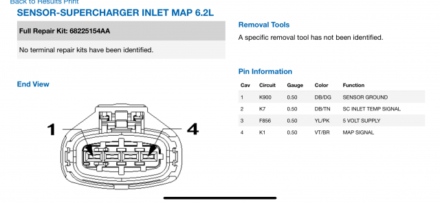

So some technical things. The hellcat map sensor is really a TMAP sensor. It does temperature and pressure.
The Gen 3 harness is made for 5.7/6.4 units and includes a 3 pin map sensor and 2 pin MAT sensor. There are two ways of doing this.
option 1
De-pin the Holley map sensor harness pigtail and use a mopar connector using the following reference guide:
Pins 1/3/4 would be re-used.
In regards to MAT, the Holley harness is a ground and an input. Theoretically this could map to pins 1/2. The blower port lid sensor would be used for temperature. The back of the blower port for manifold pressure. Custom sensor data would be needed.
option 2
Buy an AAD reference port block use the outside sensor for temperature. Drill/tap the reference port to 1/8 27-npt and use holley 3.5 bar map sensor. Select it in the drop down and be done.
I’m leaning towards option 2. I like plug n’ play. I have one on my car but cant remember the reference port thread pitch/size, might email AAD to see if they can do me a one off.

Option 3
De-pin both. Put MAT sensor pin and map pin on one tmap sensor.
In any instance block off ports will be needed. Easy day on those
