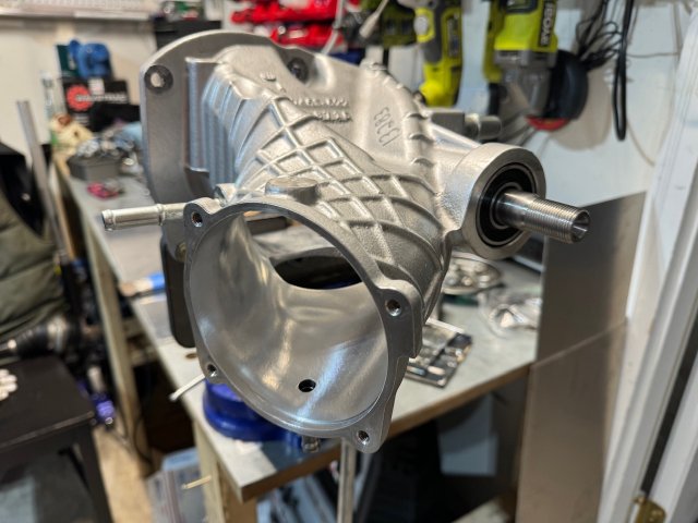

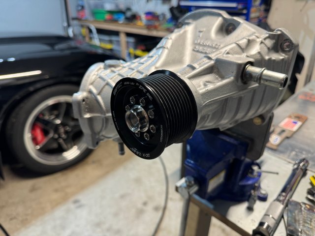

My custom 10” screen for the Holley is inbound. Steering wheel, hub and adapter have arrived. Just finished putting the final touches on the snout. Just an fyi the tba machining plate for diffs also doubles as a snout assembly plate 😂

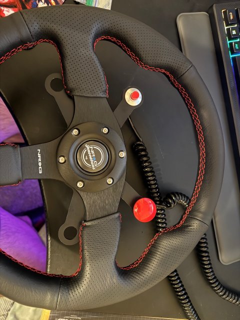

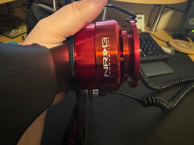

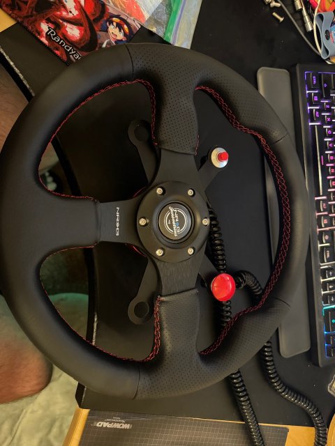

assembled my steering wheel.
nrg supports mopars so i support them :)
button holder and buttons are from jegs.
Top left - bump
Top right - trans brake
bottom buttons are hard to reach on purpose. Bottom left will be line lock. Dont want to hit that while racing 😂
8,735
7,667
3,633
11,720

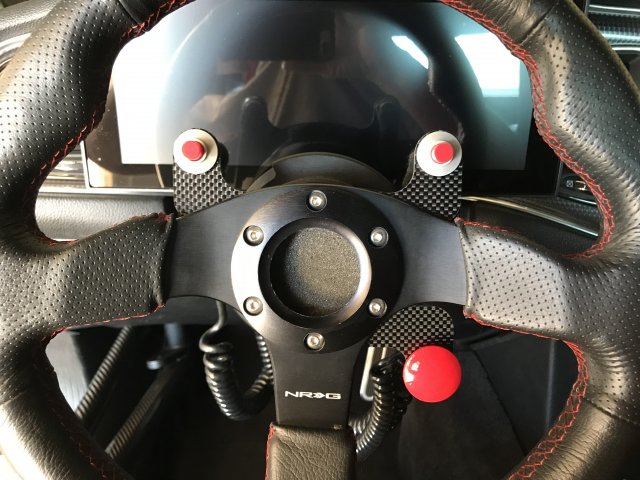

Nice!! I like mine. A word on buttons. The one you do not want to activate going down track is the transbrake. It engages reverse. The linelock only holds pressure in the front brake lines as long as the button is held down. A momentary hit of that button won’t do anything. Setup the ECU to lock out reverse in 2nd and 3rd gears so the transbrake can only be activated in 1st. Motion Raceworks sells a gear position sensor that can be used for that purpose. Safety device in my opinion. I will be installing one in my car coming up. My chute (air launch) is out of the way and big and fat so I can find it, but I have to move my hand to get to it so no accidental launch in the pits. Before I changed to this layout, I did that and everybody had a good laugh 😂 I have my line lock for doing the burnout on my shifter. Always start you burnout in second and shift to third to get wheel speed. 😎 IMG_5390.jpeg IMG_5354.jpeg

Nice!! I like mine. A word on buttons. The one you do not want to activate going down track is the transbrake. It engages reverse. The linelock only holds pressure in the front brake lines as long as the button is held down. A momentary hit of that button won’t do anything. Setup the ECU to lock out reverse in 2nd and 3rd gears so the transbrake can only be activated in 1st. Motion Raceworks sells a gear position sensor that can be used for that purpose. Safety device in my opinion. I will be installing one in my car coming up. My chute (air launch) is out of the way and big and fat so I can find it, but I have to move my hand to get to it so no accidental launch in the pits. Before I changed to this layout, I did that and everybody had a good laugh 😂 I have my line lock for doing the burnout on my shifter. Always start you burnout in second and shift to third to get wheel speed. 😎 View attachment 129402 View attachment 129403
I already have that part in my stash waiting to go on. Great minds think alike.
https://motionraceworks.com/products/operator-shift-position-sensor-kit-16-146

Curious @fumanchu182, I should be able to use a steering wheel button for the STAGE6 2step. Been waiting for someone to sell one with the harness cheap. Haven’t seen any for sale recently
4,129
10,396
Thread Starter #293
I have one for sale with harness. Fair price. For sale not on sale 😂
4,129
10,396
Thread Starter #294
If you use a ground trigger yes, however two steps should never be activated without a brake switch. My steering wheel button commands transbrake AND two step.
