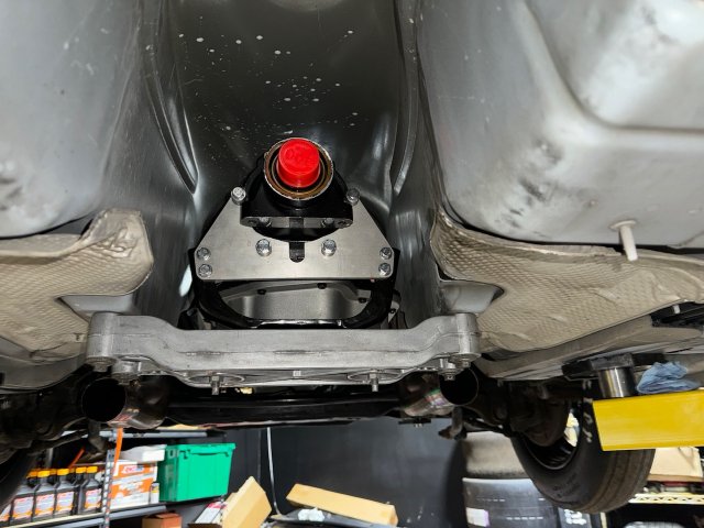

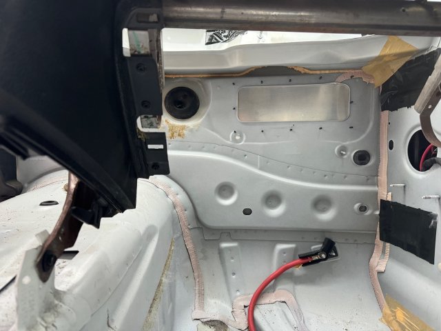

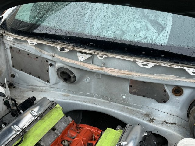

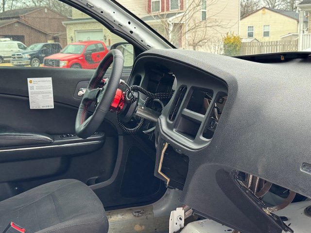

did what I could this weekend and I am super pleased with the wheel and how the plates for the firewall came out. They will be removed soon and painted. Also waiting for panel bond. It is quite expensive or if anyone knows a fireproof RTV please let me know.

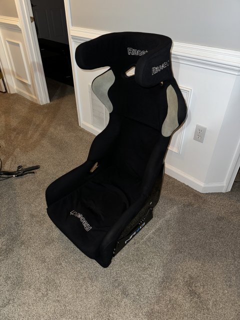

picked up this seat and got the brackets separate, not a fan of the brackets and will call Racetech on Monday for the brackets and the back support.

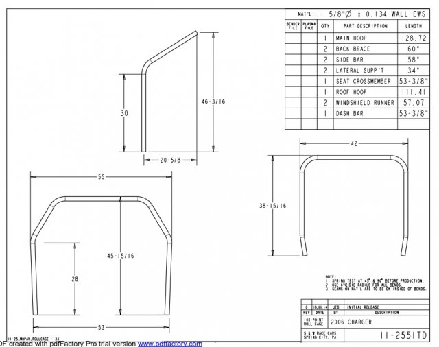

Thank you @Linda's Hell Cat I'm working through many people to secure a cage. RPM is a lot of weeks out and local builders are price gouging and or are busy. Maryland unfortunately since it has three tracks, has thrice as many doo doo heads in the area looking to give the whole field a bad name.

Look at s&w race cars. You should be able to pick it up and have someone weld it in.
4,104
10,286
Thread Starter #333
I've already spoken with them, Lee is a great guy to speak with. Three local fab shops refused to use their kit. Guess they don't understand I know what metal costs... Like I said it's a shit show, I may just do it my god damn self at this point.
S&W even sent me detailed dimension to send to those shops, they never replied back.
I just don't have a notcher nor do I trust myself with MIG.

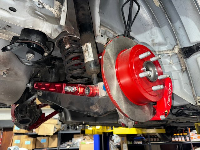

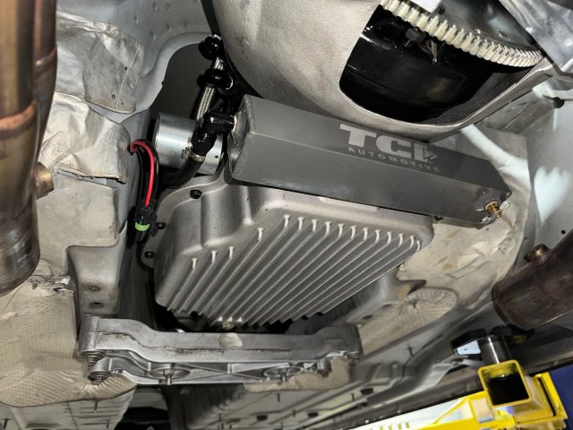

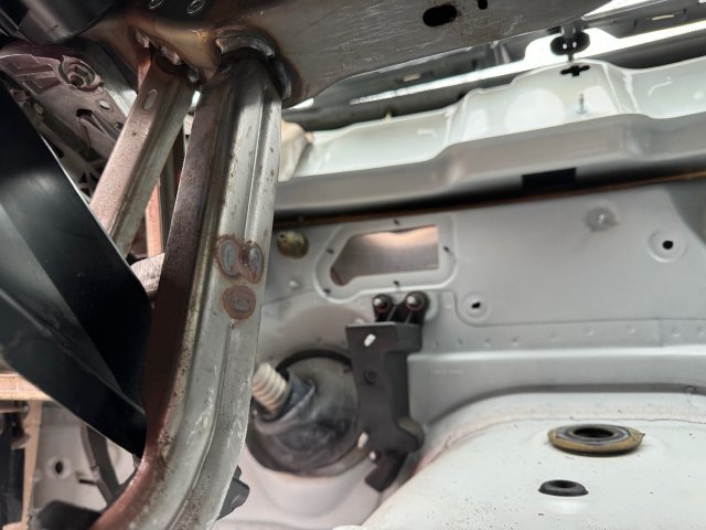

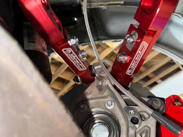

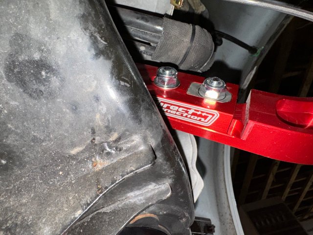

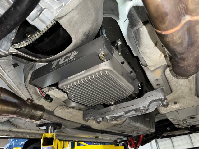

IMG_1999.jpeg IMG_1998.jpeg IMG_1997.jpeg IMG_1995.jpeg IMG_1996.jpeg IMG_1994.jpeg IMG_1993.jpeg IMG_1991.jpeg IMG_1990.jpeg IMG_1989.jpeg

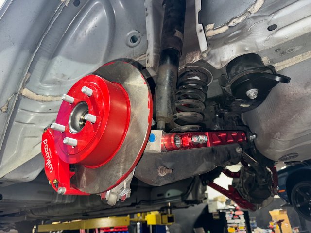

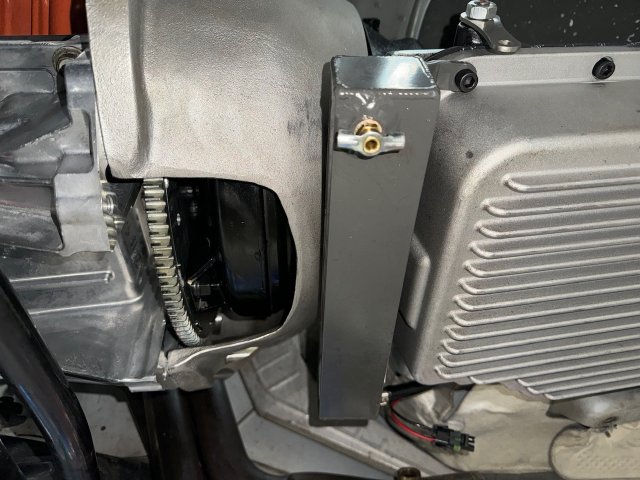

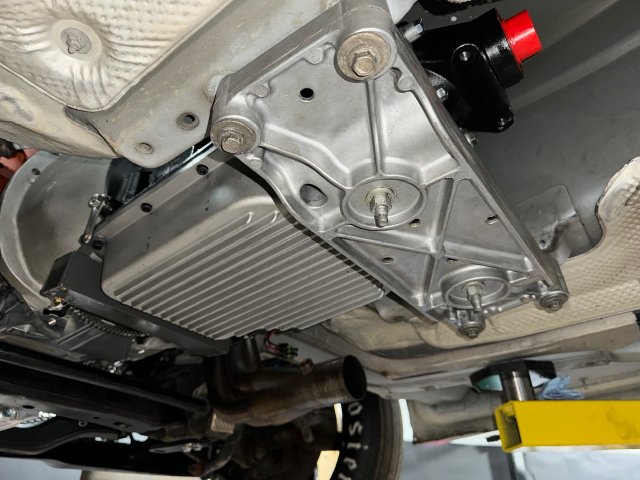

the rear suspension was partially completed. Awaiting menscers and deciding on what diff/axle combo i want to run. Turbo 400 went in smooth.

$.02……. I will always say to go with a pro built cage. Passing tech is one thing. Real protection is another. I would advise, if going with a 8.5 cert, have it built to a pre 7.5 level. That way if your car ends up pushing below 8.5 you can add on and up-cert it. The bare minimum 8.5 when it comes to tubing requirements and such can not simply be added onto. It would have to be removed and started over.

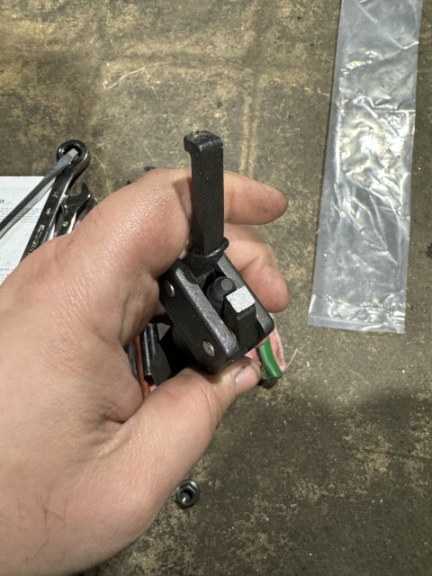

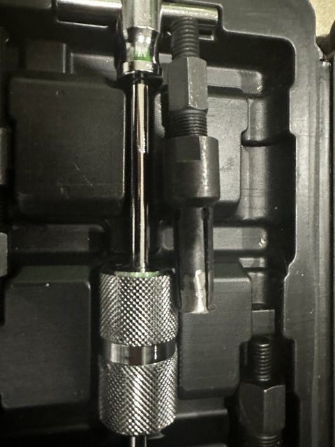

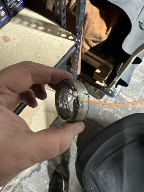

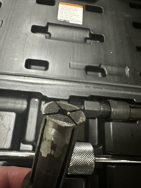

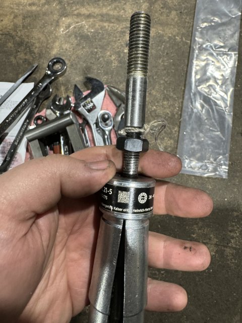

100% agree. In the meantime, anyone removing a pilot bushing from a 2015 motor good luck.
Tool 1 broke:
tool 2 broke:
At this point madder than a hornets nest it met an timely death with the carbide burr
8,586
7,553
Tool 1 broke:
tool 2 broke:
I showed you what I made to get mine out. It was horrible. I grinded down a slide hammer attachment from harbor freight after someone told me I needed to cut it out. Bread and soap trick didn’t work
Must of used white bread. Sourdough or multi grain are the best choices.
8,586
7,553
Just had to make it thinner on bench grinder
