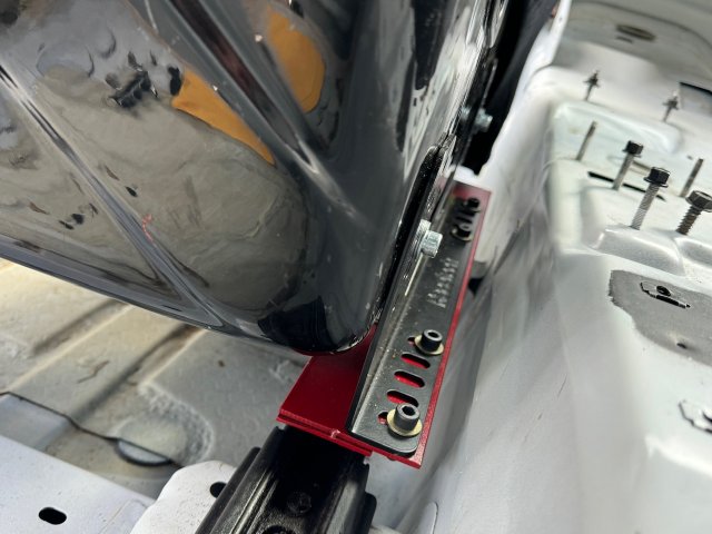

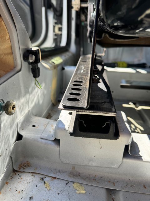

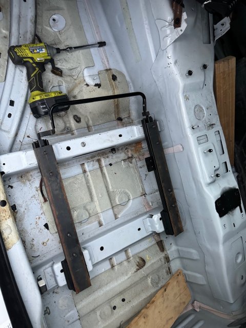

Started with 2”x18”x1/8” steel drilled to fit on the stock sliders.
as you can see the brackets overhang a lot, on the shelf added a 3”x18”x1/8” overhang for them to bolt to.
doing a test for height, had to lower the seat as I dont know where the bars will land yet, also helps me figure out placement of the th400 shifter finally
have to run the vacuum again. Todo: remove seat final time. Do final welds of the bars together. Paint them and final assembly.

It’s possible that a strict NHRA tech might have an issue with using a slider on a race seat. One of the things I have actually had them check is the required brace connecting the back of the seat to the roll cage. That will make the seat fixed. I can only find one picture where you can see it with my Kirkey. IMG_4951.jpeg

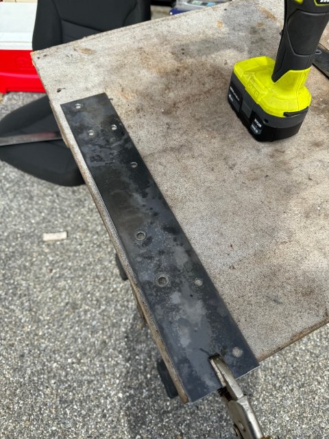

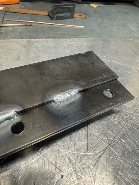

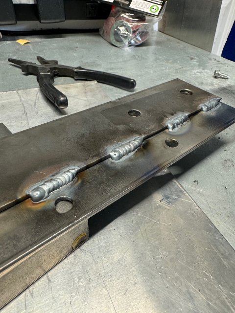

Finished products! Didnt weld the front a d back edges as there are also welds on the backside and the lap joints.

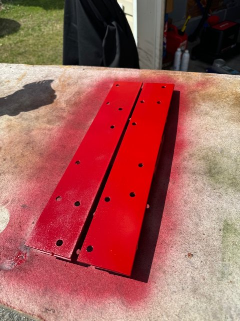

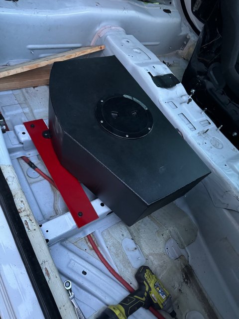

I may have had too much fun with the red paint this weekend.

Looking good! Overkill for a cage, I bet you could weld one up and get it carted no problem

Had a chance to get this all welded up and in the car. It ain’t easy. Had my weld settings all wrong and was struggling till I looked at the damn machine after getting cold welds. Had to redo them all… 🥲

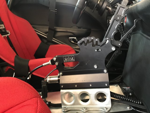

Good job on learning to do stuff yourself 👍🏼. I welded full time for eight years to pay the bills when I was first on my own. We make these… IMG_4961.jpeg
